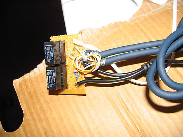

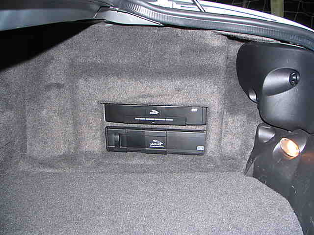

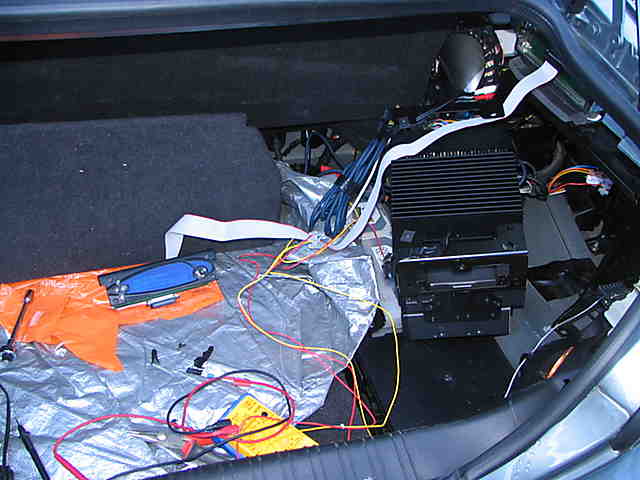

I couldn't find anything similar in the UK so after some digging I remembered about latching relays so I've decided to either go down that route or just use the remote-amp-on wire with a vanilla relay to select the audio source - simple really (and to be honest, probably the kind of approach/idea I was after).
I finally got round to removing the OEM kit from the boot/trunk today and I have Empeg sound coming from the speakers - good start \:\)
The next thing I need to do is actually mount the display extender itself. Has anyone else done this yet?

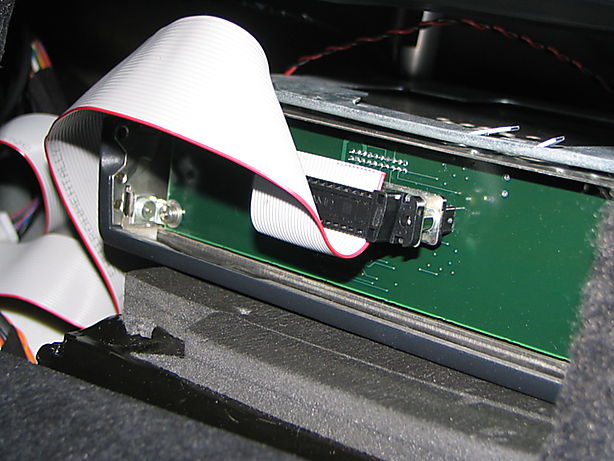

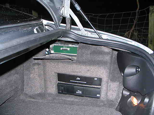

Well, here's the install in the boot:
There is an empeg there... see:
And there was some install work too:
No display yet smile

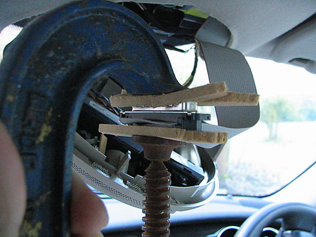

So the ribbon cable is now installed and the end pieces need crimping on.
Is this easy? It looks like the crimps just need a straight clamping force. Would I get away with just aligning the ribbon and using a G-clamp?
#306979 - 06/02/2008 23:02 Re: Display extender install - 1st steps... [Re: LittleBlueThing]
Posts: 1956
Or a vice is better... If you use a G clamp, use some pieces of wood or similar to spread the force all the way across the connector. If you try and clamp one end or the middle, you'll break it.

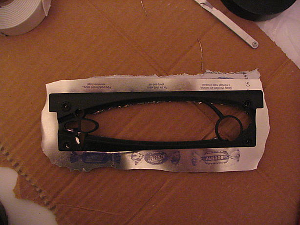

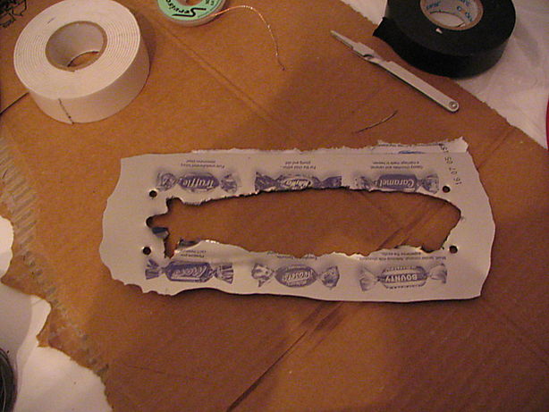

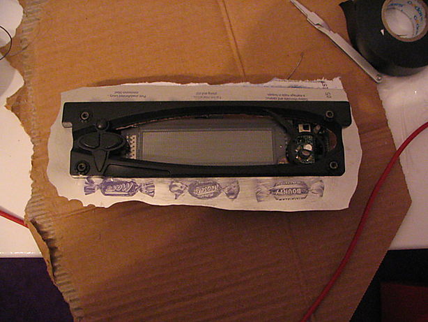

Description: These relays switch between Empeg and CD when the Empeg is powered.

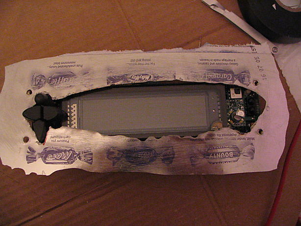

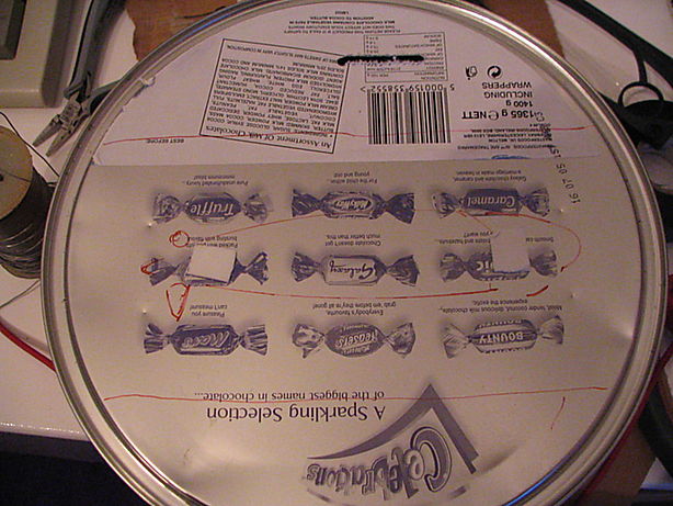

Description: I needed some thin steel for a bracket...
Description: So mark it out
#307084 - 09/02/2008 14:36 Re: Display extender - DONE! [Re: LittleBlueThing]
Posts: 610
It needed a bracket to mount it...
Description: and then hack...
Description: make sure it looks OK
Description: and doesn't foul the buttons

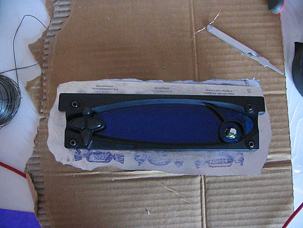

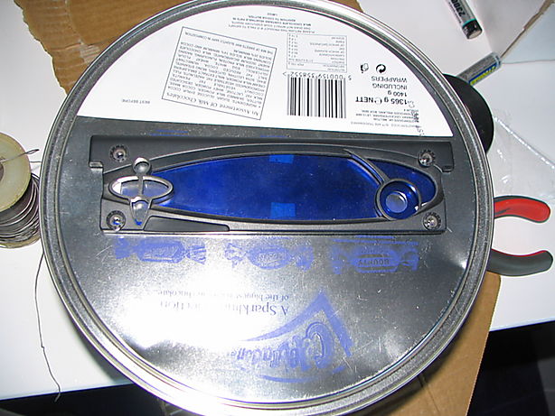

#307085 - 09/02/2008 14:38 Re: Display extender - DONE! [Re: LittleBlueThing]
Posts: 610
so here's one I made last night,
Description: test assemble
Description: some nibbling later and then with filter
#307087 - 09/02/2008 14:40 Re: Display extender - DONE! [Re: LittleBlueThing]
Posts: 610

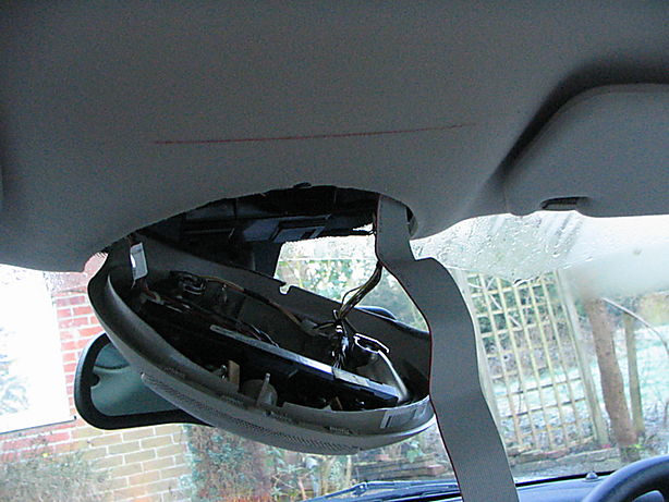

This morning I walked outside with a Stanley knife in my hands to cut this...
I swear my hands were trembling.
Description: The victim - little does she know...
Description: That's the spot...
Description: That was permanent marker pen.

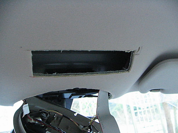

#307088 - 09/02/2008 14:42 Re: Display extender - DONE! [Re: LittleBlueThing]
Posts: 610

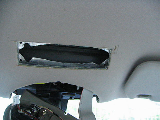

Getting down to it
Description: I did ask if a G-clamp would work. It did!
Description: Thank god there *was* room behind there after all.
Description: Hmm, not quite right

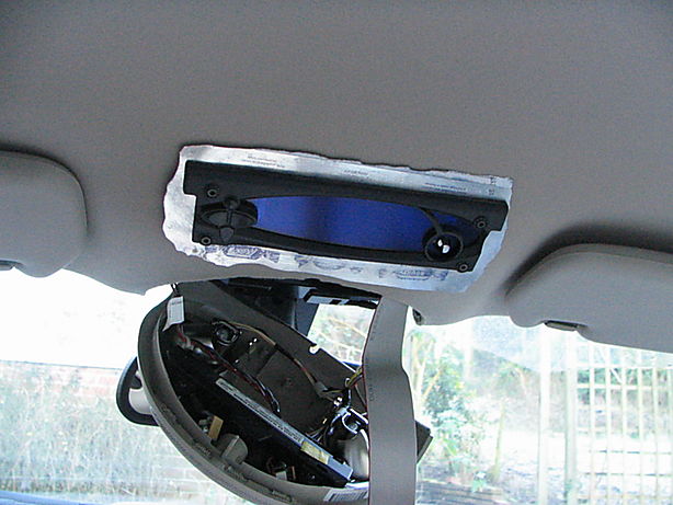

#307089 - 09/02/2008 14:44 Re: Display extender - DONE! [Re: LittleBlueThing]
Posts: 610
That's better
Description: The bracket goes in the hole.
Description: boot cable is attached.
Description: AND WE HAVE EMPEG GOODNESS!!!

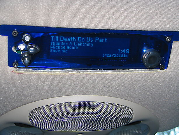

#307090 - 09/02/2008 14:48 Re: Display extender - DONE! [Re: LittleBlueThing]
Posts: 610
I swear the Empeg was set on random play. However I think I'll call this the "married bliss playlist"...
Description: Those tags need to go - but it could look quite good like this... if the buttons didn't keep falling off. At this point we had to drive 30 miles to get the headlamp replaced - good test - and Denise caught the buttons every time we went over a bump :)
Description: when we got home I was actually thinking at this point that I might NOT have made a dreadful mistake :D
Description: So the trimmed filter fits in well

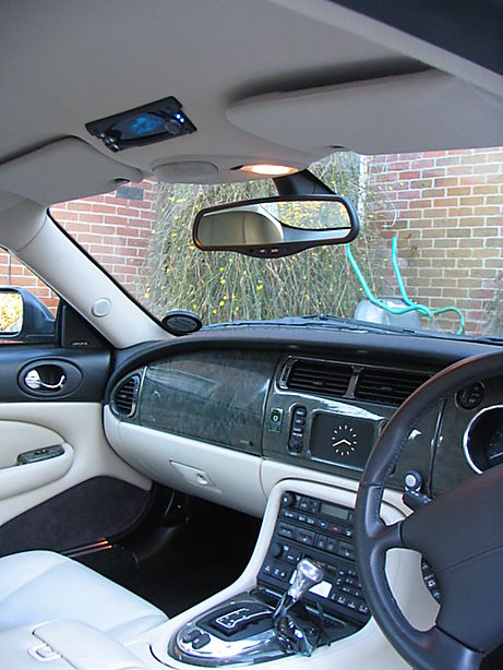

#307091 - 09/02/2008 14:50 Re: Display extender - DONE! [Re: LittleBlueThing]
Posts: 610

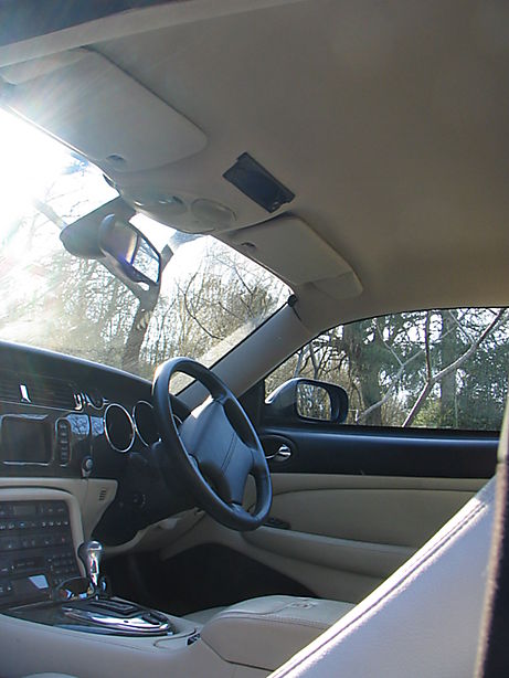

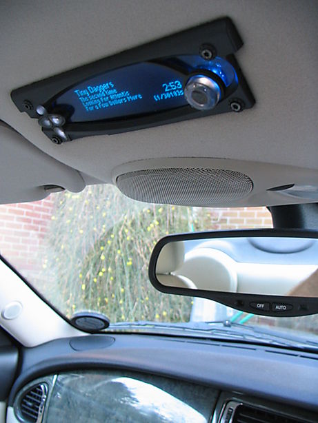

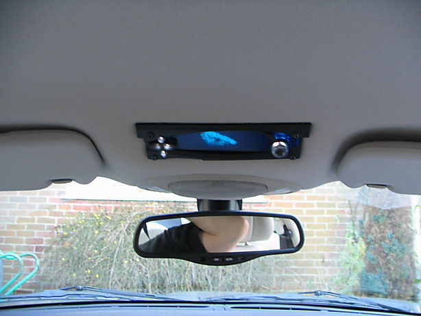

and finally - it was done...
Description: From the passenger side, powered off.
Description: Head on
Description: and a close up. It really does look quite neat :)
#307092 - 09/02/2008 14:53 Re: Display extender - DONE! [Re: LittleBlueThing]
Posts: 610

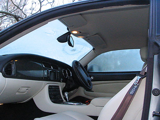

A *final* shot from the drivers side.
I'm really pleased with it - all the OEM sound works perfectly of course; the empeg is just spliced into the AI-Net for the OEM Alpine head unit/amp.
Sound quality is OK but not mind blowing. I think I'll look at replacing the speakers next...
Mainly we're delighted to have the Empeg back again smile
Description: In context

#307105 - 09/02/2008 21:16 Re: Display extender - DONE! [Re: LittleBlueThing]
Posts: 13874
Looks great!
How is it at night?
(Handy thing, that dimmer feature)
Edited by mlord (09/02/2008 21:17)

Just with the crimp connector: there should have been 3 parts to it. The third is a strain relief. You double back the cable and clip it on. Not explicitly necessary and in this situation probably OK to go without it since there shouldn't be anything tugging on the cable. Just an FYI.
Nice install. I must admit I thought that the first few images with permanent marker and the hole looked a bit rough and ready. End result is nice though. How is it to keep having to look up?
#307119 - 10/02/2008 06:07 Re: Display extender - DONE! [Re: Shonky]
Posts: 889
Scary!
But it looks so nice up there, good job with that. Love the fact that you can prod the buttons on the headlining, the action just instantly makes me think of a aircraft pilot.
Just brilliant. Well done!
#307124 - 10/02/2008 13:14 Re: Display extender - DONE! [Re: frog51]
Posts: 610
I thought they got rid of the J-gate shifter.
Eventually - this was probably the very last model to have them. The next year's XK/R was the new shape.
Looks great!
How is it at night?
Thanks...
Found out last night - it's *BRIGHT*.
It's high enough not to distract though.
I hadn't originally planned on wiring up the dimmer sensor - I will though.
Originally Posted By: frog51
Wow - I'd have been nervous cutting that too. You must be very happy it all worked and came out looking excellent.
Oh yes - I was really worried it'd look rough. Especially the shape without the handle. It looks nice though - I think that because we know the handle should be there it looks a touch odd - but I'll ask people who have no idea why it's T-shaped and see what they think.
Don't recall seeing a strain relief in the box/bag or on the short 'just so I know it works' run provided - the boot end comes on and off when the unit comes in and although it has lots of slack it may benefit. The main unit has no strain at all.
I tidied the edges and the hole up before finishing - the headlining is actually thin fibreglass sheet, 2mm brittle foam, another thin fibreglass sheet, 1mm soft foam and then the fluffy liner. I had to trim the fg sheets a few mm in from the fluffy liner to allow extra material for the edge. Then I dug out the static foam for a few mm to allow the headlining to compress nicely. I already had plenty of photos and I doubt anyone else is nuts enough to install a display extender in the exact same car so you didn't see that bit smile
Looking up is odd - but OTOH I won't be having glare issues!
Originally Posted By: sein
Scary!
Cheers mate smile
It does indeed feel very aircraft like - and you (or the passenger) needs a steady hand to press the buttons on the move.
It's very solid though.You need to come for a quick flight to see for yourself wink

That install is purely surreal! Who would ever imagine an empeg sticking out of the roof! Great pictures.
So, you ran the display cable from the boot in the headliner??
FireFox31
#307339 - 16/02/2008 20:03 Re: Display extender - DONE! [Re: FireFox31]
Posts: 610
Thanks - it is different. All the work everyone put into those extenders - it's just great.
Yes - we'd just got a rather large bill for new tyres and a new headlamp glass so the garage ran the cable for free whilst it was in there. I was looking forward to doing it myself but the headlining is easy to damage apparently so I took the freebie wink
