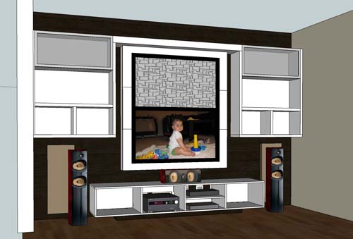

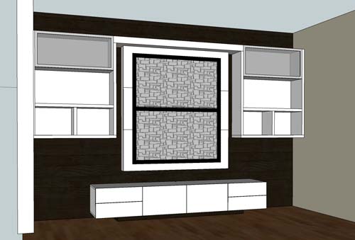

This is the design so far for the wall unit - the middle section will house the motorized panel. The ceiling height is 9ft and the width of the wall where the unit is mounted is about 12.5ft. Each of the patterned areas on the center unit is 55" diagonal.
No wires or components will be visible. Components are housed in the base unit behind doors and all control is handled through repeated/distributed IR, with a single sensor mounted under the framed area in the center of the panel - very discrete surface mount unit.
I was originally going to make the artwork roll up and around the roller tube. What I'll do instead of mount the art on a rigid backing (1/8" hardboard) and that will be lifted by the roller which will be mounted at the top of the large center panel. Only the support lines will actually roll around the roller tube this way. The main factor here was to make sure the artwork has enough mass to move smoothly down in front of the TV and to make sure it's always flat (can't get bunched up or develop a curve due to being on the roller too often).
The motor can lift over 8lbs with the 1.5" diameter tubing I'll be using. The artwork will way considerably less than that, even once mounted on the hardboard. To make sure it's under weight, I'm putting holes in the hardboard backing.
The part that will actually move up/down is the bottom panel inside that dual framed area. The pattern represents where the custom artwork will be visible. Still haven't decided what the imagery will be nor if the top and bottom will form one larger image or simply be complimentary, but both will be printed on the same type of canvas.

Looks good, but if you're planning to put all components in the base unit, will you get enough cooling for them? Normally, components don't like too confined spaces.
Stig
#331546 - 29/03/2010 12:17 Re: Motorized cover/screen/art to hide flat screen TV - DIY? [Re: StigOE]
Not all components will go in the base unit. The biggest heat generating one, the power amp, will be in the basement roughly below the left wall you see in the image. That's where my equipment rack is which also contains the computer and NAS that serve and record my media/TV. The computer/server is the next biggest heat generator as well as noise maker, so it's been in the basement all along.
The base unit will only contain a pre-amp in the left cupboard and in the right cupboard the IR distribution block, the SageTV HD Theater (extender), a Wii and probably a DVDO Edge video scaler. I've got vents cut into the bottom and back of the base unit as well - the doors on the front will also sit about 1/8" from the front of the unit. Not a ton of ventilation, but it should be OK for the components that will be housed in there. The unit is 15" tall and 20" deep with each compartment being 24" wide. Lots of room. The side with the pre-amp has only a half back and the wall behind it will actually be recessed an additional few inches to make extra room for the XLR connectors that go down to the basement through the wall.

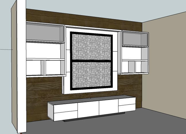

It's been a little slow going, mostly in the time leading up to starting the work. Right now I've got all the wooden panels up on the wall (the brown background) and I've got all the hollow components made for constructing the shelving units.
The paneled background was made with 3/8" fir plywood which I ripped to 6.25" and then stained in an espresso/chocolate finish (dark brown). It has just the right balance of visible grain and matches amazingly well with my sectional. The staining took one day and then another two days were spent on two coats of clear satin finish. It came out fairly well, but given the instability of 3/8" ply, I'm not sure it's something I would do again. It would cost a lot more to use something like pre-finished flooring, but the results would be better and make it a lot easier to work with the material. I had a lot of struggles getting the planks to fit together on the wall due to slight warpage/shrinkage/expansion in various dimensions. The panels are held primarily by construction adhesive and tacked with brad nails to studs. That said, it does look very nice on the wall - it was just a shit-load of work. wink
To get the shelving unit constructed with 1.5" thickness all around, I've made some hollow components instead of actually using 1.5" thick material. This saves a ton of weight, which is super important, considering even the hollow panels are quite heavy overall. They're constructed (faced) with 1/4" MDF with edge and internal ribs made of 3/4" MDF ripped to 1" width. Everything is glued and tacked together using brad nails - the pneumatic nailer was a lifesaver (especially for the wall paneling).
This was all done over the past two weeks. It took me a day and a half to get the paneling on the wall - longer than I expected, but mostly due to the issues I had with panel deformation, plus the many cut-outs I had to make.
Next week, I'm finally getting my biscuit joiner, so I should be able to finish the shelving units and start on the base cabinet. Over the next two weeks I also have to go interview (and get quotes from) two painters I've gotten recommendations for to decide who will be finishing this stuff.
We're also pretty sure we know what kind of artwork we want, so now I just have to produce it - unless I can find something pre-designed in the next three weeks. smile Funnily enough, I got the inspiration for the artwork from "Mother's" office in the animated series Archer. Basically an abstract water color/staining on canvas. I'll produce a few more complimentary pieces which will be used as art elsewhere in the room. This other art will actually be insulated acoustic treatments to cut down on sound reflections and hopefully dramatically improve the sound in the room.
Some updated Sketchup designs. You can see how the components will fit in place. I've also made some small adjustments to various dimensions, including the width of the center panel that covers the TV.

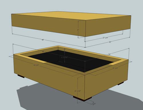

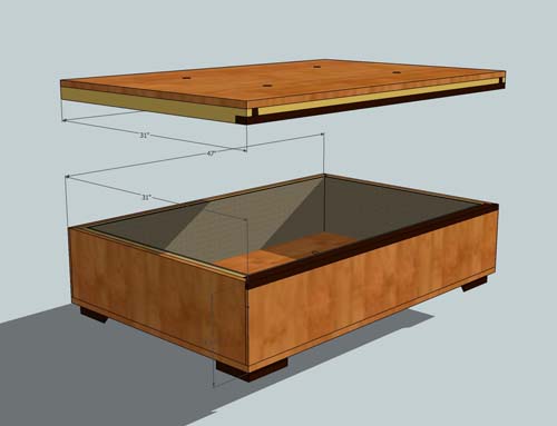

Yesterday I started on another project for that room and finished it the same afternoon. A storage ottoman. Built the underlying frame which I'm going to have professionally upholstered to compliment my sectional. I've also luckily found suitable gas springs to hold up the heavy top, so it should all go together well. It's going to cost as much as a high quality store-bought ottoman, but I was never able to find anything with the specs I wanted on the market.
The parts of the ottoman that sill take screws (for the hinges) are built up with solid oak so as to firmly hold the screw. There's going to be a lot of torque on the hinges with the heavy top and relatively stiff gas springs. The feet are solid beech which I actually still have to buy (mail-order turns out to be the easiest/cheapest option).
Getting there...

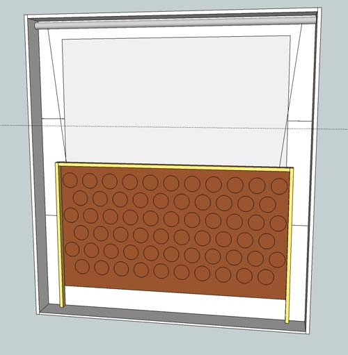

#332658 - 01/05/2010 14:48 Re: Motorized cover/screen/art to hide flat screen TV - DIY? [Re: hybrid8]
Here's a detail, from the back, of the panel that moves up and down revealing the TV. The frame around the panel keeps it square/flat and also prevents it from moving horizontally, even when it's positioned above the TV. The bottom edge of the panel will always be in front of the top bezel of the TV, ensuring that it comes down in front of the TV and not on top of it, getting stuck.
The panel is attached to the roller via high-strength woven cord that's set at a slight angle. This will allow the cord to roll around the roller without rolling onto itself. There will probably be only a single cord that goes from one end of the roller, comes down into the panel frame and then back up to the other end of the roller. This should make it easier to set the panel level without having to keep playing with cord length.
