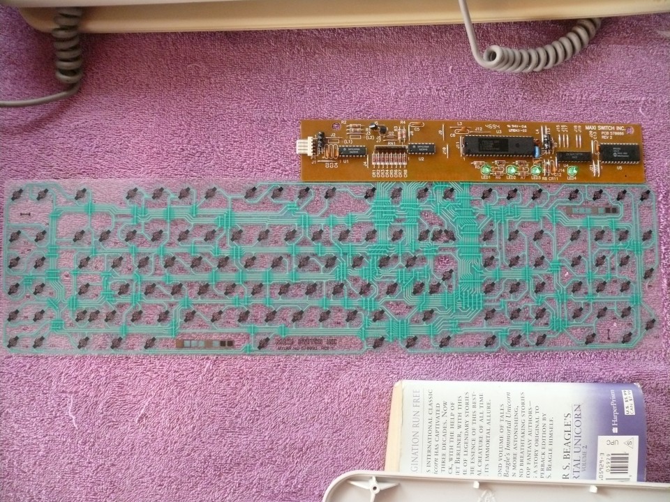

Mmm... can you photograph the electronics bits in more detail and more sharp focus?
Thanks

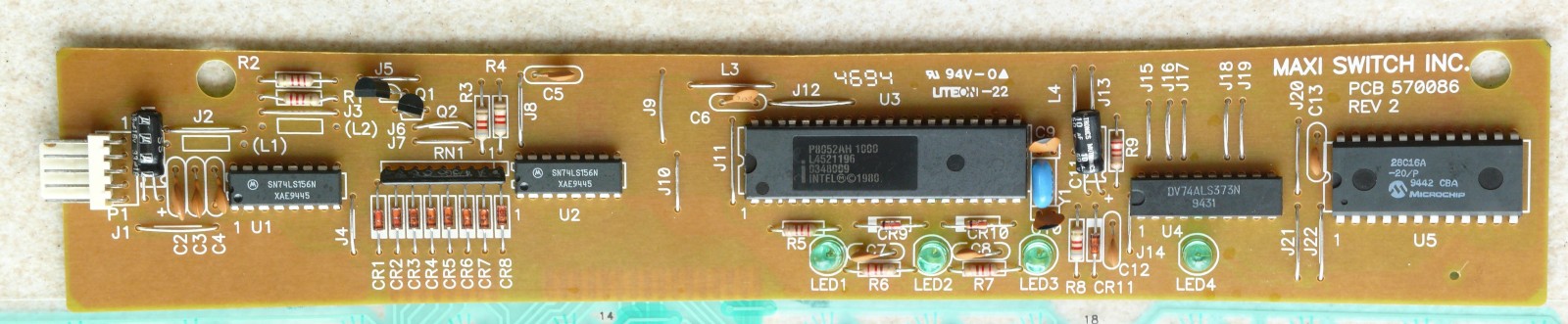

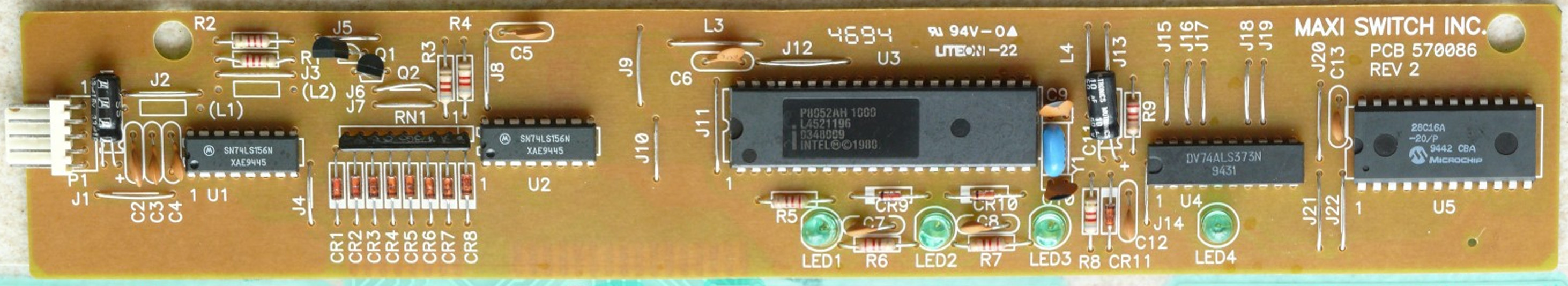

Yes. Attached is a low-res picture to give you the idea; I have emailed the high-res version to you directly.

#346444 - 15/07/2011 15:32 Re: WTB: Gateway 2000 AnyKey keyboard [Re: tanstaafl.]
Posts: 14477
Nice barrel distortion there. smile
emails sent.
It's an artifact produced by the stitching program -- it's actually three shots joined together. Don't know exactly what caused it, haven't had that happen before.
#346455 - 16/07/2011 02:41 Re: WTB: Gateway 2000 AnyKey keyboard [Re: tanstaafl.]
RobotCaleb
Here's a couple of minutes with Hugin.
#346480 - 18/07/2011 16:37 Re: WTB: Gateway 2000 AnyKey keyboard [Re: RobotCaleb]
julf
Registered: 01/10/2001
Posts: 1307
Ah. good old Pertinax (resin bonded paper). smile

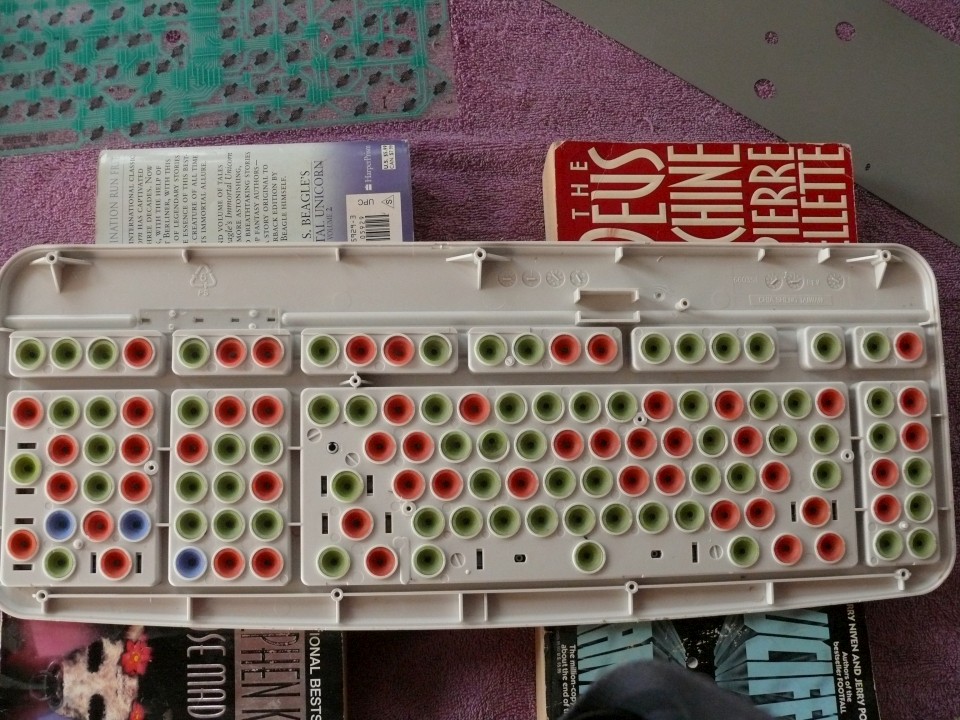

I have a spare AnyKey on hand, but it had been stored for the past several years in non-optimal conditions (temperatures reaching 125 degrees (F) or more on occasion) and when I brought it out, about half the keys wouldn't register any input
Now this is interesting... from a Wikipedia article:
The 2189014-00-211 Gateway AnyKey model contains a toroid on the inside, around the keyboard wires near the top middle of the keyboard, which might rub against the plastic membrane circuit board and cut the leftmost trace emerging from the left ribbon connector.
My spare keyboard is not the ...-211 model, but does have the toroid, so it got me to looking. I wonder if a thin strip of foil across that break would fix it? I am at a loss as to how to disassemble the keyboard to actually get at the mylar sheet with the tracings on it, but that one little spot is semi-accessible without taking it any further apart. Worth a try, I suppose.

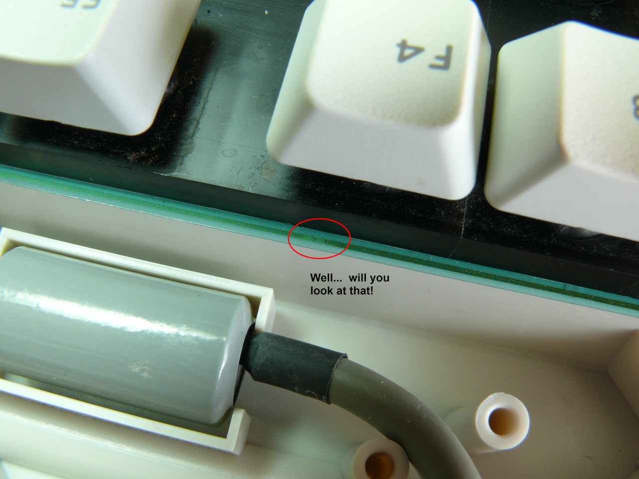

#346529 - 20/07/2011 16:49 Re: WTB: Gateway 2000 AnyKey keyboard [Re: tanstaafl.]
Posts: 5539
Apparently that trace is just a marker around the perimeter of the mylar sheet, and does not perform any function other than decorative.
Before trying to bridge the broken trace, I plugged the keyboard back into the computer just to see how badly I had wrecked it by soaking it in soapy water (electronics and all) in my bathtub. To my absolute astonishment it is now 100% functional. The only problem that arose was a sticking "Alt" key, and a single drop of teflon lubricant fixed that. I now have two working AnyKeys, and three more coming in the mail. Is it possible to have too much of a good thing?
I guess these keyboards are pretty robust.
