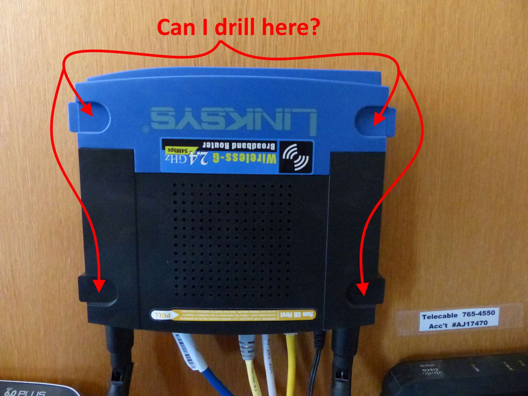

Actually, I was wrong about that. Turns out the floor/ceiling was 21" (53 cm) thick. The hole is now in place. It turns out that a 5/8" hole is just right for an RJ45 connector, but only because Victor's 21.5" long drill bit (yes, we just made it!) was so out of true that the hole is probably closer to 3/4" than it is 5/8".
Now, next question in a row.
Have any of you ever taken apart a WRT54GL router? It would simplify my installation somewhat if I could drill through the mounting feet of the router and just run the screws directly into the ceiling, but I don't want to go stirring up bits of electronics with my drill bit. The mounting feet are indented at the top and project out the bottom, so that multiple routers can be stacked on on top of another, but are not hollow all the way through.
What are the chances that I could fun a 1/8" or 3/16" drill bit through them?

From this image, I'd guess no:
Three out of the four would hit circuit board. You know, the UniFi AP's come with a real nice mounting kit... wink
A long time ago, though it was a WRT54G (same case design). Linksys was going through multiple iterations of the electronics inside, at times with no indication in the model number that anything changed. It's best to check your unit yourself to be certain.
iFixit has some community guides on repairing/opening various Linksys units here: https://www.ifixit.com/Device/Linksys_Router
Basically that blue plastic piece is snapped into the black plastic piece. Refer to the pictures in these two teardowns for help on where to squeeze to open the case:
https://www.ifixit.com/Guide/Linksys+WRT54GS+v2+Rear+Case+Replacement/7126
https://www.ifixit.com/Guide/Linksys+WRT54G+Motherboard+Replacement/7017
Yes, you can drill there, but only in the outmost edge of each of the four pod/feet things. The rubbery bits can be pried out with a knife/screwdriver first, and then it is safe to drill only outside of the "curved" edges of the router body.
If you want better access, open it up. Scary the first time, but here's how:
The blue/purple front detaches from the dark main body of the router. There are no screws (unless yours is old enough to have them under those rubber pads you removed above). Instead, just firmly grab one of the two back "feet" in one hand, the corresponding front "foot" from the same side of the router in the other hand, and pull hard/quickly. The front will snap apart from the main body, revealing the innards.
It helps to slice through the "do not tamper" sticker beforehand. smile
Looks like about 1/4" max space for drilling, on my v1.1 WRT54GL.

Doug,
Is it supposed to be upside down, on the ceiling, or vertically mounted, on a wall?
If on a wall, what I did with my old WRT54G is:
- Mark on the wall where the feet would end up
- Remove the rubber parts from the feet - they should slide out of them.
- Nail/screw the rubber parts on the wall, from the inside - they are hollow.
- Slide the router feet back on them.
It stayed up for years. Hopefully the design has not changed and what I did is still doable. Also, I hope my English made sense. if not, feel free to ask.

The primary router is mounted on the side of my computer hutch, exactly as you described in your post.
The secondary router will be mounted upside down on the ceiling, right over the doorway between the bedroom and the kitchen/dining room, so hopefully the signal will propagate through both rooms.
Why not just use some Z-clips?
edit: maybe "offset clip" is a better name than Z-clip.

I have a thin strip of aluminum that can be easily cut and shaped. I'll take 3" long pieces, bend them into an "L" shape, pop-rivet them to the hollow portion of the router's mounting feet, then screw the whole mess into the ceiling with anchor bolts.
Oughta work. Maybe. Presently I'm waiting for the downstairs neighbor to leave town later this week so I can make the changeover without interrupting her internet service.
Let's see... I've got the router, the aluminum strip, the anchor bolts, the ladder, the cordless drill and a 1/4" masonry bit. Hmmm, I need a 3-meter Ethernet cable, and about four feet of two-conductor wire to extend the power supply connector. Some goggles would be useful for when I'm drilling into the cement ceiling above my head.
I'm probably over-thinking this whole thing. Reminds me of when I was having some carpentry work done in my basement in Alaska, bare drywall, no finish work had been done. I wanted to reposition a light switch, so I took careful measurements, made up drawings, put marks on the walls, and started to explain to the carpenter in great detail what needed to be done. While listening to me explain, the carpenter whipped out his cordless sabre saw, cut around the light switch, took his hammer and knocked the switch box off the stud, cut a similar sized hole next to the stud at the new location, knocked the nail which was still dangling on the light switch box into the new stud, stuck the original piece of drywall around the light switch, put the second piece into the hole left from the original location, and said he'd sand and tape the two spots later.
What would have been a weekend project for me he did and finished before I could finish explaining what I wanted done. A bit humbling. The plumber I had working to install the new furnace told me: The difference between an apprentice and a journeyman is, the journeyman knows how to fix his mistakes.

Let's see... I've got the router, the aluminum strip ... and about four feet of two-conductor wire to extend the power supply connector...
Aluminum is easy to form, but it is metal. If you have a suitable non-metallic material that would provide less possibility of messing with the WiFi radio propagation patterns.
Some plastics can be shaped and formed with mild localized heat such as a heat gun. Or find something plastic with a useable shape and cut pieces from it.
