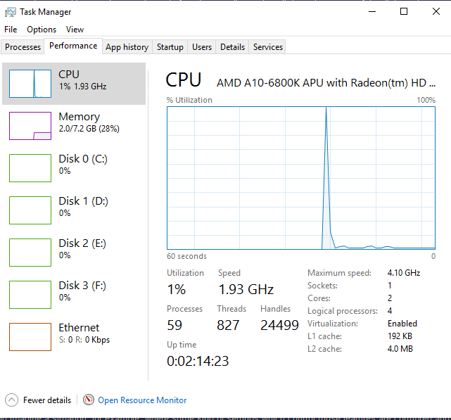

#367564 - 15/09/2016 20:17 Re: Windows PSA [Re: Dignan]
Posts: 5539
I'm sharing this because I need to vent and I also want to make you folks aware of it
Looks like I'm OK, then...
#367567 - 15/09/2016 22:19 Re: Windows PSA [Re: Dignan]
Yes, that's what it should look like, and most people's systems do, particularly when they're not running much to speak of.
With these systems, I can open the task manager the moment after logging into Windows, and the disk is pegged to 100% and stays there permanently.
