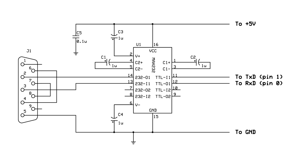

I have another question about my schematic that you might be able to help me with.
I'm using the attached schematic from this page for my MAX232 circuit. It's wired as follows:
MAX232 Pin 1 and 3 aka C1+/C1- - Bridge with a 2.2uf ceramic capacitor
MAX232 Pin 4 and 5 aka C2+/C2- - Bridge with a 2.2uf ceramic capacitor
MAX232 Pin 2 aka V+ - Connect to Pololu 5v via a 2.2uf ceramic capacitor
MAX232 Pin 6 aka V- - Connect to GND via a 2.2uf ceramic capacitor
MAX232 Pin 11 aka TTL-I1 - Connect to Arduino Mega Board 18 aka Tx1
MAX232 Pin 12 aka TTL-O1 - Connect to Arduino Mega Board 19 axa Rx1
MAX232 Pin 13 aka 232-I1 - Connect to RS-232 plug pin 3 aka Tx
MAX232 Pin 14 aka 232-O1 - Connect to RS-232 plug pin 2 axa Rx
MAX232 Pin 15 aka GND - Connect directly to GND
MAX232 Pin 16 aka VCC - Connect directly to Pololu 5v
I'm using 2.2uf capacitors for all of this because of a note in the datasheet. I'm using this MAX232 chip from Digikey, and when I look at the datasheet for the chip, I see the following note:
"The MAX232E requires 1-µF capacitors, although capacitors up to 10 µF can be used without harm. Ceramic dielectrics are suggested for capacitors. When using the minimum recommended capacitor values, make sure the capacitance value does not degrade excessively as the operating temperature varies. If in doubt, use capacitors with a larger (for example, 2×) nominal value."
So that's why I'm using 2.2uf ceramic caps.
So far so good. My question is about the last capacitor "C5" in the attached schematic. It simply bridges 5v and Gnd with a capacitor. (I'm just using another 2.2uf ceramic capacitor there.) I'm wondering (a) why is this cap there in the schematic at all, and (b) if that is having an adverse affect on my board/circuit since it's bridging the 5v rail that everything else is running off of. Any ideas or recommendations related to that capacitor?
Thanks!
#370218 - 24/12/2017 21:11 Re: BlueGigaEmpeg [Re: tfabris]
Posts: 14474
Without looking at the datasheet (lazy today), I'd say that 0.1uF cap is there for "decoupling" purposes. It is quite common to add such a capacitor between GND and Vcc (+5V) for each chip in a circuit, as close as possible to the GND/Vcc pins of the chip.
The purpose seems to be to smooth out any voltage fluctuations that might otherwise be caused by small instantaneous current draw as the chip switches internal states and whatnot.
https://learn.sparkfun.com/tutorials/capacitors/application-examples
So it's there just to keep the +5V supply "clean" and stable.
Edited by mlord (24/12/2017 21:27)
#370219 - 24/12/2017 21:28 Re: BlueGigaEmpeg [Re: mlord]
Posts: 31565
Cool thanks!
So you're saying it's normal to put a voltage stabilization cap physically close to more than one component on the same board, even though they'd all be working off the same +/- rail, and that doesn't adversely affect the components?
Does the value of the cap there at that particular point matter much? I'm using a 2.2uf there at that point.
#370220 - 25/12/2017 02:20 Re: BlueGigaEmpeg [Re: tfabris]
Posts: 14474
It's a relatively minor thing on the whole. It does need to be very close to the pins it is "protecting", so that it can react and smooth the voltage before minor spikes/dips reach the chip itself. Or emanate from the chip.
0.1uF is the most commonly used value that I remember. Bigger values don't stop shorter (more common) spikes.
But really, this will will all work even without it.

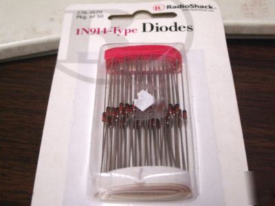

For the diode, any "small signal" diode will work. I have no specific recommendation -- myself, I'll just grab whatever I can find in my parts bins, or rob one from an old motherboard or whatever. -- you might already have some of those.
I've got a pack of Radio Shack 1N914-type diodes. Would these work?
They are the same kind as listed here in this ad:
http://www.bakersfieldads.net/Bakersfiel...ckage-of-50.JSP
Photos from that page attached, not my photos but mine look just like that with the same specs.
Seems to be similar to, though not exactly identical to, this Digikey part:
https://www.digikey.com/product-detail/en/on-semiconductor/1N914/1N914FS-ND/978749
#370222 - 26/12/2017 21:07 Re: BlueGigaEmpeg [Re: tfabris]
