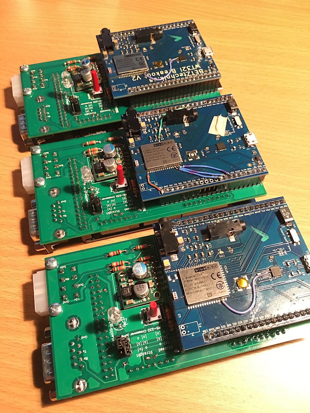

#370498 - 11/02/2018 21:56 Re: BlueGigaEmpeg [Re: tfabris]
Posts: 31563
Current status:
- Three working and completed BlueGigaEmpeg assemblies, including my own prototype unit. All of them use the 7.5 volt Pololu power supply, and 1.5k resistors for the I2S voltage dividers. No pops observed in the audio from any of them, they are all working perfectly and I'm so thrilled.
- I have three working Betz boards, all of which required some funky jumpering to get working, some required more jumpering than others. I am undecided as to whether or not I want to sell someone a funky jumpered Betz board, or if I would rather wait for his next production batch to arrive from China so that I'm selling un-funky boards to you fine folks.
- I've got enough components in stock to assemble a total of nine sellable assemblies, not counting the Betz boards.
- I await the final enclosure box design from Shapeways. I have an enclosure here that has some problems which I've corrected in the next design. A testprint of the corrected design is in production at Shapeways and I should have it in a few days. If that fits perfectly, I'll place an order for the remaining nine, and have them here a couple weeks after that.
Mark, thanks again, so much, for the tips about reducing those voltage divider resistors to get rid of the noise.
Attached: Photo of three working assemblies. Note that they are a mishmash combination of prototype and final hardware, hence the differences between them.
Home stretch!
#370499 - 12/02/2018 03:23 Re: BlueGigaEmpeg [Re: tfabris]
Posts: 14472
Looks good!
My one suggestion: Drop some goop (hot-melt glue, epoxy, or silicone) on the wire jumpers, to give them some vibration-proofing for car use.
#370500 - 12/02/2018 04:57 Re: BlueGigaEmpeg [Re: mlord]
Posts: 31563
Excellent suggestion. The final Betz boards won’t have jumpers, hopefully, just these janky ones. But the ones pictured are already CA’d down. If you look at the way the light is glinting off the one in the lower right of the photo you can see the CA there. smile

Also:
I tinned the wire and am just trying to touch the wire to the pad with the iron until it gets hot enough to flow and then remove the iron, but then the wire just doesn't stick after the solder cools.
Flux will help with that, but sometimes I also have to add additional solder in situations like that. Just be careful you don't blob it around so much that you bridge some things that shouldn't be bridged.
Let me know how the project goes for you!
