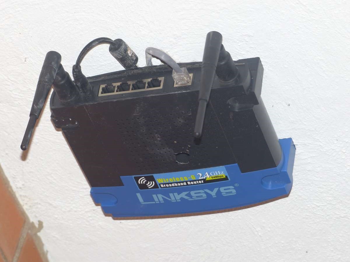

I have a thin strip of aluminum that can be easily cut and shaped. I'll take 3" long pieces, bend them into an "L" shape, pop-rivet them to the hollow portion of the router's mounting feet, then screw the whole mess into the ceiling with anchor bolts.
Yes, I finally got around to installing the downstairs router on the ceiling of the apartment below mine.
I found a much simpler way of sticking the router to the ceiling, one that will make most of you a bit crazy.
The router has grillwork for cooling on both the top and bottom. By holding the router up to the light, I saw that there was an area about an inch and a half square where I could see right through the middle of the router. So I drilled right through and fastened the router into the ceiling with a single moly bolt. Works great!
I got someone who knows more about networking than I (that would consist of a subset of about 90% of the total population) to configure the downstairs router. It's connected by Ethernet from one of my ports on the upstairs router, and that's about all I understand about it.

Hey, if it works, who cares? I don't think the router is going to suffer from a lack of that half inch square section of ventilation. Being on the ceiling is probably the more thermally challenging aspect, but there should be plenty of airflow around it!
There's a few ways it could be set up, but again, if it works then it doesn't matter much. The problems that could arise from an improper configuration (like double NAT) might not even have any real world ramifications.
The only hesitation I'd have about that router is that it's only 802.11g, isn't it? We've gotten to the point where 802.11ac (two generations newer) is completely affordable. Are you able to stream video through that?

Separate from any speed limitations, old and inexpensive routers tend to accumulate known and unknown unpatched security issues. Firmware updates tend to fade in frequency and eventually become unavailable.
Hacks and botnet infestations of Internet connected devices can be hard to detect after they have succeeded. Absence of router updates can allow them to remain embedded.
Straight up bugs and implementation errors can bedevil a home network for the lifetime of the old router.

I assumed that, given it's a WRT54Gx, it was running a 3rd party firmware. I probably shouldn't assume that, or that it'll get updated regularly.

Not only are newer 802.11ac APs much faster, they're also smaller and many do the auto-updating firmware thing. With your clever ceiling mount, if you could find an AP that supports power-over-Ethernet, you could end up with a very clean install.
