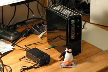

#310779 - 31/05/2008 15:40 Re: Which mini-ITX board to buy? [Re: mlord]
Posts: 14486
My own mini-ITX server ... motherboard is a VIA EPIA-CL6000E ...
Oh, and it lives in a cookie tin:
Description: "zippy", our 24/7 server.
Description: Inside the cookie tin..

The motherboard manual for my VIA board cautioned that proper airflow is a requirement for fanless.
So I have the board in a vertical mount, with lots of case holes above/below the board to allow a chimney effect to circulate fresh air across the heat sinks.
The hard drive is, of course, mounted at the bottom of the case, below all of the heat-generating components. A modern notebook drive only gives off 1-2W of heat, so it will self-cool so long as nothing else interferes.
