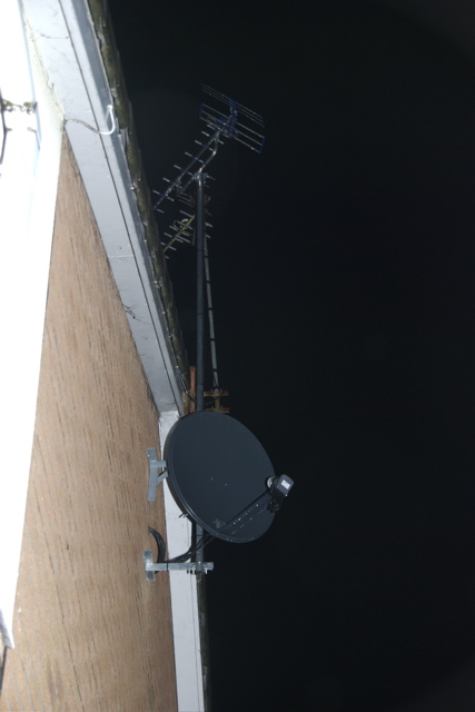

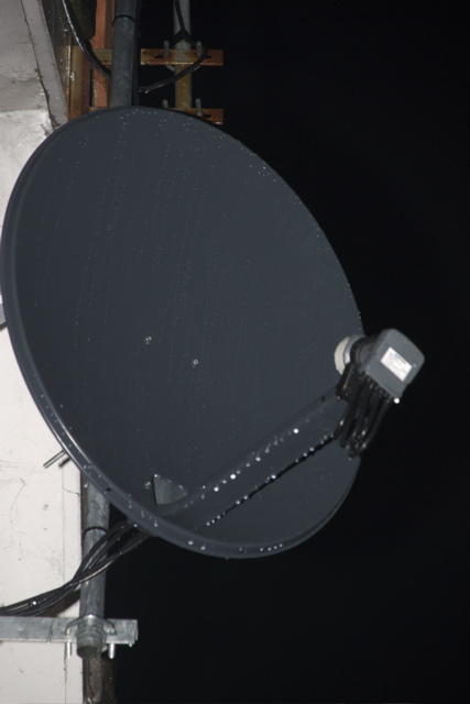

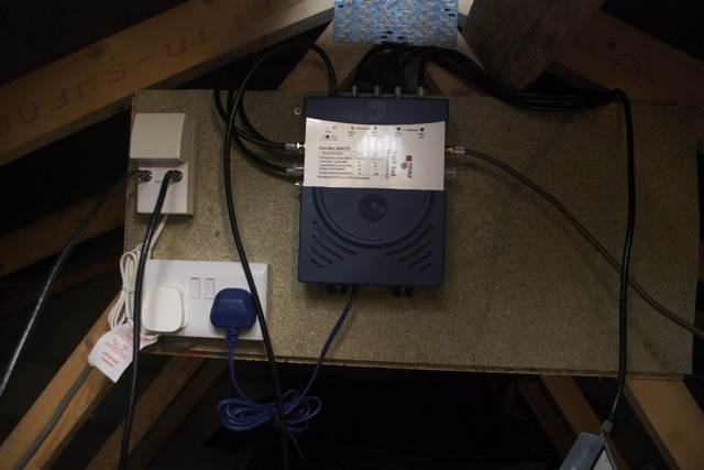

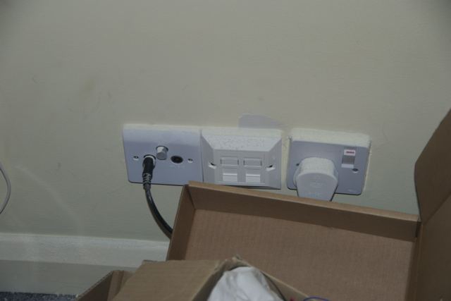

Okay, time for show and tell....
The top photo shows what appears in each room. Please note I'm not intending to do A/V distribution in the house.
2 x CAT5e
2 x CT100 RF
Gives me two ethernet/serial/closing contact in each room. Also the ability to have a Sky+/Freesat PVR and terrestrial TV/Radio connection.
The dish and aerial outside, the bottom photo shows the quattro lnb.

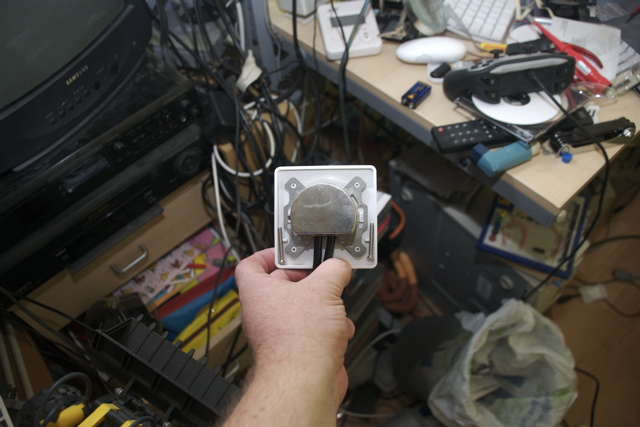

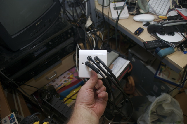

#314791 - 07/10/2008 17:56 Re: Whole house media distribution [Re: andym]
Posts: 3995
Closeup and rear view of the RF plate. Note the back is completely shielded.
The bottom photo show the multiswitch and aerial amp power injector in the loft.
