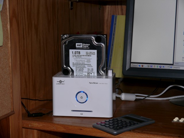

I just finished upgrading my computer, replacing a 300GB hard drive with a 1 TB hard drive (WD1001FALS Caviar Black), and adding a second 1 TB hard drive in an external enclosure to use for backing up the internal drive.
I am concerned about how hot the drive in the external enclosure gets.
The one in the computer case has a big fan blowing air across it all the time, so it probably stays cooler than the external one that just sits out in the open. The drive gets hot enough when it is working continuously (as in formatting the drive, or copying 200 GB of files onto it) that it is very uncomfortable for me to hold my fingers on the top of it. I would guess the temperature at the top of the outer case is approaching 130--140 degrees F.
Is this a matter for concern?

#326074 - 14/09/2009 16:45 Re: How hot shouldl a hard drive get? [Re: g_attrill]
Posts: 5546
Originally Posted By: g_attrill
Is there any way you can bodge a fan into the enclosure?
As you can see from the picture, it isn't really in an enclosure. The drive is like a piece of toast in a toaster, with only the bottom third "enclosed", the rest of it sticks out in the air. That part that sticks out is what I am concerned about -- the top edge of it stays uncomfortably hot.
I've installed the Active@ software that Bitt linked to to see what the actual temperature is, and it works a treat -- except for another problem I've encountered.
My computer sees the external drive just fine with a USB connection, but of course the Active@ software doesn't monitor USB drives. I have gotten the computer to see the external drive one time with the SATA connection, after I figured out that (a) the USB cable has to be not connected, and (b) the computer has to be rebooted with the SATA cable connected and the drive powered up. (At that time I did not have the Active@ software installed.)
Since that time, I have not been able to obtain a SATA connection despite numerous attempts. Is there some sequence I have to follow, perhaps some arcane incantation I am supposed to chant, to make this connection?
Oh, wait - in the interest of not making myself sound like a complete idiot, I checked the back of my computer (not a trivial task with my setup, it involves moving a 250 pound computer hutch containing another 60 pounds of computer/printer/scanner/monitor/speakers/stuff) away from the wall) and guess what I found dangling out of the back of the hutch? (You're way ahead of me, aren't you... smile )
I'll disconnect the USB cable, reboot the computer, and see if an extra Terabyte of storage shows up in Windows Explorer. Meanwhile, I have set up my own highly sophisticated temperature monitoring system (Bah! Who needs fancy Active@ software when I have a meat thermometer and some Scotch tape!) and it is showing a lower temperature than I had feared, something around 110 degrees F or 43 degrees C., assuming that the needle travel is linear because the lowest temperature marked on the dial is 140.
To be continued...

#326080 - 14/09/2009 16:59 Re: How hot shouldl a hard drive get? [Re: tanstaafl.]
Posts: 31583
Assuming that you don't keep the house unreasonably hot, leaving the drive open to the air like that means that it's as cool as it's gonna get.
Overheating hard disk problems usually only occur when you're enclosing them in small spaces, such as unventilated sections of computer cases.
#326084 - 14/09/2009 17:24 Re: How hot shouldl a hard drive get? [Re: wfaulk]
Posts: 5546
Even better, one or two of these.
Those are really neat! However, as I had suspected, having the hard drive's data cable disconnected from the back of my computer did indeed prove deleterious to SATA connectivity.
An accurate digital thermometer taped to the outside of the case shows a temperature of 105 degrees. Active@ shows an internal temperature of 120 degrees. A 15 degree difference outside/inside is not unreasonable, and neither temperature is cause for serious alarm. Interestingly, the identical 1 TB drive inside the computer case, being lovingly bathed by two five inch diameter fans, is running more than 35 degrees cooler (at 84 degrees internal temp) so the benefit of airflow around the drive is clear.
Next, I'll see what happens to the temperatures when I start running the drives under load (right now they are just spinning, no read/write activity.) I have about 12 GB of data to back up from the internal drive to the external drive now, so we'll see what happens.
To be continued...
#326090 - 14/09/2009 18:21 Re: How hot shouldl a hard drive get? [Re: tfabris]
Not really. There's nothing moving the hot air away from the drive, so the environment will approach equilibrium with the drive. If you had air moving over it, it would have a constant supply of cool air.
In other words, forced convection is a more efficient method of heat removal than natural diffusive convection.
#326101 - 14/09/2009 19:44 Re: How hot shouldl a hard drive get? [Re: wfaulk]
Posts: 5546
Exactly.
When I started working the drive, writing 12 GB to it, it quickly went up to a critical temperature of 122 degrees (50 degrees C) and stayed there. I set up a fan to blow across it, and in two minutes the internal temperature dropped by six degrees, eventually stabilizing at 96 degrees, a 26 degree drop. The fan-cooled drive inside the computer case which was being read from but not written to rose three degrees in temperature, from 84 degrees (F) to 87 degrees.
Ambient room temperature for all of this was 76 degrees.
Obviously if I am going to keep the temperature of the external drive down to a reasonably safe level I will have to get some sort of fan to blow across the drive when it is in use.
