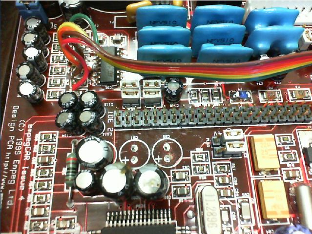

Given the display fuse on my Mk1 randomly died last weekend, and I'm on the other side of the world, maybe it is the fault of the recent solar flares.
On a more serious note, is there anywhere I can get replacement fuses? Digikey appears to be sold out, and I don't really think it's worth shipping my empeg overseas to get fixed. Alternately, would it be possible to wire in an M205 fuse such as this instead of the SMD fuse without any nasty side affects?
Edited by JimCamel (30/08/2010 06:43)

An M205 fuse is 20mm long x 5mm in diameter. Massive compared to what you are replacing. That said, if rated appropriately it would work but it would be a very very ugly fix.
I realise it isn't an optimal solution, but I thought if I ran a couple of wires off it I could place an M205 Fuse in a fuse holder somewhere else inside the case such that if it blew again it would be a simpler replacement than SMD soldering.
That said though, I'll give Farnell a try first. I guess it's taken around ten years to blow, and I can probably afford to replace it every ten years.

Well, my fuse replacements arrived yesterday (Thanks so much to Stu, If you're ever down this way I owe you a beer). However, despite very carefully attempting to remove the hot glue holding the drive cable in place with a scalpel, unfortunately it still came off with the cable, ripping two of the adjacent capacitors off their legs too frown I got the fuse soldered in place and removed the old capacitor legs off the board, so now I need to find some replacement caps.
The capacitors have written on them "35v" and underneath "22", so I assume they're 22uF 35v capacitors. Mind you they also have written 85c, (m) and 214, but I'm guessing thats maximum temperatures and some sort of product ID.
Can anyone confirm the values of these capacitors? If anyone has the datasheet for an MK1 it's C91 and C95. I've attached a couple of images showing where the caps came from and what they look like (excuse the quality, I'm at work so they were taken with a webcam).

Originally Posted By: JimCamel
The capacitors have written on them "35v" and underneath "22", so I assume they're 22u.
Yes, you're correct, they're 22u/35V electrolyte capacitors. Just remember, when you install them, install them the correct way around. They are polarized.
Stig
