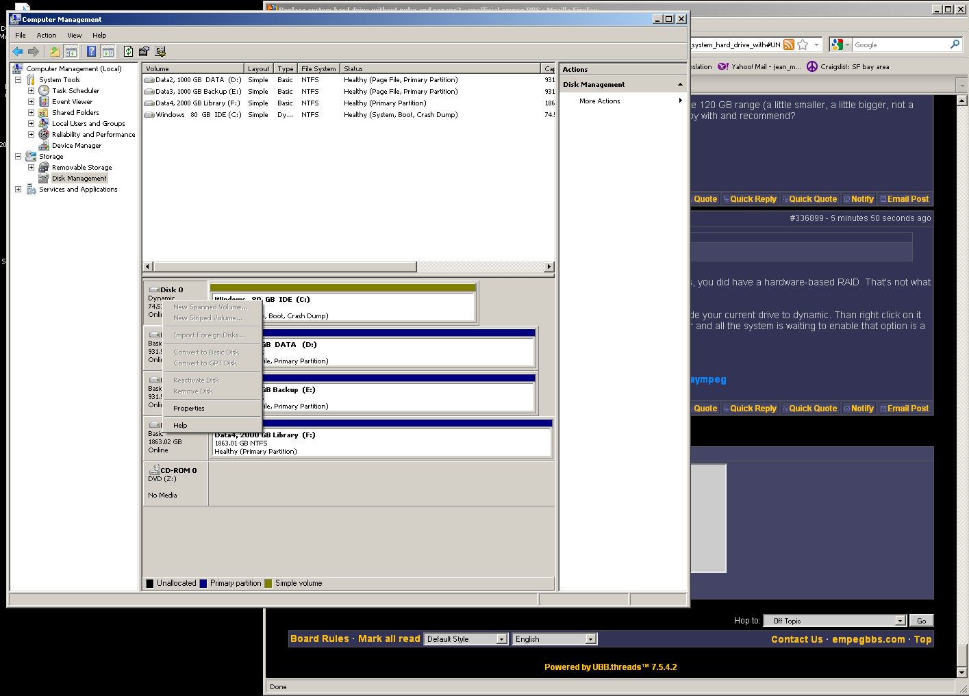

#336899 - 09/09/2010 00:11 Re: Replace system hard drive without nuke and repave? [Re: tanstaafl.]
The RAID failed and
Ok, I just clicked on the link, and if that's what happened to you, yes, you did have a hardware-based RAID. That's not what I am referring to above. Which may still work, anyway.
If you want to check in advance, just go to disk manager and upgrade your current drive to dynamic. Than right click on it and if you see a grayed "Add Mirror" option, you can create a mirror and all the system is waiting to enable that option is a second hard drive with enough empty space.
#336902 - 09/09/2010 00:26 Re: Replace system hard drive without nuke and repave? [Re: Taym]
Posts: 5541
Originally Posted By: taym
The RAID failed and
Here's what I see... (right-click to view image, zoom to read it.

#336904 - 09/09/2010 00:52 Re: Replace system hard drive without nuke and repave? [Re: mlord]
Bummer, it only let's you create spanned and striped volumes, not mirror ones. What a silly thing to disable the feature.
You'll have to create the mirror via "hardware" (Bios + Intel utility).
Or you may hack a system file with an hex editor to enable the mirroring (I should have the info needed somewhere). At the next update that system file may (and will eventually) be replaced by a new version uncapable of mirroring, but by then you'll be on the SSD. I don't know whether I'd recommend something like that. I did it once in XP and irt worked, but stil...
