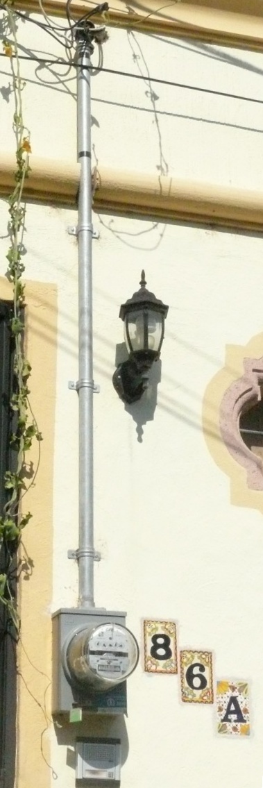

Actually, there already are three meters, but...

No, it makes sense, actually. You have to understand the construction of the house. It is a four-story house with the top two floors sold as a single condominium, even though each of those floors is really a separate domicile. This is because the only access to the top (fourth) floor is through the open deck area of the third floor. This meant that the third-fourth floors could only be legally defined as a single unit, thus a single meter. The bottom two floors are on their own meter already.
This living arrangement would be difficult under most circumstances, but the downstairs neighbor is a long-term (nearly 25 years) close friend of my wife, and they were next-door neighbors in California for all of that time. Privacy issues are just not... an issue.
We will be able to separate the two floors electrically, although not legally from a domicile perspective, because they are complete, separate living units (kitchen, dining room, bedroom, bathroom, etc.) occupied by separate families. Under other circumstances, CFE would not allow multiple meters for a single legally-defined residence, otherwise everybody would have multiple meters on their houses.

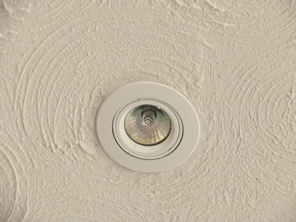

Unfortunately not possible. All but two of the lights in the house are the compact halogen type (see photo) and not cost-effectively changeable. The two exceptions are run less than an hour a month between them. At that rate it would take 7 months to use 1.4 pesos worth of electricity (1 KWH at the intermedio rate), lets call it 2.4 pesos per year, so replacing the six incandescent bulbs with $15 worth of compact fluorescents would save me 1.8 pesos per year, requiring 72 years to amortize the cost of the bulbs. Not an acceptable ROI. smile
You can replace GU10 (mains) or GU5.3 (12V) compact halogens with LED equivalents at 1/10 the power draw. The light is detectably less pleasant though (cold and ghostly and somehow dark).

Those MR-16 halogen bulbs can indeed be replaced by LED versions. The cheap ones cost $10-15. Tolerables ones are $30. Beautiful ones that are absolutely indistinguishable from halogen are, sadly, $70/ea. I expect this to change rapidly over the next few years.
Also, current MR-16 LED bulbs require that the 12V transformer be of the "magnetic" type, producing nice pretty sine waves of power, but they're more expensive. "Electronic" transformers generate choppy, ugly power, which is completely irrelevant to a classical light bulb filament but just doesn't work at all for LEDs.
(Fancier LED fixtures can work with just about anything, but there's nothing like that, yet, in the MR-16 form factor.)

That possibility has been checked pretty thoroughly. The power comes in off the pole and down a steel pipe into the meter. (photo) Someone could easily steal power ahead of the meter, but the meter is set into an 8" steel-reinforced brick wall, and the only way to tap into the metered power is inside the house.
You have me thinking, though. I will have my contractor check VERY carefully that no circuits from the two bottom floors of the house are somehow going through my meter. Carlos, a man who I have good reason to trust absolutely and completely owns the bottom of the house, and he mentioned that his electric bills are a small fraction of mine...

Can you shut off your main breaker and see if the meter is still going up?

Yes and no. I don't have a main breaker, but I can turn off each individual circuit breaker (there are only 10 of them).
The results would be inconclusive unless the meter did continue to turn, because if the meter stopped it would only indicate that the extraneous circuit (if there indeed was one) was not at that moment drawing power.
It's an excellent suggestion, though, and I am going to try it right now.
OK, I had an aha! moment when I found the meter still turning with all my breakers off. Then I realized that the neighbor's breakers go through the same meter, and when I switched all of hers off, the meter stopped.

"Unfortunately not possible. All but two of the lights in the house are the compact halogen type (see photo) and not cost-effectively changeable."
Are you sure? LED replacements are available for a lot of the traditional halogen/reflectors with base type like MR16. Not sure on payoff/ROI, but I wouldn't get stuck on 1 single ROI element if the overall goal is to get below a certain threshold that drops the who cost factor by half.
Can you point me in the right direction? There are some do-it-yourself options (build your own circuit board, find LEDs, somehow put it all together) that don't excite me. What I want is a simple solution where I can just unplug/unscrew/unwhatever the fixture and put in the replacement.
Cost is a consideration. I did a recount, and find that I have 25 of the little beggars in the house, the majority of which are never used, but if I replaced them all it could run a couple thousand dollars. Maybe just the 10 that do get used (two sets of three, one set of four) but even those probably don't add up to more than five or ten hours in a month.

If you throw "LED MR16" at Google, you'll see lots of solutions on offer, but many are poorly made. LED vendor Cree has built a LED module expressly for this market. Hunting around, there's at least one vendor claiming to have this in production, but I can't find anywhere to actually buy it.
This is a rapidly evolving market. My intent is to wait a year or two for these things to shake out, then go for it.
Warning: if you do choose to buy one of these things now, pay careful attention to two numbers: the color temperature (reported in degrees Kelvin) and the CRI (color quality, with 100 being "perfect"). If you want to match your existing halogen bulbs, then you want a color temperature of 2700K and as good a CRI as you can find (80 minimum).
EDIT: Warning #2: one other thing worth waiting for is that newer controller boards for these LED MR16 fixtures will be compatible with the electronic dimmers that are commonly used.
