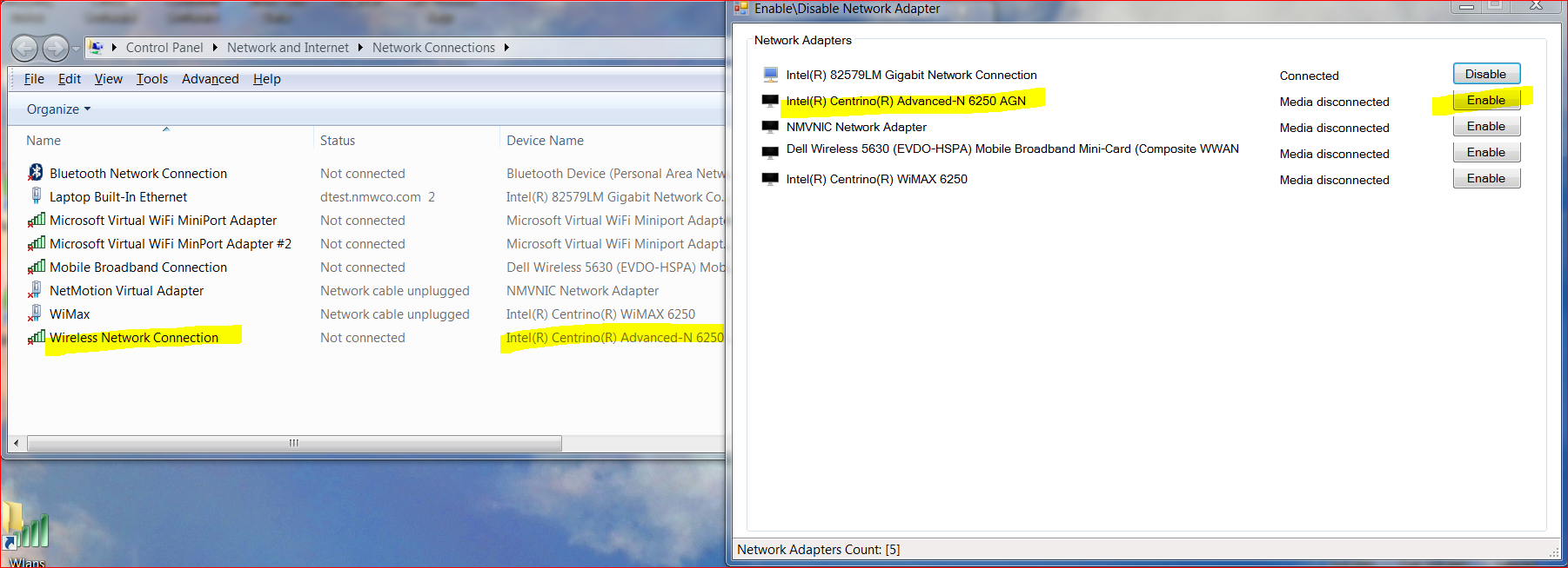

But it *does* lie. I downloaded and ran that example code and it lies like a rug. See the attached screen shot.
Note in the screen shot that my wireless network connection is ENABLED, though it is not connected to anything at the moment. The example code that you linked presents it as DISABLED, which is wrong, as shown in the screen shot.
If I connect it to a wireless network, then the example code presents it as ENABLED. Again, this is wrong. Connected is not the same thing as Enabled. Disconnected is not the same thing as Disabled.
This Microsoft-supplied example code has the same problem as all of the other code I've found on the internet. Exactly as I stated in my original post.

Thank you!
How did you find that?
Some google and some minor work with the wmic command. Glad it worked. Still a bit clunky but if it works well enough then great.
#362349 - 08/08/2014 14:05 Re: Windows programming: Listing enabled/disabled network adapters. [Re: Shonky]
Posts: 31570
The only clunky part is using the DOS command line WMIC. But that's just an example to demonstrate the field values. For the actual code I was writing, which was in C# and was making WMI queries directly, it wasn't clunky at all.
I already had a C# function that was querying the NetEnabled property and getting the wrong answer. I merely had to change that to querying the ConfigManagerErrorCode property to get the right answer, and I was done. Not clunky at all.
#362353 - 09/08/2014 02:09 Re: Windows programming: Listing enabled/disabled network adapters. [Re: tfabris]
Ah OK. Cool.
