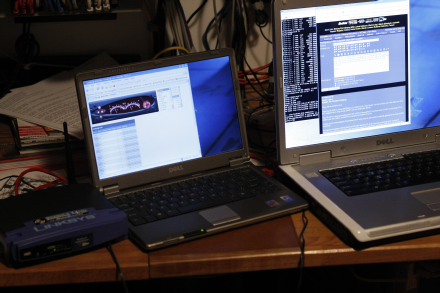

#306060 - 12/01/2008 20:40 Re: Wireless bridging! [Re: mlord]
Posts: 14483
Okay, still no problems here.
I have my DD-WRT (Linksys WRT54GS_v2) configured as "client bridge" over the wireless, and I now have two wired PCs plugged into it using remote DHCP, and now surfing the internet.
The DD-WRT is relaying everything over WiFi (WPA2-Personal/PSK) to another brand of WiFi access point (AP) in another part of the house, and that AP is wired to the internal LAN here.
A wired server on the internal LAN provides DHCP service for all, and is also the internet gateway for our external DSL connection.
File transfer throughput (NVSv3) to/from a DD-WRT attached PC, to the wired server at the far end, is about 20 mbits/second, which is pretty much what one should expect over a Wireless-G connection (under 50% of the raw 54mbits/sec rate).
Any questions?
Edited by mlord (12/01/2008 21:09)

And just for a proper demo, I now have one of the two remote PC's connected across the bridge to an Empeg with EmpegWebLite running, with the active visuals display and all working.. while at the same time I'm using the other machine to surf, email, and write this posting.
