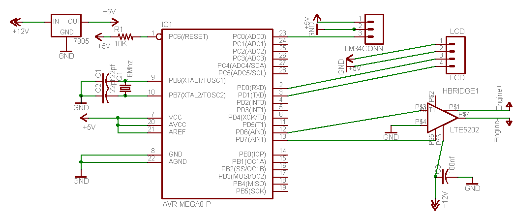

I am working on a project where I need a DC motor to run forwards and backwards. After some research I thought that this H-Bridge would do the trick. So I hooked it up via an Arduino (AVR chip) to provide logic control and a wall-wart (3A) 12VDC supply to provide power for the motor. The motor runs and stops as instructed by the AVR, but no matter what it always runs in the same direction even though the AVR chip should be telling it to run in two directions. Can any electronics experts here tell me why this @#$@# motor would only run in one direction connected to this H-Bridge? The schematic is attached for those so inclined. I'm attaching the motor to the H Bridge by hooking up output 1 of the bridge to one motor pole and output 2 to the other motor pole (is this right??).
Description: H Bridge Circuit with TLE5205 and Arduino
Edited by siberia37 (12/03/2008 18:48)

Your wiring looks correct, but the datasheet shows an unusual truth table on pages 4 and 5.
It looks like your two GPIO pins need to be 00 for one direction, and 01 for the other direction. Use 10 for "brake" mode, and 11 for "coast".
Edited by mlord (12/03/2008 19:36)
Cheers Thanks- I will double check my coding on the AVR. If I still can't get it to work then I guess I will order some L293s. I'm not happy the L293 only outputs 600ma though. My motor will probably draw more than that.
Edited by siberia37 (12/03/2008 19:56)

Ok it ended up being some sort of logic error as suspected. The digital pin I was plugging in to must have had 2V logic because that was what was reading on the multimeter. I changed it to a different digital pin and it works fine now. Never knew the AVR had so many different logic levels...

Hi,
I noticed that your circuit only had high frequency decoupling (the 100nF), which is good, but there should be bulk low frequency decoupling as well. Maybe you already have it and it's not shown.
You will notice that in the LTE-5202 datasheet, they have a large decoupling capacitor (100uF to 4700uF) on the power pin.
MOSFETs are very good at instantaneously sucking energy from the supply to drive the load. The instantaneous power delivered to the chip is limited by the power supply source impedance and the inductance of the power interconnect to the Motor Driver Chip.
The bulk low frequency capacitor acts as a "local battery", much like a large capacitor (1 Farad or more), is located near a car power amplifier to reduce the "local" source impedance that the amplifier sees. It improves the local storage for the amplifier to improve low bass performance. The midbass and high frequency energy source impedance is supplied by the decoupling within the power amplifier.
The load in your case is composed of FET RDS(on) in series with the motor DC resistance. The time frame is governed by the FET edge rate, motor inductance, and interconnect.
The capacitor will also improve the initial torque of the motor as the voltage on the FETs remains closer to the applied voltage during the transient. The FET Bridge voltage droops when the motor is started or moved from a position where it draws higher peak currents. The capacitor keeps that voltage closer (more available current) to the rail voltage over the transient time. If capacitor is not there, the FETs will be starved for energy during that timeframe.
The capacitor could improve stability & reliability too.

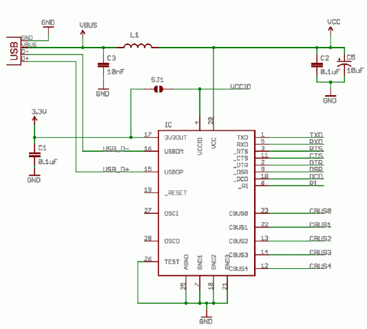

I also noticed that the schematic he referred to has very little decoupling too. It would benefit from a 10uF capacitor on the USB power side of the inductor. The system I'm having difficulty with, already has a (10nF) cap on the USB power side of the inductor. The clock crystal/circuit is built into the FT232R chip, and again, this entire USB chip/board is optically isolated from all of the motor electronics. There is no shared ground or signal or voltage lines with the motor driving stuff (also just a single chip). The motor driver has no clock or frequency to speak of. It's either on, or off, and there's no clock or switching of any kind within that .. just some darlingtons wired as H-bridge, with diodes -- all inside the single chip. The USB tends to fail when the motor is stalled (not turning, and therefore not generating pulses). Or perhaps the USB fails just before (?) the motor is about to stall, when there may be a rather largish EMI field being output (motor draws about 450mA at 4.8V when stalled, and maybe only 1/10 that when free running). So the mystery for me really is, how does a stalled motor, on independent circuitry and independent PSU, somehow affect my USB gadget? Yes, it's gotta be EMI, I suppose. Big magnetic field there from the motor at that point. The FT232R board does *not* have the usb cable shield connected to anything other than the terminating USB socket itself. The cable *is* grounded on the host end, though. It has a 10nF cap from USB power to ground, and some other similar bits aimed at transient suppression or something.  I did once try connecting the cable shield ground to USB logic ground on the FT232R board, and was surprised when doing so made things *much* worse. But that was before I decoupled the motor driver from it with the optical isolators. Here's the stock FT232 board schematic -- very simple, and probably in dire need of some mechanical shielding. I take the CBUS0/CBUS1 lines off to a pair of optical isolators, and from there back through 10K to GND. Those pins are powered from the VCCIO line, which I have jumpered to VCC. End of circuit. The rest is on the other side of the isolators, with it's own 5V PSU, a single H-bridge chip, two LEDs, and a motor.
Description: Description: Schematic for FT232R breakout board.

How close are the bypass caps to the actual chip? The inductance and resistance of PCB traces will affect how effective they are. The 0.1uF should be as close as possible across the pins to ground. If they aren't try a 0.1uF or even a 10nF straight across the pins.
The brute force approach of 1000uF on 3.3V shows you're probably on the right track. I'd try some smaller ceramics instead since the electrolytic (I'm assuming you've used) will have a high ESR. Some 1uF or 10uF decent ceramic caps are likely to help more IMO than your big electro.
A good high speed CRO might catch something on the supply lines but I'm guessing you won't have that. Stick with the filtering.
Got any ferrites? Try running a few turns of the of the CBUS lines. Might stop the ugliness getting in. One thing I've found with EMI/EMC is that often once the noise/interference gets in, it can be hard to get it out, so try and stop it at the "border".

How close are the bypass caps to the actual chip? The FT232R breakout board is tiny. It has just the surface mount FT232RL chip itself, and the caps/filters are all within millimeters of it. L1, C1, and C3 are right at the USB connector at the top edge of the chip, but C2 and C5 are a longish way from there. All of those parts are exactly what FTDI (the chip maker) recommends in their datasheets, but perhaps not quite right for this particular application. I'll try and work out a metal can or shield for the breakout board, as well as digging out some ceramic discs. Cheers

Another idea: /RESET doesn't have any external circuitry. I haven't looked up the data sheet but I'm guessing some kind internal pullup is inside the FT232R. Unless it has a proper reset circuit in there.
Perhaps it's sensing a reset? A small external cap (0.1uF for a start) and maybe a pullup resistor might help filter the reset line better. 10k and 0.1uF has a time constant of just 1mS so I doubt it will affect the start up when you plug in the USB. It probably wouldn't matter if it was held in reset for a bit initially anyway.

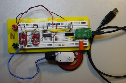

Yeah, I really need a storage scope here, to find out what's actually happening. But for now, I've just reworked the breadboard to shorten wires and the like, and it seems much improved. More later.
1.png (532 downloads)Description: Frankenswitch V2 on breadboard.

But for now, I've just reworked the breadboard to shorten wires and the like, and it seems much improved. More later. Mmmm... so long as I use a totally independent power supply for the motor side of the house, it works flawlessly now. Well, except for once in a very blue moon, when I force the motor in reverse while the current tries to drive it the other way, but even then it takes a few dozen attempts to glitch it. That's on our MythTV box, which has an undervoltage PSU (4.8V on the "5.0V" line). On my notebook (which has 5.1V on the 5.0V line) I cannot glitch it in that way. It's good enough now, but I really don't want another wall wart in that room. Powering the motor side directly from the 5V line of the ATX PSU in the box can still glitch it. So I may try a 12V line instead, and use a 7805 to step that down to 5V on the motor board. The saga continues..
