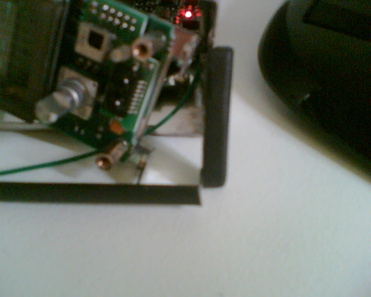

broken handle
Registered: 22/11/2007
Posts: 475
Loc: Denmark, Odense
can this handle be repaired?
when the 2 parts are put together they fit and you cant tell it's broken (you have to look close)

Yes, that can be repaired rather easily, by drilling in from the side, lengthwise along the handle. Then tap threads and bolt it back together. Or glue in a pin instead of the threads/bolt method.

Yes, that can be repaired rather easily, by drilling in from the side, lengthwise along the handle. Then tap threads and bolt it back together. Or glue in a pin instead of the threads/bolt method. Another repair method, stronger but more intrusive, might be to slice a thin slot through the corner section (from bottom/side), and then fill it with an angled metal plate, pinned (rivets or screws) in place. Cheers

Sadly today, I dropped my empeg about 5 feet (after 10 years of no accidents) and it landed on concrete. I now suffer from a broken handle (I rebent all the other parts already back into shape).
My handle is broken in the same spot as the one pictured in the first page of the thread. Is anyone repairing them?

The repair attempt (for Boelle) failed --50/50 chance, and we hit the wrong 50.
I think any machinist could fix it for you, though, with better odds than 50/50.

Welding (and grinding) seems the appropriate solution here.
#322954 - 03/06/2009 13:57
Re: broken handle
[Re: wfaulk]
Welding (and grinding) seems the appropriate solution here. What is the metal?
#322955 - 03/06/2009 14:04
Re: broken handle
[Re: Robotic]
Posts: 14488
Probably an aluminium-magnesium alloy, cast into shape with a mold.
#322956 - 03/06/2009 15:10
Re: broken handle
It should be weldable then, with TIG and 4043 filler.
