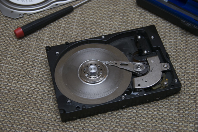

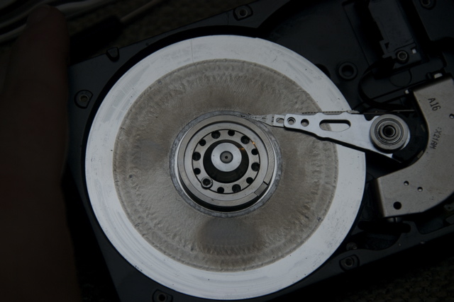

Posts: 3995
I got called to work last night to investigate what I was told was a worn out fan. Turned out it was an HD. What do you think caused this to happen?
#317336 - 15/12/2008 18:13 Re: BartPE and USB drives [Re: andym]
Is that a little bit of copper wire I see sticking out of the spindle? If so, I'm guessing that the motor failed catastrophically and probably threw the platter out of position.
#317339 - 15/12/2008 18:39 Re: BartPE and USB drives [Re: wfaulk]
Posts: 3995
I think it's just a reflection.
#317355 - 16/12/2008 00:22 Re: BartPE and USB drives [Re: andym]
lectric
Registered: 20/01/2002
Posts: 2085
Loc: New Orleans, LA
Wow, that's the worst condition I've ever seen a platter in. You sure it hasn't been dead for ages and nobody noticed until it actually started making noise? If I had to wager, it looks like some foreign material got caught in the r/w head and happily sanded the platter for you. I'd be VERY surprised if that just happened in a short amount of time.
#317356 - 16/12/2008 00:34 Re: BartPE and USB drives [Re: lectric]
Posts: 14485
Hey, at 7200rpm, a bit of hard substance on the heads would tear up the entire platter rather rapidly. Seconds..
