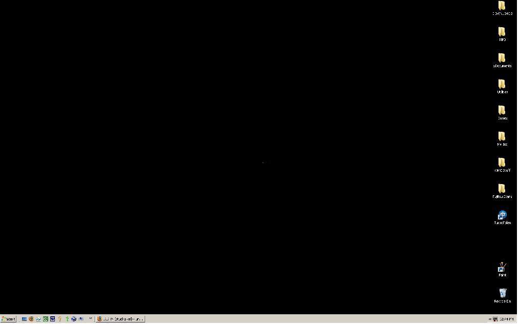

I have a similar situation on my 22" LCD computer monitor -- a bright green pixel just about perfectly dead center on the screen. I had never heard that something like this was fixable... I thought it was a hardware failure. Is it really possible that something like this can be repaired? It looks kind of like this, although the color doesn't show properly in the screenshot.

Is that a photo or a screen capture? The verticals appear too good for that to be a photograph.
Stuck pixels only exist on the monitor, if that's a screenshot (made using PrintScrn etc.) then I think you might have a RAM fault on your video card.
It looks like two pixels side by side? If we are talking about a monitor problem here then, assuming you have warranty remaining, it's worth checking the manufacturer's pixel statement. ISTR HP/compaq's statement making an exception where there were multiple pixel failures within a block of x by y pixels, perhaps other manufacturers do the same?
Actually, it is kind of neither and both. Don't read too much into the picture -- it was meant to show what the problem looked like, and is not an actual sample.
I took a screen shot, but of course a print screen doesn't capture the lit pixel, so I opened the screen shot in Paint, shrunk it down to a reasonable size, then manually inserted a green pixel in the middle to show what it looked like when I was staring at the monitor.
That picture is my normal desktop, so that bright green pixel right square in the middle is eye-catching. That hot pixel only appeared after the monitor was about a year old, at first intermittantly, then more and more often, and now it's always there. It really doesn't bother me too much, but if it's something that's easily fixable, then I'd take care of it.
