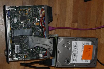

Just for fun.. I'll attach a 750GB (desktop) drive to a RioCar here, and run the builder on it.. Bigdisk builder v4 ran okay. Now installing the player software.. EDIT: Note that this is a 750GB Hitachi desktop drive, with a SATA interface. I've hooked it up through a SATA-to-PATA converter board from DealExtreme.

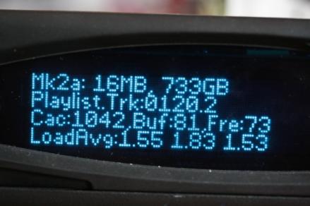

Just for fun.. I'll attach a 750GB (desktop) drive to a RioCar here, and run the builder on it.. Bigdisk builder v4 ran okay. Now installing the player software.. EDIT: Note that this is a 750GB Hitachi desktop drive, with a SATA interface. I've hooked it up through a SATA-to-PATA converter board from DealExtreme.Okay, v3alpha11 installed, some tunes uploaded to the player, and now it's playing them.. Dunno how it will behave when that drive gets more full, but basic functionality works without any special fiddling. Cheers

You didn't see any problem with waking up the drive or re-caching delay problems? I saw two timeouts on spin-ups -- desktop drives like this one take quite a bit longer to wake/spin up than notebook drives. The IDE driver timed out, reset the channel, and tried again (successfully) in both cases. The player software didn't even notice it happening (as designed). If we were to make a habit of using desktop drives, then I'd add another 5 seconds to the spinup timeouts. Cheers

I have some Seagate 750 GB PATAs. I'll try a couple of those when I get time. That might be interesting. It can be a bit of a pain cabling those up. One needs a 40->44 pin adapter at each drive, and a separate PSU for the drives. In a permanent install, one might consider connecting all of the grounds all together at a common point. With two drives, the stock empeg ribbon cable is probably a bit tight (not enough slack around the first drive connector). Cheers
