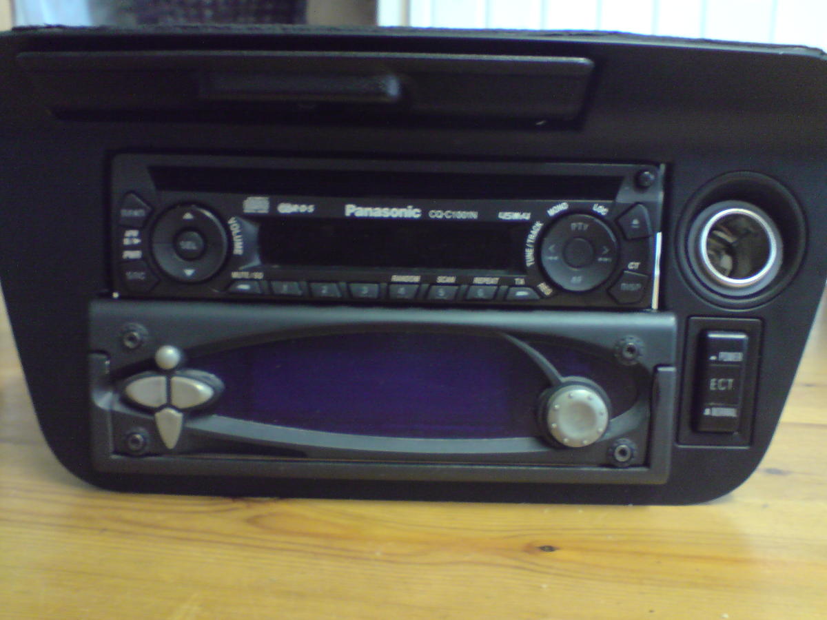

ok, we're in the dash, well almost, just got to actually put it all back together now it's been made to fit on the bench!
i have just one concern.....
i've slid the empeg underneath the old panasonic junk (cd radio) which i was planning to slave into the empeg for radio or cd's not yet on the peg, my concern is whether or not the empeg will overheat, the radio was still quite hot when i took it out, even after 5 mins or mso it was pretty warm.
the empeg sit pretty tight against the unit above it (no room to do anything else) and as such, the vent for the empeg has little to no space to vent heat, combined with the heat from the top unit (though i guess this will be less once it's no longer driving speakers) will make it overheat,
any suggestions?
my only answer short term is to simply remove the top unit and go empeg only.
i could switch them so the empeg is on top and can vent but, the heat from underneath will surely be worse than from above?
would appreciate a quick response if poss!
cheers,
Hugh
Edited by crazyplums (10/08/2009 12:49)
www.dragon-signs.com
#325010 - 10/08/2009 15:12 Re: display extenders [Re: crazyplums]
Posts: 31630
When doubling up stereos like that, heat is definitely going to be worse than it would be if it was just the 'peg.
If it were me, I'd make sure you've got a cooling fan in the 'peg.
The over/under order is good, with the 'peg on the bottom. If there's enough of a gap above the 'peg so that the cooling fan can exhaust, you're good. Check for that.
#325012 - 10/08/2009 15:57 Re: display extenders [Re: tfabris]
crazyplums
Registered: 29/12/2006
Posts: 159
Loc: E.Sussex, UK
thank you Tony,
there is very little room between the two players, maybe 4-5mm if i can wedge something between them to raise the back of the radio, maybe i'll just remove it and install the radio either in the glove box or even under the ashtray, i guess it won't be used much once the peg is installed anyways,
as i've gone to the trouble of setting it all up already (bastardising the connecting harness to suit both radios and speaker config) is it worth trying out to see if it gets too hot? the heater vent is not very close to either radio.
will the cd get very warm now it's not driving speakers?
ps, what's the thin pink wire for on the back of the peg? it's the only one not labelled and not mentioned in the manual!
thanks again,
Hugh

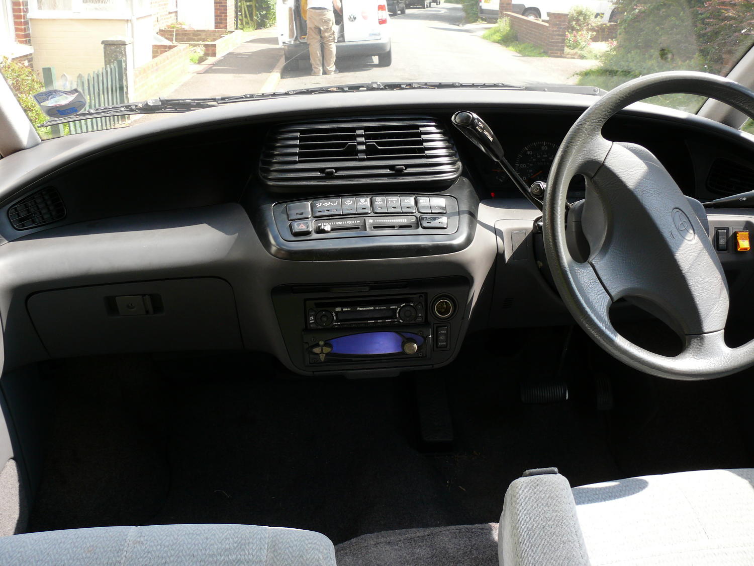

#325027 - 11/08/2009 11:52 Job Jobbed! [Re: Robotic]
crazyplums
Posts: 159
Loc: E.Sussex, UK
well, she's in (are empegs female?), the big space behind the peg and head unit is now not so big with all the associated wiring for two units, to get it all in neatly i had to remove all the climate controls and the black dash panel which runs from one side of the car to the other, i could then get my hands in and move the wiring out of the way and neatly move it evenly around the space available,
I checked it powered up and that it received the signal from the head unit (which it did) before finally connecting up the amp and playing a large range of music genre to try and find a happy medium on the sounds from the amp.
sounds great! put the dash back together and job done!
the amp did cut out a couple of times -maybe a second or so- at too high a volume, otherwise my only concern was how hot the amp was getting / got after about half hour of play, will measure surface temp later and see what it giving off, i wonder if it's because i'm initially running the amp (2/1 channel 300w and through a kenwood 3 way crossover) on 2ohm -fr +rr making one channel each side-, the amp specs say it's fine but perhaps this is making it work harder and therefore get hotter..
if i go with another amp for the front speakers, as planned at some stage, would i be better to run a seperate battery? also, i see mentioned somewhere, the use of a capacitor to buffer high demand of Voltage, would this be necessary on 2 amps?
cheers,
Hugh
ps, my only worrying moment was when the winking led continued to flash after i turned off the ignition, thought i'd wired it wrong and was going to have to pull the dash apart again!
aaa peg install.JPG (128 downloads)
Edited by crazyplums (11/08/2009 11:54)
#325029 - 11/08/2009 12:52 Re: Job Jobbed! [Re: crazyplums]
Looks very nice!
