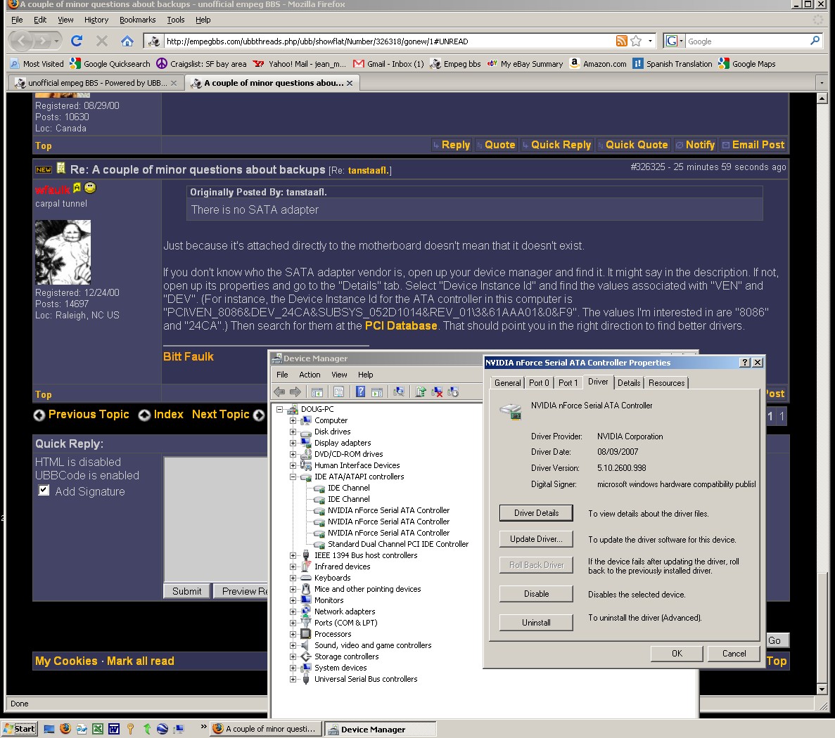

#326327 - 24/09/2009 14:31 Re: A couple of minor questions about backups [Re: wfaulk]
Posts: 5553
open up your device manager and find it.
Is this it? (see attached...) All I need to do is click on the "Update Driver" tab?
I am guessing that the "NVIDIA/nForce Serial ATA Controller" line shows up three times because there are (at the moment) three SATA discs running? (I don't have the external one powered up at the moment.)
What happens if the update fails and none of the discs (including the "Windows" disc (it's an 80 GB IDE disc) with the OS and associated files) work? It'll be pretty hard to click on that "Roll Back Driver" tab then... am I putting all my eggs into what appears to my uneducated eye to be a pretty scary basket? We all know that Windows (especially Vista) is a rock-solid, completely stable and robust operating system, and the chances of anything ever going wrong are laughably minute. But still, being no doubt unjustifiably paranoid, I can't help but wonder.
Am I on the right track here?
#326328 - 24/09/2009 14:52 Re: A couple of minor questions about backups [Re: tanstaafl.]
There are three most likely because there are three controllers on the motherboard.
You still need to download an updated driver first, and from perusing nVidia's download site, there's not enough information on that screen for me to immediately figure out what you need to download.
However, assuming that it's an nForce 9-, 7-, or 6-series, here are links to the Vista32 drivers and the Vista64 drivers.
If anything goes wrong, you should still be able to boot into safe mode. Vista does still have a safe mode, doesn't it?
Edited by wfaulk (24/09/2009 14:53)

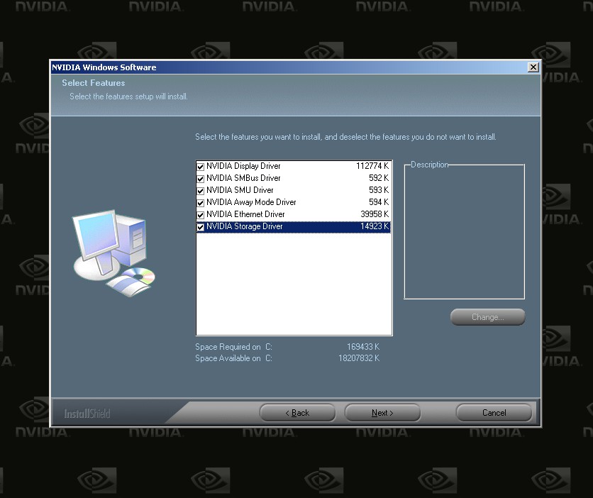

#326332 - 24/09/2009 18:30 Re: A couple of minor questions about backups [Re: wfaulk]
Posts: 5553
I downloaded the driver install program, and started running it. I am stopped here (see attached) wondering which, if any, or all, of these do I select? None of the options seem to have anything to do with SATA drivers, unless it is the nvidia storage driver?
#326333 - 24/09/2009 18:34 Re: A couple of minor questions about backups [Re: tanstaafl.]
Yup
#326334 - 24/09/2009 18:38 Re: A couple of minor questions about backups [Re: tman]
Posts: 5553
Yup
OK, I'll select that one, and deselect the others. Since I'm not having problems with them, I'm firmly of the opinion "If it ain't broke, don't fix it."
What took so long to reply? It was nearly three minutes! smile smile

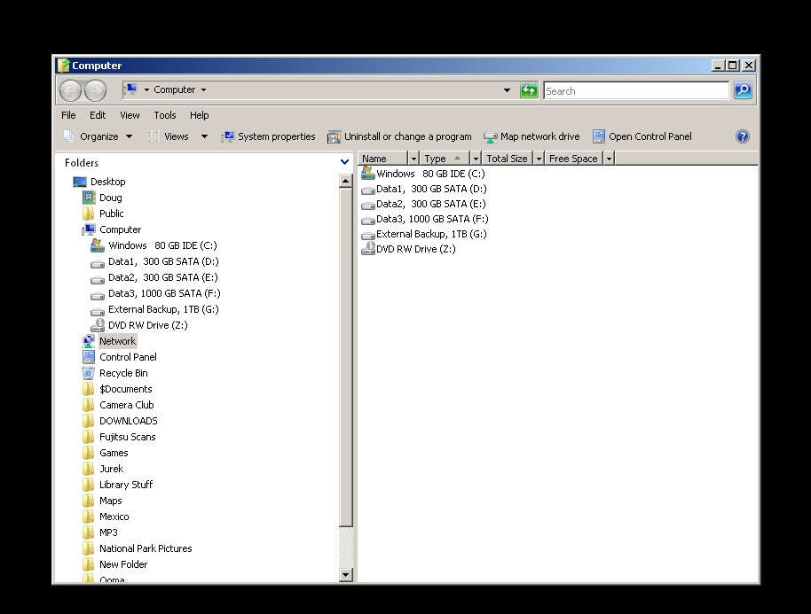

Below is a screen shot taken without rebooting! Hooray!!
The instructions that came with my NexStar external SATA dock said to always use the "Safely Remove Hardware" utility before removing or powering off the external drive. I always wondered if that was really necessary? It seems to be a moot point now, because with the new driver installed that utility is no longer available in my system tray. Should that concern me?

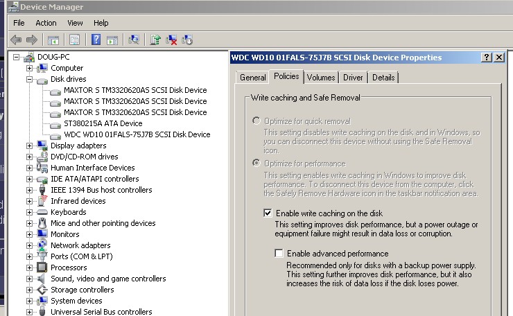

#326345 - 24/09/2009 22:56 Re: A couple of minor questions about backups [Re: wfaulk]
Posts: 5553
Open its properties and go to the "Policies" tab. There should be options there to select between "quick removal" and "performance".
All of the hard drives look like the attached -- the options I want are all greyed out. Unchecking the one box that is accessible only unchecks the box, nothing else changes.

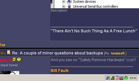

#326346 - 25/09/2009 00:37 Re: A couple of minor questions about backups [Re: tanstaafl.]
And you see no "Safely Remove Hardware" icon?
#326347 - 25/09/2009 00:46 Re: A couple of minor questions about backups [Re: wfaulk]
Posts: 5553
See attached. That's all I have in my system tray. The icon on the far left is my Samsung Printer utility icon. The next two are AVG, then ClipTrak, then Active@.
The "Safely Remove..." icon went away when I installed the new driver.

Just how important is it to Safely Remove a drive if I am sure that it is not being written to? The only time the external SATA drive is active is when I am actually running my backup software.
#326367 - 26/09/2009 00:58 Re: A couple of minor questions about backups [Re: tanstaafl.]
Very. With it optimized for performance, there's no way to know what's actually been written to disk and what's still hanging around in memory.
Chances are that you'll be fine if you wait a good while after using the disk, but there's no way to be sure.
