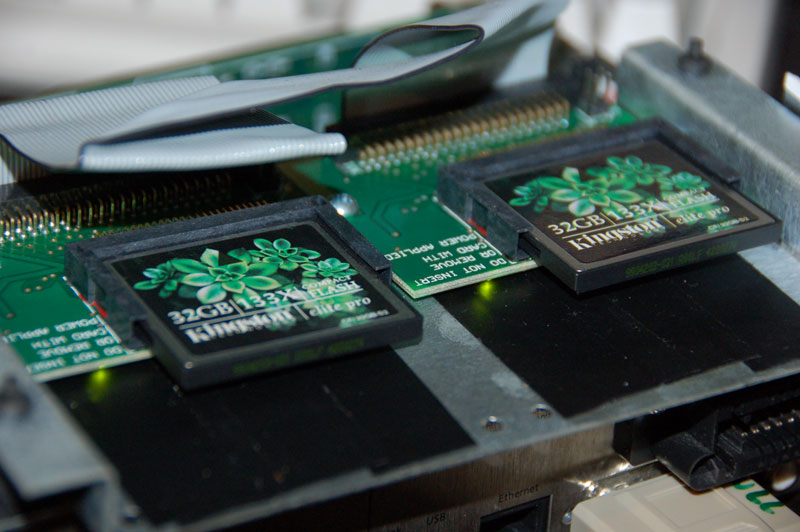

Yeah, it's beautiful but it isn't working reliably. Very often, the slave drive will fail upon boot with the "lost interrupt" error. I can't tell you how many times I flashed the drive builder on the player last night, but I spent 5-6 hours trying to get thing working right. It doesn't matter which adapter I designate slave or which card I stick into which adapter. 9 times out of 10, the thing won't boot correctly and HDB is always what gets hung-up. I checked the cable multiple times and even swapped for a new one. My list of possible reasons is: - The CF cards may not be 100% compatible being accessed as IDE devices (probably a long shot).
- The IDE-to-CF adapters may not be compatible with cards over a certain size. They appear to be dumb pin converters, but I could be wrong.
- One of the adapters may have grounded out on the drive carrier. There is electrical tape along the bottom as shown in the photo, but it's easily pierced. When removing the 8GB cards, the adapters became a little loose. I didn't notice this until later when I tried tightening-up the screws holding the CF adapters to the drive carrier.
Maybe I'll do some more detective work in the future, but for now this empeg has an old 60 and 80GB drive in there getting filled with tunes.

It doesn't matter which adapter I designate slave or which card I stick into which adapter. 9 times out of 10, the thing won't boot correctly and HDB is always what gets hung-up. Not all CF cards will ever work correctly as "slaves". I think the original CF spec assumed master/single drive configs, but my memory is fuzzy about that now. The CF cards may not be 100% compatible being accessed as IDE devices (probably a long shot). Not an issue. "IDE" mode is the normal access method for CF cards. The IDE-to-CF adapters may not be compatible with cards over a certain size. You can rule that one out, too. The same pins are required for any size drive, from 1MB to 2TB in size. So it's not a drive size issue. One of the adapters may have grounded out on the drive carrier. That's a good and likely possibility, and not too difficult to troubleshoot. I do have a couple of empegs here with dual 16GB cards installed and working. Cheers

Double-stick foam tape might make for a better spacer / insulator under the cards.

HDB is always what gets hung-up. Another possibility is that the master/slave jumpers on the carriers may not be totally correct -- eg. perhaps there's a solder bridge somewhere that needs to be cut for the jumpers to work properly.

Foam tape was my first thought too.
But a spacer, or stack of washers, between the tray and cards would also work.
