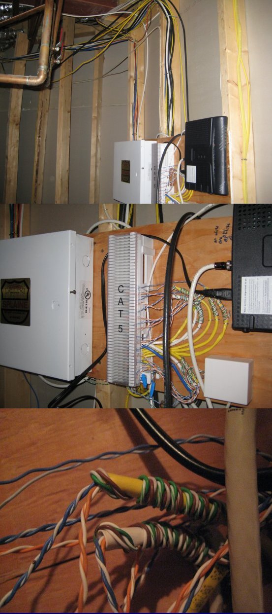

#327731 - 24/11/2009 04:32 Re: Home wiring [Re: Dignan]
Posts: 12320
Sorry to bring this thread back, but I felt the need to update it now that the home has been officially purchased and my mom will be moving in tomorrow. I was finally able to look at the wiring for more than a couple minutes and have pretty much figured out at least what I need to do to correct things, even if I'm not so sure why things are the way they are at present.
First off, take all that stuff I said about the speaker system out of the equation entirely. It's a completely different set of wires. Simply speaker wires throughout the house.

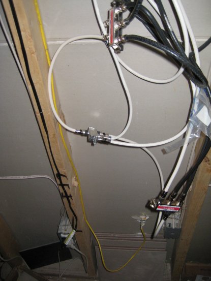

I've attached pictures of the wiring and an example outlet that's actually directly below the main jumble of wires.
First off, I pretty much have a full count of Cat5e wires coming out of the ceiling. I count about 9 jacks in the home, and 9 or 10 wires total. These wires all come out of the ceiling, travel behind the wood panel attached to the studs, and back up the bottom front of the panel and into a patchblock (I guess). The really confusing thing to me is that every single cable only has 2 of 4 pairs terminated in the block. The other 2 pairs are simply wrapped back down around the cable as pictured.
But after seeing this I decided hey, that's fine, I'll just snip everything, run it back up a little ways to give me some slack, put some RJ45 caps on the ends, and plug them all into a switch.
The only thing I'm worried about at this point is whether all the actual jacks in the house are wired correctly. I worry whether all the pairs are terminated or if they're in the right order.
Anyway, I felt I should update this post. If you can think of anything at all that I might be overlooking, I'd appreciate a heads up. I'll be looking at a few of the wall jacks tomorrow and putting some of those caps on. Wish me luck!
#327735 - 24/11/2009 06:14 Re: Home wiring [Re: Dignan]
StigOE
The reason for this is possibly that you only need 2 pairs for 10Mb and 100Mb. Instead of cutting the wires, why not just loosen them and re-wire everything with all 4 pairs, and then just use stubs from the patchpanel to the switch. Then you can use GigE. In that case, also make sure that the jacks are wired correctly.
Edit: I noticed that they have used a 'wrong' pair in the wiring. They've used the blue pair, which normally is connected to pin 4 & 5. The 'correct' pair should be the green pair.
Stig
Edited by StigOE (24/11/2009 06:22)

The reason you're only seeing two pairs of each cat5 cable terminated is because you're looking at a house wired for telephone use only. One pair for each of two telephone lines.
You can usurp the full set of wires for Ethernet if you like. Make absolutely sure you know the correct pair ordering when you terminate your jacks.

Don't just put RJ45's on, order a CAT5e patch panel and punch down tool from Deep Surplus. When it comes, sacrifice one of your patch cables and try it out a few times, it's not dificult but you'll get much better with a few practice goes. Mount the thing high enough to give you enough slack, and punch 'em down. Then you can use nice short disposable patch cables from the punch down block to the switch. You can tear up patch cables and make one that'll let you use the jack for phone if you want in the future.
The only issue that you want to be careful of is rewiring the jacks in the wall. If you've got enough slack when you take them out of the wall, cut the end off and punch them down again using the 568B guide that should be on the jack. If you don't have enough slack, you'll have to hope you can figure out a custom wiring pattern that keeps everything on the correct pairs.

#327745 - 24/11/2009 14:45 Re: Home wiring [Re: matthew_k]
Isn't that white rectangular thing in the picture a punch-down panel? Maybe not I guess, it's hard to tell from the photo and I can't see the other side to see if there are any jacks on it. It's probably just a splicing panel I suppose.
Also to note, when punching down your wires, don't leave so much untwisted and unsheathed wire. It looks like ass. smile

#327747 - 24/11/2009 16:01 Re: Home wiring [Re: hybrid8]
Actually, it's in violation of the Cat5 spec, which requires that the wires be twisted at a certain pitch. It's actually possible to make the cable fail to be able to support higher speeds by doing that. You see a lot of phone installers wire connections that way, though, as there's no requirement in POTS/tip-and-ring for any twisting at all.

Yeah, Deep Surplus is my go to place for bulk wiring supplies. If I need something terminated, I usually look to monoprice. Home depot is always a store of last resort for me. At least at orchard supply they'll be nice to you while you pay those prices.
It looks like a 66 block to me, which are pretty much phone only. 110 blocks are punch down blocks for network wiring, but they're a pain to deal with.

Posts: 12320
There's a way to do it right, there's a way to do it wrong, and then there's a way to do it fast enough to get it prepared for the Fios guy coming the next morning.
Again, it all came down to the fact that the previous owners never let me in to take a look at the wiring, so I was going on about 2 minutes of inspection. If I'd had even a week to prepare I probably would have gone all out and gotten the patch block and everything. Instead, I had no choice but to wait until yesterday to check it out, with Verizon coming two days later.
I was just thankful that I had just enough Cat5e connectors for all the cables. I should have cut them back a tiny bit, but didn't want to lose the slack. Instead I unwound that insane wraparound on the cables you guys noticed (what was with that?), and just snipped the wires and put the caps on them. I'm actually pretty good at it smile
Then all I was able to do was plug all the lines into an 8-port switch, and bring a cable tester around the house to see if all the lines were wired correctly.
Really, all this was moot because we'll have wireless in the house. The problem was I need to put the main wireless router in the office three stories up, and I didn't know which line went where.
Anyway, it's all good now (fingers crossed).
