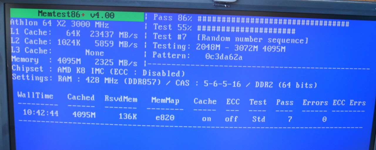

The new stick might be bad. You're putting it into a different slot so the bad part will end up somewhere else in the memory map so it might not trigger whatever breaks your video. If you swap it back and the video dies again then I'd get that memory stick swapped out.
You should run a memory tester like memtest on your PC. Download the zipped ISO and burn it as a CD image to a CD then boot off it. Just leave it running overnight.
Sounds good in theory... except see my other thread about my CD burner no longer burning CDs. It will burn DVDs, however, so I have burned it to a DVD and will see if I can boot off of that. I'll have to go into my BIOS and change the bootup sequence to start with the CD player...
I have an old memtest.exe file in my utilities folder that I ran, it made three passes with no errors, but of course it wasn't checking memory in use by Windows, and I'm not at all sure it was looking at all four gigabytes of RAM.

As always, Bitt, I think you nailed it. An overnight memory test suggests that everything is OK.
Cool. You should be good then if it passes the basic test in memtest.
