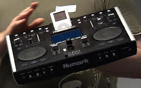

#341739 - 01/02/2011 00:56 Re: 2 TB hard drive advice wanted [Re: drakino]
Posts: 14510
I wonder which interface the Numark / Akai Digital DJ decks were using then?
And ditto for the iTunes-style interfaces used in (?)Rhythmbox et al. ?

#341744 - 01/02/2011 02:03 Re: 2 TB hard drive advice wanted [Re: mlord]
The regular iPods like in the photo are USB mass storage. Its just the iPod touch, iPad and iPhone that need the special USB mux driver and apps that talk over it.
If your app knows how to then it can talk to the Apple File Connection service for limited access to the media area of iPod touches, iPads and iPhones.
