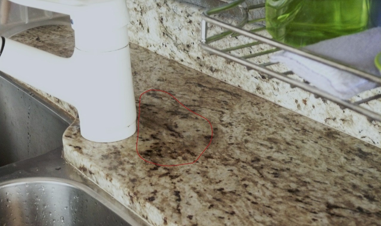

I have granite counter tops in my kitchen and wonder if I haven't messed one of them up.
I had a bottle of dish detergent sitting behind the sink, and it trapped water beneath it for several days. When I moved it, the granite was dark and discolored where the bottle had been. Over the next week or so the darkness faded considerably, and today looks like the photograph below.
If I leave it alone, will the discoloration gradually fade away completely? Is it caused by moisture actually impregnating the surface of the granite? If it doesn't go away is there any remedy? And is there anything I should have done (other than not leave a wet bottle sitting there) to prevent this?

Generally speaking, yes, the water will eventually evaporate and the granite will get lighter. Now, if you had food stains (wine, berries, etc.), it's another matter entirely. (Random Internet advice that worked for me: making a slurry of flour and hydrogen peroxide, smearing it on, covering with plastic wrap, and leaving for a few days. Your mileage may vary, try in an out-of-the-way spot first, etc.)
I've tried a variety of granite sealants, and none have particularly prevented the very issue that you're seeing for yourself. If you can find better, I'd be quite curious.

If it's just water, heat will pull it out, otherwise It might set the stain.
I don't think I would try heat.
I recall seeing a video on tv about using poultices on granite.
googling for granite cleaning poultice turns up relevant links.

At the risk of stating the obvious, water isn't dark. Micro-organisms growing in water are dark. Any remaining darkness is probably the remnants or spores of shrivelled, dried-up, died-of-thirst micro-organisms. What you need is some sort of bleach strong enough to bleach organic material but not strong enough to corrode granite. Whether or not hydrogen peroxide falls into that happy medium I couldn't myself tell you, but if the Internet says so it must be true...

From everything I've ever heard, Dan's suggestion is what you're supposed to do. I believe it works for marble as well.
In fact, they talked about this on the last season of This Old House. They were installing marble countertops which stain even easier than granite (particularly the kind of marble they were installing). The demonstration was more aimed at getting rid of a wind stain, but I'm pretty sure they said it applied to anything. They applied the slurry, covered it in plastic wrap, taped the wrap to the counter (with blue painter's tape, I believe), and left it for like 2-4 days.
*edit*
It isn't from the episode I was talking about, but the This Old House website has instructions.

I think I may respectfully (very respectfully!) disagree. Water may not be dark, but I think that granite saturated with water may well be.
The stain in the photograph is MUCH lighter than it started out to be. I had another stain caused by leaving a wet pot lid on the counter top. The stain was a thin ring where the lid sat on the granite. Over a period of weeks this stain disappeared entirely, leaving not the faintest trace as the water dried out.
So, I have hopes for my dish detergent bottle stain, it seems to be getting better on its own, but the flour and hydrogen peroxide trick is there as a backup.
