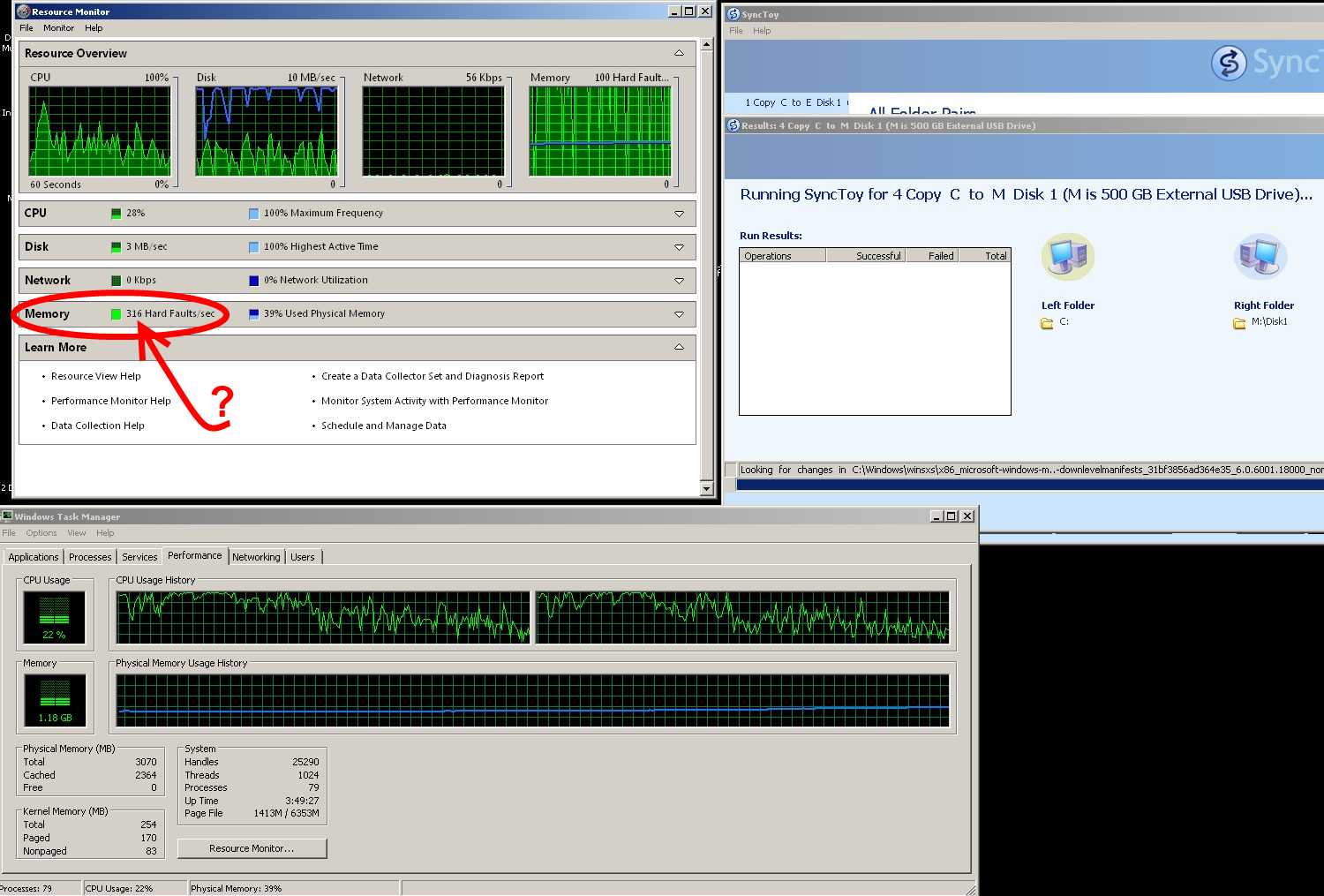

Running backups overnight, the backup program slowed and finally quit ("program not responding..."). A little bit of experimenting seemed to show that any program with high disk I/O exhibited similar behavior.
The first attached screen shot seems to point toward the cause of the problem, but I am beyond what little bit of expertise I have in these matters.The shot was taken copying C:-->M:, but the failure actually occurred while copying F:-->L: which would suggest that it isn't a problem with a specific drive.
Is this as serious as it looks? MEMTEST.EXE showed zero errors after running for an hour.

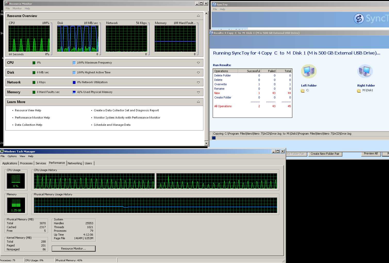

The second screen shot shows what things look like when the backup application stalls. It looked pretty much like this for about five minutes before I captured it.
Right-click on the picture and select "View Image" to make it more legible.
Does anybody know what is going on here?
Depends on what you think it looks like.
It does not mean that your memory is faulty. In this context, "fault" means that the information that was requested was expected to be in RAM, but wasn't, because it had been paged out to virtual memory on disk.
It does mean, however, that you have less RAM than the processes you're running concurrently need. It still works, nominally, because the OS is able to move data from RAM to disk when it needs more RAM for something else, but a hard drive is many orders of magnitude slower than your RAM.
This is normally not a big deal when you have multiple programs running concurrently when they're not really doing that much all at the same time. (For example, if you have Photoshop open with a huge image, it's okay for it to page all that memory out to disk when it's not being used, because you're doing something else. When you get back to Photoshop, it'll just pull it back into RAM and page out what you had been working with.) But when processes all actively running at the same time need more RAM than you have, it starts using the hard drive as intensively as it uses the physical RAM. Or tries to. And it's incredibly slow.
So: run fewer programs or buy more RAM.

Yeah, what Bitt said. "Fault" doesn't mean faulty in this case. It just means that there was a ram<->disk swap happening, which happens all the time on computers, even when things are working normally.
He's got the maximum possible memory for a 32-bit system, and this is an overnight backup (i.e., not a lot of other programs running).
A backup program should not cause a machine to run out of RAM and slow to a halt. Something else is going wrong here, something OS-related or software-related.

That's what was confusing me. I can't imagine how you're running out of ~3.5GB of RAM when you're not even using the computer.
About 2.7GB (if I'm reading it right -- it's quite small) is being used for caching. This is expected; Windows Vista (and 7) aggressively use memory for caching.
And, as Peter says, those page faults could well be caused by memory-mapped I/O. This is perfectly normal.

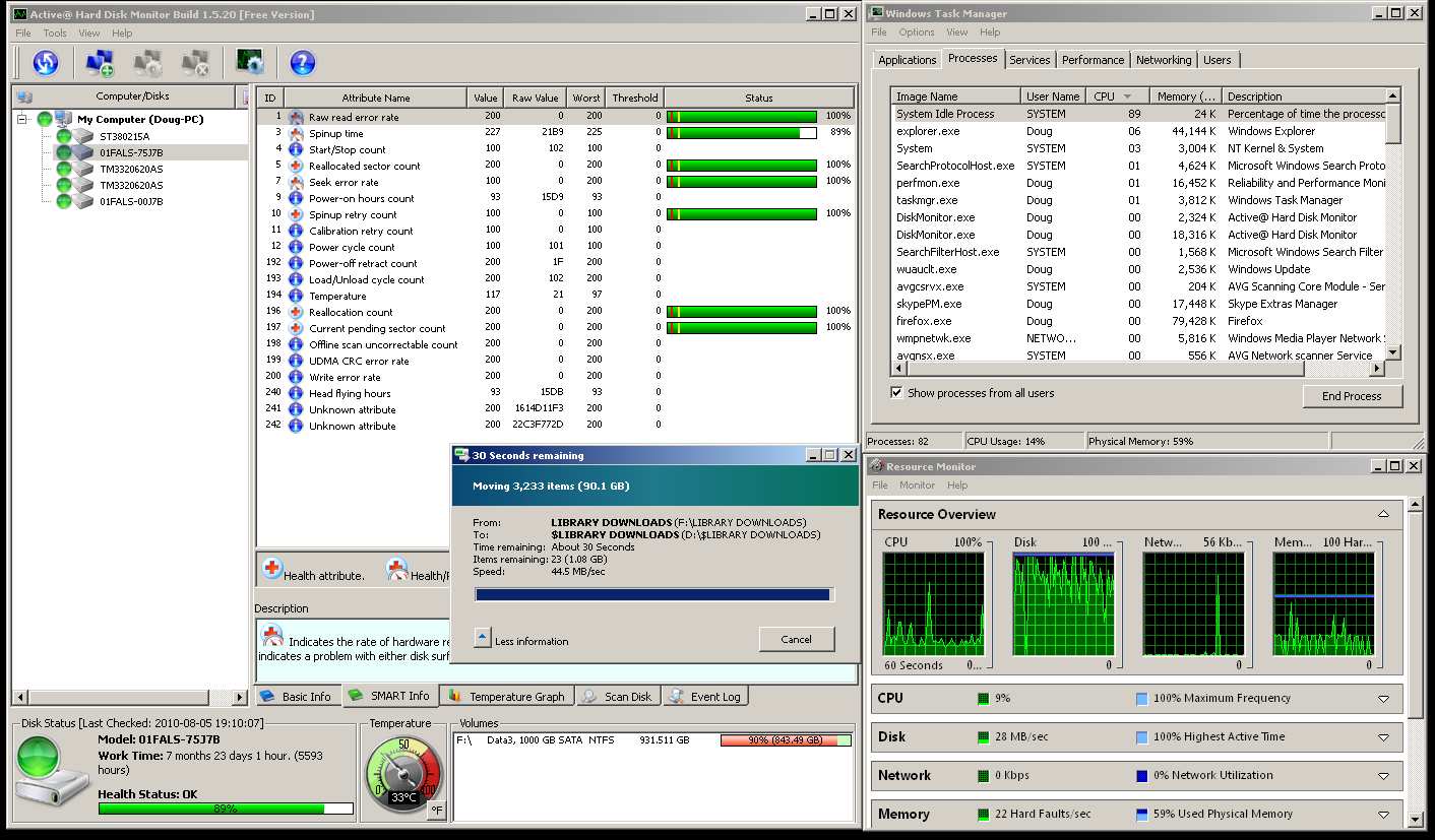

Here are pictures of source and destination drives.
I think the hardware is OK, but there is something very flaky going on with the computer as a whole. Right now it works for about a minute, then freezes: no mouse, no keyboard, and when the diagnostics are on screen, no disk activity, no memory activity, then it will start working again. It has frozen twice in the process of typing this post.
Neither one of my backup programs will copy more than a handful of files before it freezes up, yet Windows Explorer copied 90 GB of files at an average rate of around 50 MB/sec without any problems at all.
I ran an 8-hour MemTest with zero errors.

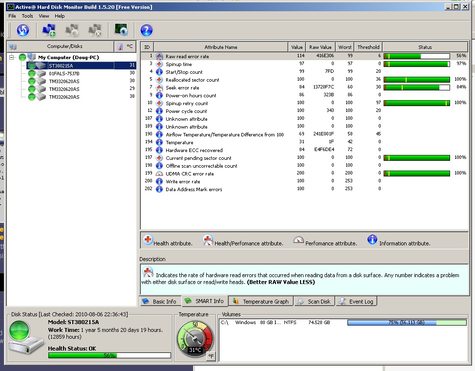

Your D: drive error rates are less than healthy.

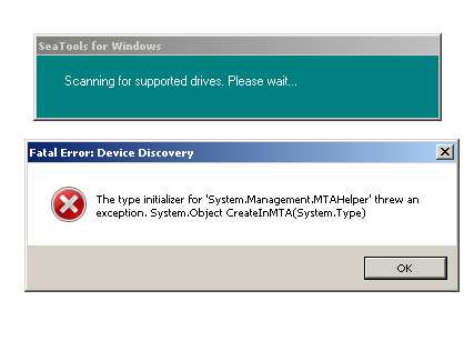

Download SeaTools and see what it reports. (It appears to be a Maxtor drive, and Seagate owns Maxtor now, and SeaTools claims to support Maxtor drives. If it's not a Maxtor drive, try and find a diagnostic utility from whoever the vendor really is.)

#335845 - 06/08/2010 14:17 Re: Memory problem? [Re: wfaulk]
Not too much, as it turns out... frown

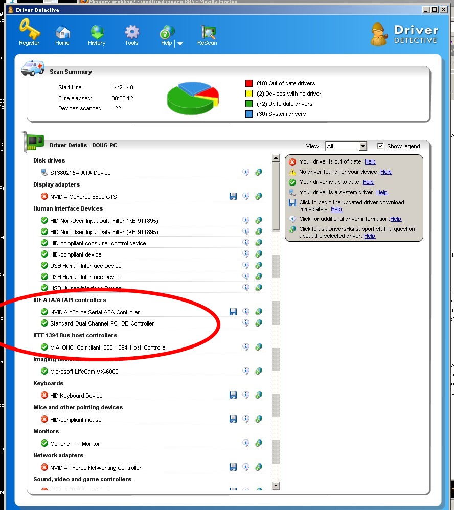

Apparently...
There are some outdated drivers, but in every case they are for equipment no longer installed, or for equipment that is (IMHO) operating properly so why go looking for trouble?
On a related note... what do I do to convince my computer that the HP ink jet printer, the on-board sound, and some other things as well, are no longer connected and never will be again? Apparently the drivers for them are still kicking around, confusing my Driver Detective program.

The HP printer drivers are probably in the add/remove programs screen somewhere, waiting for you to uninstall them.
If the onboard sound is disabled in the system BIOS but is still showing up in the device manager, then deinstall the drivers from the device manager via a right click.
If your only complaint is that these things show up in the Driver Detective screen: Fugheddaboudit. Those files don't go "active" until you plug in the device in question, and having the files sitting there shouldn't hurt anything. In what way, exactly, are they "confusing" driver detective?
#335855 - 06/08/2010 18:17 Re: Memory problem? [Re: tfabris]
Only in that they show up as outdated drivers, prompting me to do something about them. I guess the only real "confusion" there is mine. I just like things neat and tidy, is all. smile

My computer is deteriorating rapidly, to the point where trying to copy more than a few megabytes from one drive to another, any drive to any other (there are six hard drives in the system: 4 internal, 2 external) causes a lockup. All I/O activity ceases for about 40 seconds, then I can hear the heads do a rather noisy seek, the CPU activity spikes to 100%, and then things will resume for another two or three minutes. Unless (as frequently happens) the program doing the transfer times out with a "Program not responding" error.
Two different backup programs (Microsoft SyncToy, and Karen's Replicator) exhibit this behavior, as does my disk defrag program (Auslogics), as does Windows Explorer.
Occasionally I get the 40-second lockup even when not engaged in heavy disk I/O.
Unless someone can come up with a solution, I may have to Nuke and Repave. I do not want to do that - my "Control Panel --> Programs & Features" has well over 100 items in it, and that's after I've gone through and uninstalled everything I don't use. If I have to, then I will upgrade to Windows 7, 64-bit, which means learning a new operating system. And no, Linux isn't an option for me, of that 100+ selection in Control Panel, I suspect that the majority don't have Linux analogs.
Right now my backups are a mess, since the problem began part way through the backup procedure. I've run these backups many times in the past without problems, and I haven't changed anything other than to add more data to be backed up. Fortunately none of my data is on the system (i.e., C:) drive, just all the applications. My data on the D: drive is solid, my 1-TB F: drive not so much.
The fact that I/O activity on ANY drive causes lockup suggests that there is no single drive causing the problems. Or does it? I guess that if any one drive was doing it, it would be the System or C: drive. Do you see anything scary in the attached picture?
I've been fighting this for two days now and am beginning to become discouraged. I really don't know if it is hardware or software causing the problem.
edit: It's not hardware. I should have thought of this before... I went to a DOS prompt and used XCOPY to copy files. It is copying as I write this. It has copied 10 GB without a problem and is still going strong, looks like it is averaging about 60 MB/Sec. Now up to 16 GB copied. 20+ GB as I submit the post.
So, what is borking my disk I/O in Windows, but letting it run full speed in a DOS window?
edit #2 FOUND IT. (I think...)
It looks as though any time I have my Vantec external dock powered up with a hard drive in it the disk I/O for the entire computer goes teats up. Two different hard drives cause nothing but trouble. When the dock is powered down, everything runs like it is supposed to. Of course, since the dock is my major backup tool, it was always on when I was trying to figure this mess out. I strongly suspect that the dock is the problem, not the hard drives themselves.
It's the dock. Or maybe the SATA cable. Hey, maybe the adapter that the cable from the dock plugs into. Maybe the cable between the adapter and the motherboard. Maybe the SATA plug on the motherboard. Tomorrow I'll open it up and re-seat the cable where it plugs into the motherboard, see if that helps. I am not optimistic.
Hmmm... there's also a USB connector on the dock. If it fails to work on USB, that will be a good indication that it is the dock itself, and not any of the other possible things. And if it does work on USB, I'll just run it that way instead of SATA. It doesn't matter if it's a little slower, I run the backups overnight anyway.
edit #3 Yes, works just fine on USB.

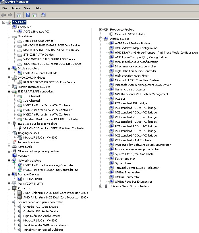

Out of curiosity, what motherboard or chipset do you have? A screenshot of Device Manager with the System section may help identify it (I think, don't have Windows handy at the moment to reference).
And does the external Vantec dock plug into eSATA directly into the motherboard, or into some sort of eSATA PCI card?

I can't tell what nForce chipset you have, but it looks like you do have one based on the NVidia reference there. Main reason I asked is that the I/O degradation sounds eerily similar to the failures I've seen at two companies using NForce powered Dell XPS machines. The difference here is the Dell's all used NVidia Intel chipsets, not AMD. The reason for the failure was a bad system design that dumped heat from the CPU directly onto the chipset. As the system aged when being used to compile code all day or sit in an office overnight without air conditioning, the chipset would just start acting oddly, usually slowing or delaying IO to the point of the machine being useless.
I can't say for certain this is similar to your problem, especially since it went away when you stopped using the eSATA port. I'd still recommend double checking the chipset though internally, make sure it gets enough cooling, and doesn't have a ton of dust and such on it. To identify the main chipset, it's going to be a component on the motherboard that has a heatsink on it, usually located somewhere near the CPU or memory. The heatsink may have it's own small fan, though the heatsink/fan setup will be much smaller then the CPU one.

Here is a more useful screenshot.
#335888 - 07/08/2010 14:42 Re: Memory problem? [Re: tanstaafl.]
Yep, the second shot of device manager confirms the NForce chipset is running your SATA ports too. Some motherboards have other storage controllers embedded, though this tends to be for extra ports above what a chipset can support, or for adding in newer standards that haven't been universally adopted yet in motherboard chipsets.
