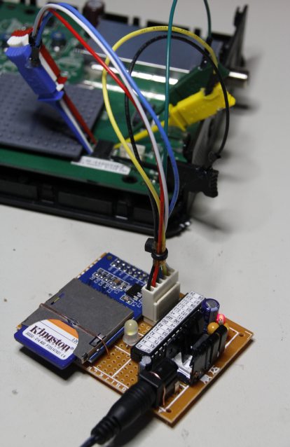

The cable-modem reflashing experiment has been a decent success, with over 30 modems repaired to date. Things seem to be tapering off now finally, which is a bit of a shame. For every modem that "finds me", there are about 100 affected ones that don't. Those unfortunate ones most likely end up getting junked.
Here's the latest version of the flashing rig, totally standalone and turn-key. Just hook it up to the modem, plug the modem's PSU into the rig, and watch the blinkin' LEDs.

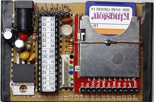

After updating around 50 or so modems, I finally soldered up a couple of the rigs. One went to a friendly ISP, who traded a DOCSIS 3.0 cable modem for it. The other continues to be used here, about once a week or so now. Over 60 modems re-flashed to date.
Description: Soldered version of the rig.
