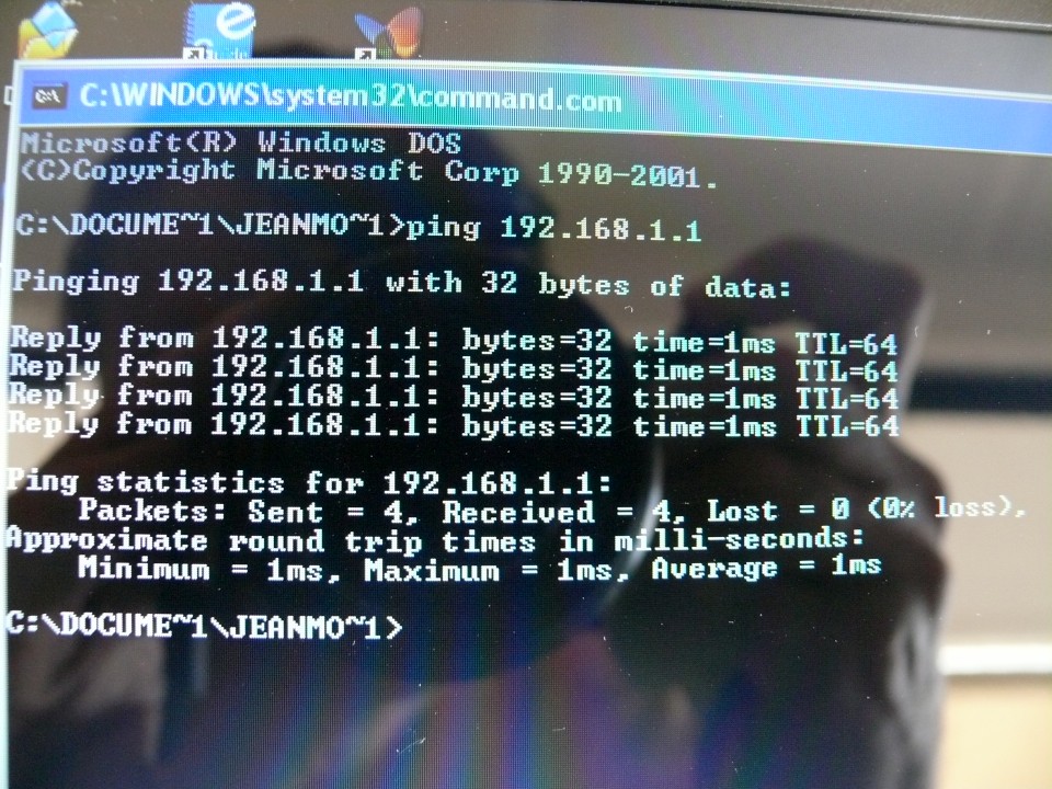

Do you know if your WRT54G has an IP 192.168.1.1? If so, Start->Run->CMD and the run "ping 192.168.1.1".
Apparently it does. (see attached photo)

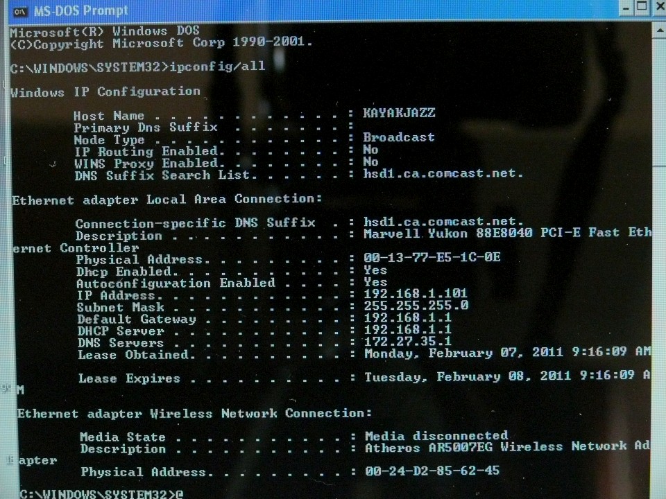

Whilst you are there at the command prompt, run "ipconfig /all" Given you don't have a working network, perhaps take a photo and post?
See attached photo

Hopefully you can see something in the attached photos that will give a clue.
Don't be too critical of the photo quality. I live (literally) in a glass house with bright sunlight streaming in and lighting up the very reflective screen on the netbook. Makes things difficult... smile

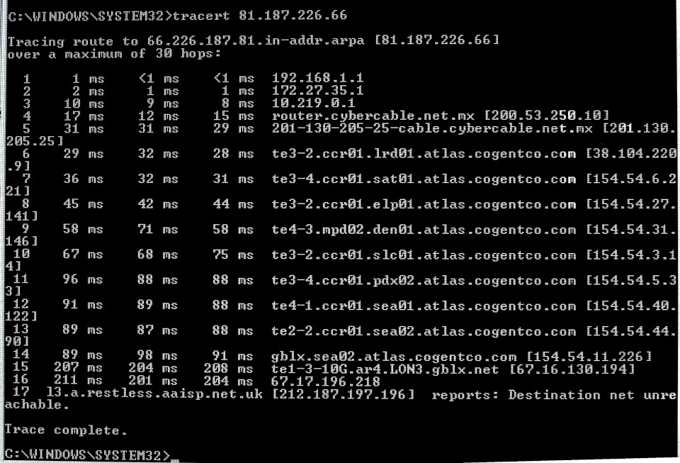

now try "tracert 81.187.228.66"

Attached is the tracert photo.
Thank you for the help! I am way over my head with this stuff!

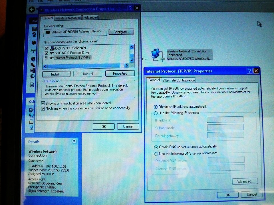

#342032 - 07/02/2011 17:19 Re: Why won't SWMBO's netbook connect to the internet? [Re: peter]
Control panel
Network connections
right-click your connection and click Properties
double click on the entry for TCP/IPv4
make sure the radio buttons for obtaining IP and DNS automatically are checked
#342039 - 07/02/2011 18:09 Re: Why won't SWMBO's netbook connect to the internet? [Re: Dignan]
Posts: 5549
OK.

#342045 - 07/02/2011 19:40 Re: Why won't SWMBO's netbook connect to the internet? [Re: tanstaafl.]
It would have been so much better with a DSLR wink
LOL! smile
That tracert photo shows you are in facet connected to the internet correctly. You are resolving IP addresses into domain names, you are going from hop to hop... Problem is not in TCPIP, and it is not in radio association with the WAP.
I think the issue may be in firewall or some browser setting. I suggest you
1. Try to disable windows firewall, just for a test: control panel, windows firewall, disable. - edit: sorry, I read in your first post you already did so.
2. Try a different browser (not permanently, fo course), just to see if it is browser specific.

#342081 - 08/02/2011 00:23 Re: Why won't SWMBO's netbook connect to the internet? [Re: tanstaafl.]
I don't mean to rag on you Doug, but, while I expected a screenshot of text-only information, I really didn't expect for it to have been taken with a camera.
#342086 - 08/02/2011 01:17 Re: Why won't SWMBO's netbook connect to the internet? [Re: wfaulk]
Posts: 5549
But what other option did I have? I guess I could have done a printscreen, saved it to a MS Paint file as a .jpg, then copied the .jpg onto a flash drive, brought the flash drive over to my computer and copied the file onto my hard drive, then attached the file to the bbs post. Without any connectivity on the netbook, there was no easy way to get the data to the bbs.
#342091 - 08/02/2011 03:33 Re: Why won't SWMBO's netbook connect to the internet? [Re: tanstaafl.]
Oh. Um.
I assumed you still had LAN connectivity.
Yeah…. Yeah, that's my story and I'm sticking to it.
