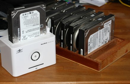

Powering all the discs up once a year would probably be a good plan. You probably want one of this drop in hard disc adapters.

Powering all the discs up once a year would probably be a good plan. You probably want one of this drop in hard disc adapters. Yeah, a pop-up toaster style of dock, eSATA or USB3 interface to the PC, and a pile of bare drives (in their original anti-static bags). 2TB WD "Green" drives go for CAD$70 around the corner here.
Description: Pop-up toaster dock, and a sled full of drives.
