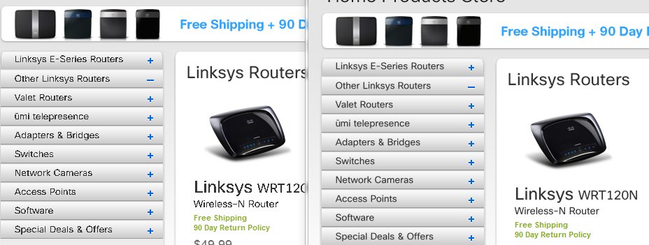

Happy Birthday Dignan
Now that your issue is fixed, Tony, is it okay if I ask about a web font rendering issue as well?
I've noticed that on several sites, Chrome displays a certain type of font poorly in a way that FF and IE do not. I've attached a screenshot of what it looks like in Chrome versus FF. The only site I could remember that does this is some Cisco pages, but I've seen it on others.
Is there a way to fix this for Chrome, my preferred browser?

#344634 - 01/05/2011 14:22 Re: Weird HTML rendering thing - Cyrillic characters... Please help. [Re: tfabris]
Haha, sorry, I thought you weren't using this thread anymore and that I could use it for a while wink
I hadn't noticed, but I think you're right about the antialiasing. Why would that happen, though? Is it something I'd be able to fix on my end?
#344635 - 01/05/2011 14:32 Re: Weird HTML rendering thing - Cyrillic characters... Please help. [Re: Dignan]
Posts: 31630
I've got no idea, all I know is that when I zoom in on that page it looks like a font where the antialiasing just failed.

#344636 - 01/05/2011 14:41 Re: Weird HTML rendering thing - Cyrillic characters... Please help. [Re: Dignan]
Cisco is using cufon to do font rendering. It looks like there may be a known problem with Chrome and cufon.
