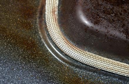

I don't recall ever seeing an oven with a door gasket. They tend to vent directly to the room they're in, so gasketing would be pointless.
My current oven, at least, has no gasket.
I don't recall ever seeing an oven without a door gasket. They'd be very dangerous without them:
Description: Kevlar gasket around inside of oven door.

Step 3 is definitely to double-check the oven gasket. That thing needs to be intact and clean. Working properly, you can have a smoky mess inside the oven and no corresponding smoky mess outside the oven.
