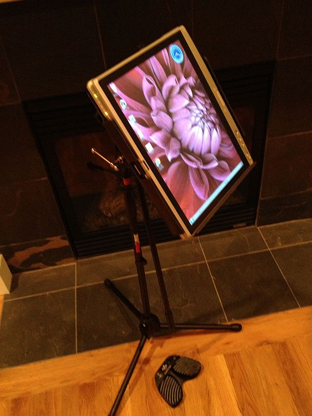

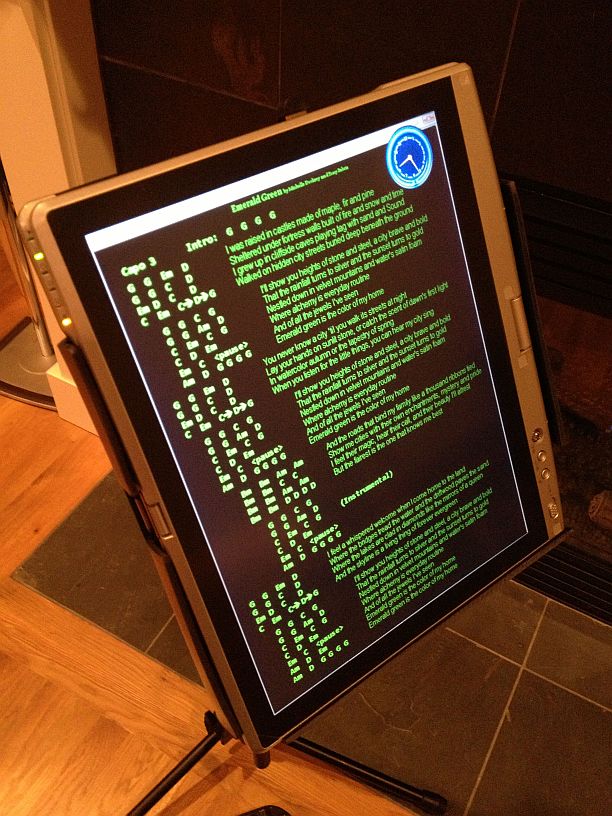

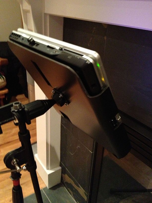

Dignan asked for some up close shots, so, they are attached. Enjoy!
Description: Shot of the entire system including the laptop, mic stand, PVC cradle, and bluetooth page turner pedal.
Description: Close up of the mounting cradle assembly. The PVC sheet is stuff you get at Tap Plastics and heat with a heat gun to shape it. The clamp holding it to the mic stand is cannibalized from an iPad mic stand mount.
Description: The songbook software in action, displaying a song on the screen in green-on-black mode (color options are editable in the software).

Sweet! I love it!
It's a pretty thick laptop, but it seems to be working for you. Very cool solution. I love the pedal page turner...

Yes, I'd love something thinner and lighter, but as this exercise has shown, there isn't anything with those screen dimensions in the thin/light category. That was the root of my problem. smile
The page turner is the PageFlip Cicada and I'm very happy with it so far. Our cellist uses an AirTurn with an iPad running the ForScore software.
