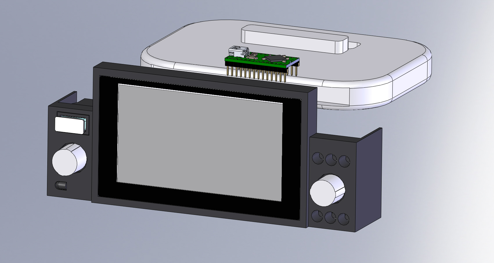

#359259 - 29/07/2013 14:38 Re: Empeg player software, a new generation [Re: Jemmi]
Jemmi
Registered: 03/05/2003
Posts: 131
Here you go... this is the guts. Not done yet packaging it all
Raspberry Pi Radio.JPG (5015 downloads)

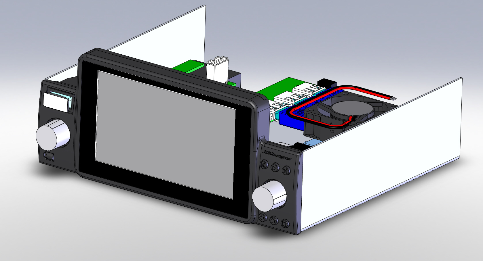

#359319 - 07/08/2013 11:27 Re: Empeg player software, a new generation [Re: jonshouse]
Jemmi
Posts: 131
I do not like the way XBMC handles music. The Squeezebox stuff is the closest I have come to the ease of use of the empeg software. I just finished building the Squeezeplay software for the pi that I intend to use as the front end. I may have a way to launch FM radio from that as well. I looked into it years ago but have to refresh my memory on how to accomplish it.
I pretty much have the faceplate and buttons done. I am using a lot of off the shelf parts and just making them into the cohesive unit. All of the controls will send keystrokes to the pi.
I am having trouble getting the pi and USB hub packaged nicely. I need a lot of right angle USB cables
Raspberry Pi Radio.JPG (14759 downloads)
#359337 - 10/08/2013 21:05 Re: Empeg player software, a new generation [Re: Jemmi]
jonshouse
Registered: 18/09/2012
Posts: 55
Loc: Somerset UK
Interesting, can we see some more :-)
How are you making it, what materials ? Is the enclosure 3d printed ? Any photos of the real hardware ?
Thanks,
Jon
Edited by jonshouse (10/08/2013 21:05)

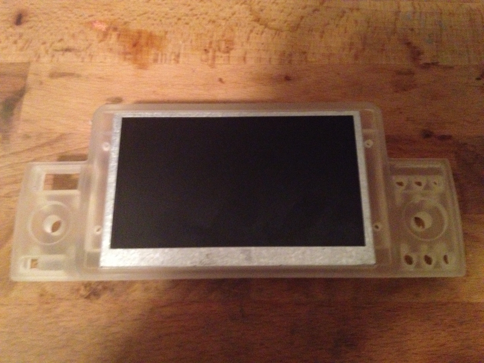

Jemmi
Posts: 131
I 3D printed the faceplate. The housing itself will just be bent sheet metal or aluminum. The things I don't have figured out are the exact mounting of everything within the housing itself. Using a lot of right angle cables currently to make it even remotely packagable.
Here is a pic of the screen mounted in the faceplate before painting. Also a viewable eDrawings file
I just got a working version of the software running it all last week. It is going to be a necessity really to leave the Pi on all the time. The boot time takes less time than bringing up the logitech media server and being able to play locally stored files.
I haven't had time the past week to finish assembling the hardware. The button mounting is causing some issues and would probably be easier if I just made a PCB.
Ok, not bad :-) Should look good painted, gloss black ?
Yes, I do that in my software. The plan in the longer term is to clock the processor at a much lower rate when "powered off" to save some watts. I yet to investigate how to do this.
What I have done in the past is to mark up a bit of PCB material with insulating tape then drop it into the etcher. The insulating tape stops of the etch quite nicely. If you dont have access to a small mill then this can be a good way of making a one off PCB if the detial is very low (IE just some buttons).
Keep ip the good work, please post some updates when its more complete.
