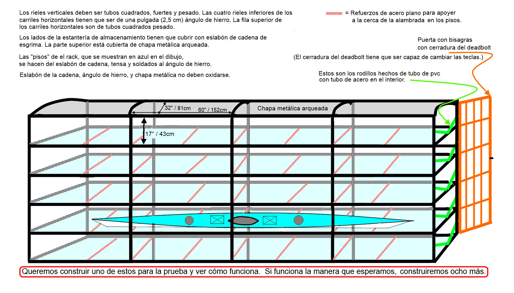

The kayaks we store are 50--70 pounds, 16--18 feet long, and some of them are rotomolded plastic. In the hot sun (frequently >90F [32C], where the boats rest on supporting bars, the plastic boats take on permanent deformations.
Our current racks are made that way, and load from the sides, and over time the supporting bars bend from the weight of the boats, making it difficult to open/close the side of the rack. These racks are awkward to deal with, and I have designed a different sort of rack (see attached, sorry for the español, the picture is for the welding shop) that I think will be much nicer to deal with. With a maximum lift height of 68" as opposed to the current racks' 96" it should be much easier to access the boats, and even though the racks are not as tall we will be able to store 50% more boats in the same footprint.
For those who don't want to try and translate my amateurish Spanish, here is a brief description. The frame is a combination of square tubing (verticals) and angle iron (horizontals). The "floors" of each slot are chain link fencing welded to the angle iron. The top is curved sheet metal, the sides are chain link welded to the frame. Zip-tied to the chain link on the outside will be breathable tarpaulin. I am looking for something to put onto the chain link floors to protect the hulls of the boats.
It can be really cheap stuff. I'm thinking low-quality linoleum, maybe hall runners, or ??. Durability is not much of a factor -- the heaviest use any of it will see is maybe 100 times per year a boat slides over it; most of them only 10 or 15 times a year. Waterproof is an absolute requirement, the boats go into storage right after the wash rack, and the breathable tarps we will use will allow some water to enter if the wind is blowing from the right direction. The boats themselves are reasonably water resistant. smile
I am budgeted at about 21 cents per square foot (30 pesos per square meter) for this material. Nothing made of wood will stand up to our weather. Metal is way too costly. That leaves... ??

Try it now. Looking at your post time, I bet you tried to open it while I was in the process of deleting the old (wrong) picture and putting in the correct one.

I would expect the horizontal chain link material to sag between the horizontal crossbar supports. If not right away, then over time as the hulls slide in and out.
So the bulk of the hull weight would be on the intermediate support bars, not widely distributed on the chain mesh.
If the horizontal bars are omitted and the chain link fencing is installed like a hammock (supported down the long sides) then it would hopefully sag in a controlled manner and evenly support the hull weight along the full length.
Or use some sort of tough fabric to create the hammocks, not fencing. Something that would air dry and not have too much sliding friction.
I just occurred to me that plastic 'construction' fencing might be suitable. See photo...
No, sorry, that's buried in the español description, "...tensa y soldados al ángulo de hierro." The chain link is pulled tight and welded to the horizontal angle-iron rails. The transverse crossbars might not even be necessary, but are there to give additional support and to provide additional rigidity to the structure as a whole.
If you are committed to using tensioned fencing as the support then I suggest the metal crossbars be curved downward in the center or positioned slightly below the level of the mesh so that when the mesh sags the cross bars do not become pressure ridges.
If the cross bars are providing actual load 'support' then the mesh would be not providing evenly distributed support along the kayak length.
I presume the steel structure is to be painted to limit rust. Everywhere there are welds the galvanizing of the fencing mesh will be compromised, and therefore need paint.
Some sort of stubby feet or legs would allow air circulation and reduce rust on the bottom surface of the lowest frame rails.
