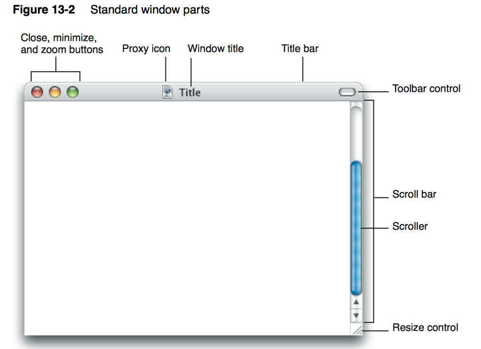

#363376 - 03/02/2015 21:09 Re: Windows programming: What's the resizey grabby thing on the LR corner? [Re: tfabris]
https://developer.apple.com/library/mac/...000957-CH33-SW1
Currently called "Transient resize controls" as OS X has gotten rid of the fixed point to resize a window. Before it was called simply "resize control". This screenshot is from the OS X 10.4 Human Interface Guidelines (HIG).
#363377 - 03/02/2015 21:29 Re: Windows programming: What's the resizey grabby thing on the LR corner? [Re: drakino]
Posts: 31583
Excellent! Now I know what it's called.
Blast, though, that doesn't help me google the second question. Too general of a name.
