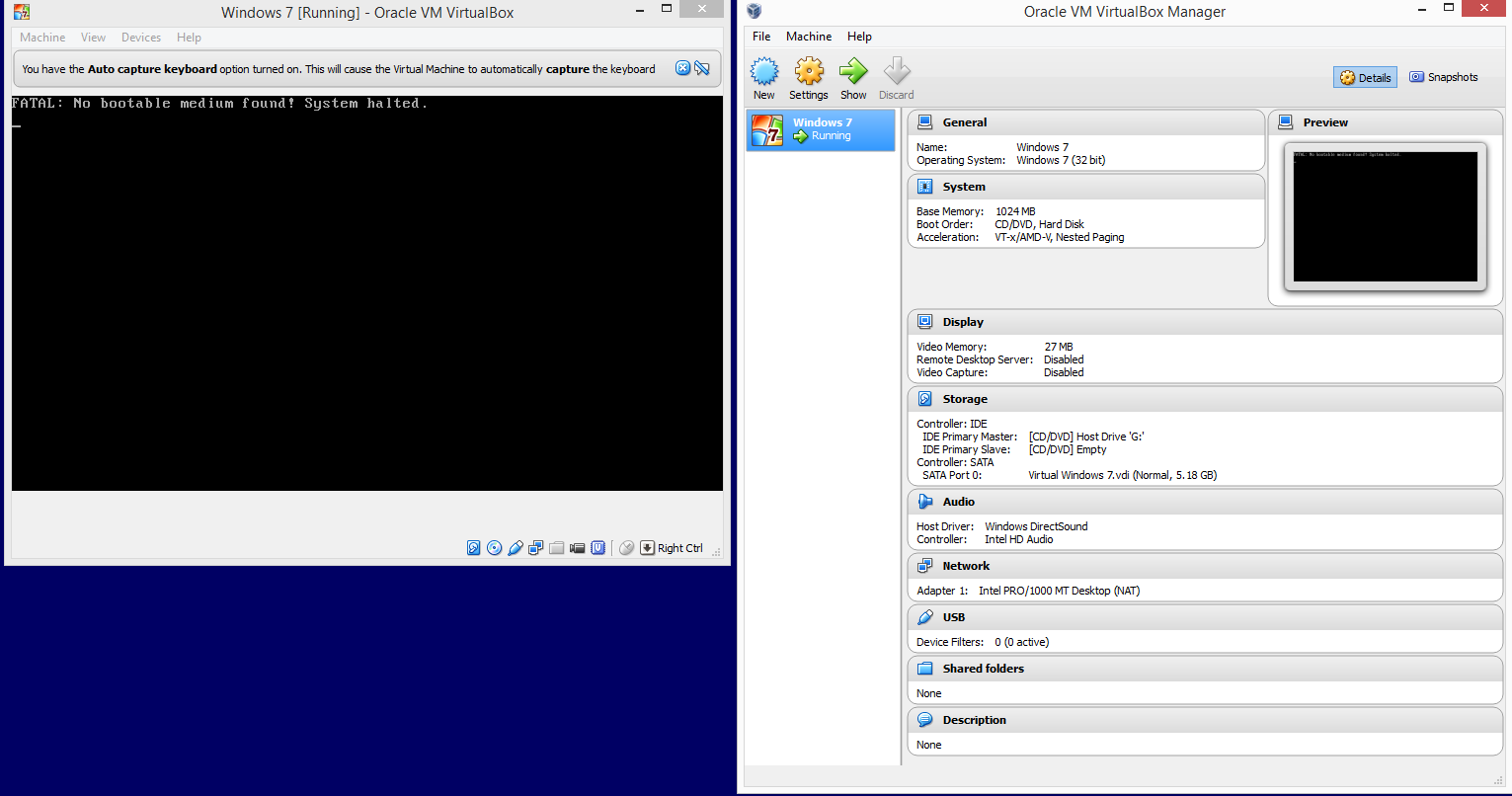

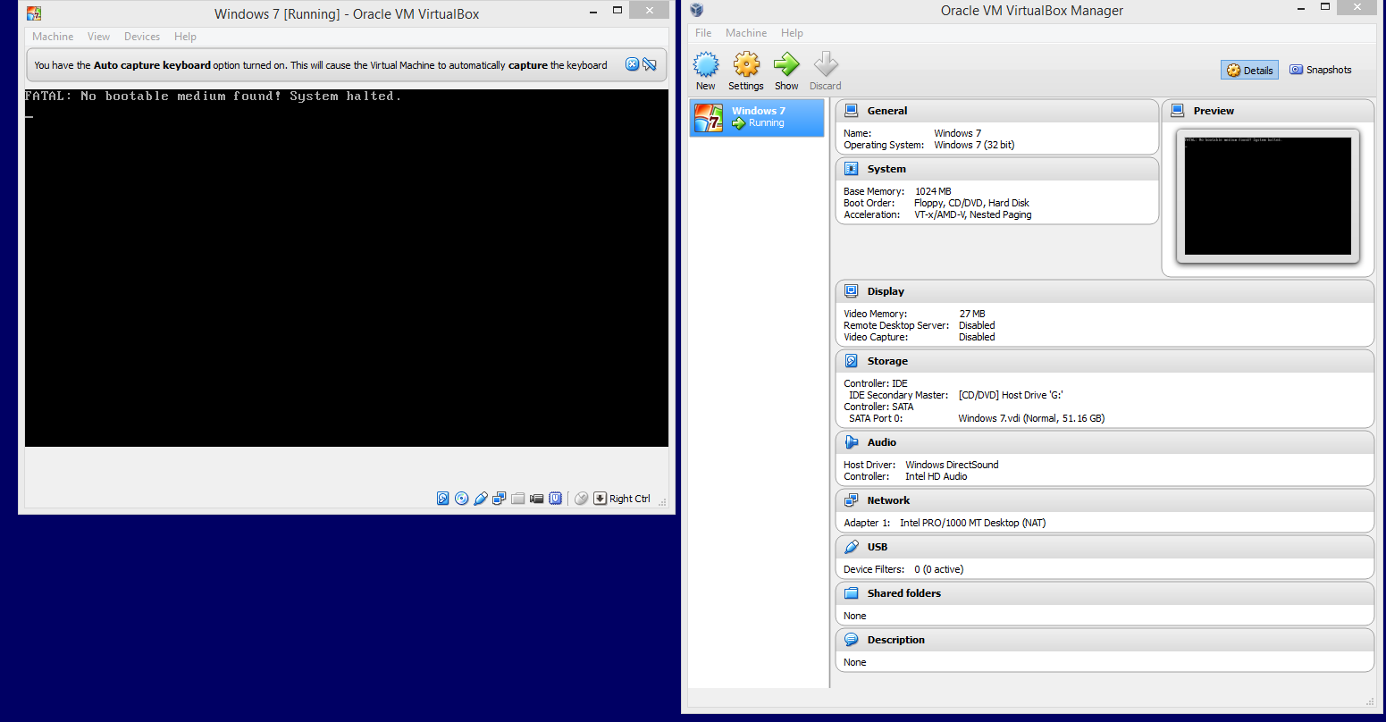

Well, as it turns out, apparently I discarded my old Vista installation disks last year after I purchased the new computer with Windows 8.1.
So, I have acquired a Windows 7 installation disk of questionable provenance. If I double-click it in Windows Explorer, it displays an installation screen that would apparently install Windows 7. However, VirtualBox tells me there is "No bootable medium found, system halted." (see screenshot)
In the root directory of the Windows 7 disk there are subdirectories: BOOT, EFI, SOURCES, SUPPORT, and UPGRADE. Additionally, there are files: AUTORUN.INF, BOOTMGR, AND SETUP.EXE.
#364021 - 21/05/2015 02:30 Re: Setting up a Vista/Windows 8.1 dual boot system [Re: tanstaafl.]
Posts: 31630
You need to configure VirtualBox to see the CD drive as if it were its own.
Virtual machines don't always connect to the resources on your actual computer unless you tell them to. A few of them it does, for example I think the LAN connection is one that VirtualBox enables by default, but otherwise, things like USB devices and CD-ROM drives, by default it doesn't connect to them until you explicitly tell it to do so.
In your screen shot, where it says "Storage", I only see the virtual hard disk, not the CD-ROM drive. That's probably the issue.
Somewhere in the VirtualBox configuration will be a place for it to configure its virtual CD-ROM drive. It will be named something like "Devices" or something like that. And you will select some menu or button with a name similar to "Add Device" or somesuch. Once you've done that and selected that you want to add a CD-ROM to the virtual machine, then, there will be some kind of a choice where you get to choose what to put INTO that CD-ROM drive. You can choose to:
- Tell it to look at an ISO image file, and pretend the contents of that ISO image file are its CD-ROM drive. (an ISO image is like a single-file rip of an entire CD in one file on the hard disk.)
- Or, tell it to look at the computer's actual CD-ROM drive and use that as its CD-ROM drive.
In your case, you want the latter, since, you don't have an ISO image file of that CD, you have the actual CD.
I'm not sure, but also I seem to recall that if you want to use the CD drive in your real operating system (windows 8) then you have to disconnect/deconfigure the virtual machine using it. (The guest OS and the host OS can't use it at the same time). I could be wrong about that part, though, maybe they'll work together just fine.
#364022 - 21/05/2015 02:39 Re: Setting up a Vista/Windows 8.1 dual boot system [Re: tfabris]
Posts: 31630
By the way, if you DO have the CD-rom properly configured in VirtualBox, but it won't boot from your CD, there are a few possibilities:
- The pirated CD you've got might be crap, and wasn't made to be bootable. Bootable CDs have to be made in a special way to be bootable. If the pirates didn't do that step when they pirated the CD, then that's your problem.

OK, I did all that, results are still the same. frown
Attached is a screen shot with the new configuration. I had to delete and reinstall the VirtualBox program before it would let me get to the part about "...click the little button that looks like a CD with a "+" on it...", everything was pretty much greyed out before I reinstalled.

From the screen shot, it looks like you've correctly configured the CD drive, and the boot order seems correct.
Assuming that you didn't miss the "press any key to boot from CD/DVD" message on the virtual machine (DOUBLE CHECK THAT), then it's my guess that this is your actual problem now (from my earlier post):

You mention changing the BIOS and it still boots Windows 8.1? So that's the main PC's BIOS? The Virtual machine has its own separate BIOS access that runs after powering on the VM. The VM really is a complete PC inside a program so has all the bits a non-virtual machine has - just most are done in software. Completely separate to the main BIOS.
Virtual Box has the boot order set in Settings->System->Motherboard. Move the CD/DVD-ROM to the top. Leave it and the hard disk checked. It should be that way already though.
Like this:
http://en.kioskea.net/faq/40841-virtualbox-how-to-change-the-boot-order-of-a-guest-os
Also I would remove the extra CD/DVD-ROM you have installed to prevent confusion. Not the G one.
This should be done with VM not running (off)
You shouldn't be rebooting the whole machine each time. Just reboot the VM. Your screen shot indicates you've got as far as booting the machine but you talk about booting 8.1 which doesn't make sense. If you just mean to try out the disc, some Windows 8 machines won't boot from the CD very easily I think due to some Windows 8 secure boot stuff (UEFI).
If still no go, I'd be looking at a new install disc or downloading a genuine ISO. Can you download ~3GB?
Edited by Shonky (24/05/2015 12:49)
#364048 - 24/05/2015 12:56 Re: Setting up a Vista/Windows 8.1 dual boot system [Re: tanstaafl.]
Ah I missed the boot order in the screenshot. You have that right then. New disk or ISO if you ask me.
