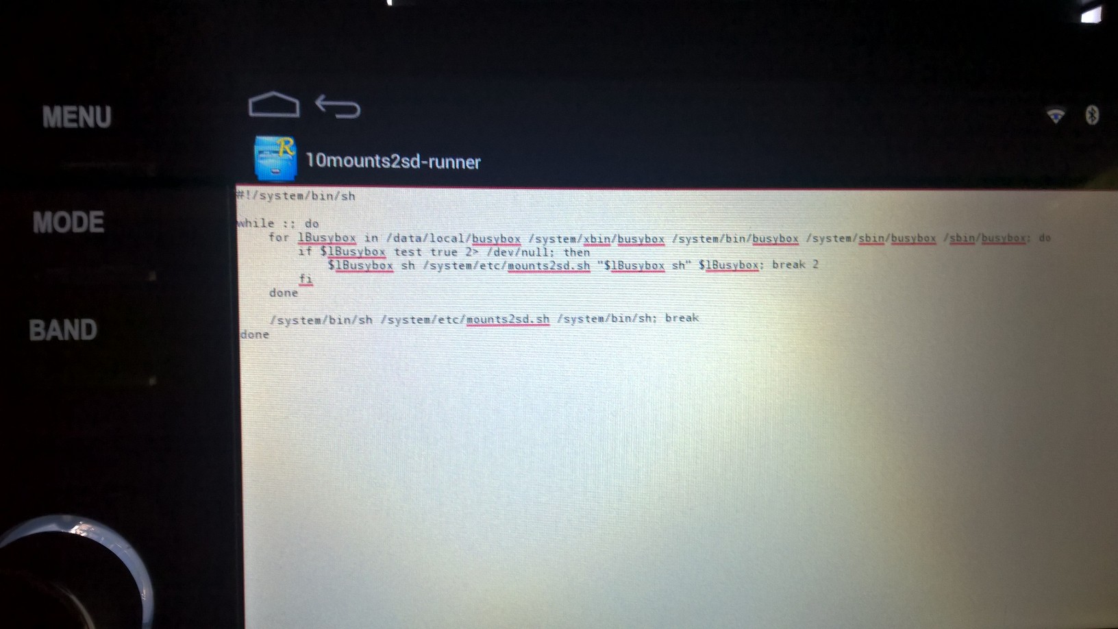

#364367 - 05/07/2015 15:31 Re: Android infotainment system storage question [Re: Taym]
I think so.
Mount2sd placed in /etc/init.d the script 10mounts2sd-runner.
I am attaching a screenshot of what it does. In int, I saw a reference to a mount2sd.sh located in /system/etc , which I also guess was created by the app. I am attaching that too.
mounts2sd.sh (142 downloads)
#364369 - 06/07/2015 01:38 Re: Android infotainment system storage question [Re: Taym]
Posts: 14488
Gag. What the heck is that script doing in 1575 lines of code???
This is really a two liner:
#!/system/bin/sh
mount /dev/mmcblk1p2 /data
Maybe save the original script and replace it with the above two lines?
EDIT: Wait: not sure about the exact path.
The script uses _mount for everything, whereas the standard (Linux) command is mount (no underscore). Get it wrong, and your phone might not boot.
Researching..

One more question, guys.
Let's suppose I start the unit with a different microSD, not containing the ext3 partition (mmcblk1p2) referred to in the boot script.
This is the case when I have to plug the microSD in containing just the firmware upgrade. In fact that's just how the unit works: start the system upgrade process and it will look for the firmware img files in that microSD slot.
Now, what happens? The boot script is run and... ? Mount will fail and I am back to the original /data? Or, will the system hang?
