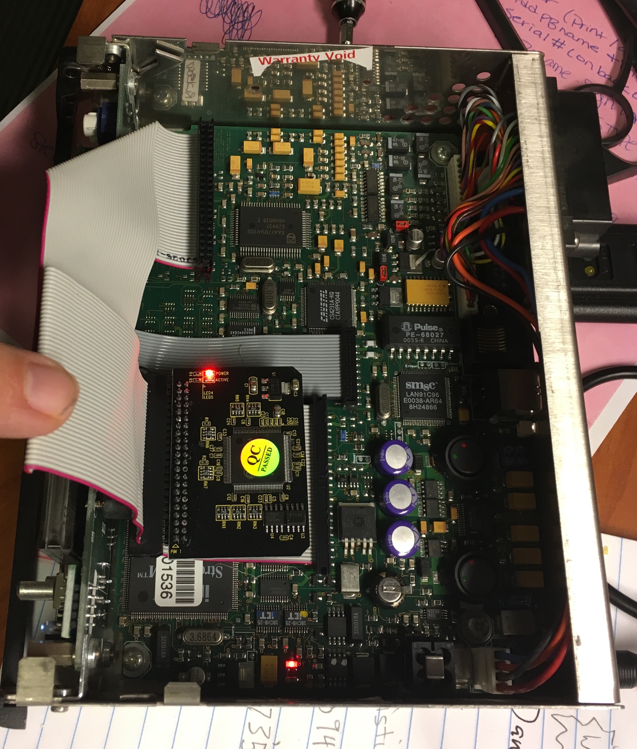

#372008 - 25/05/2019 03:44 Re: Replacement SSD? [Re: mlord]
By all means please DO report your findings, along with the exact card used in
So mixed results so far. I installed the little converter and SD card (the card is on the bottom side of the board):
I'm able to run the big disk builder upgrade file, then the player 2.01 upgrade file. After that I can copy music to the drive and play it. Everything is good up to this point. The only problem is that the moment I pull the power, I lose the ability to connect to the SD card. The player says No Hard Disk Found, Contact Support. This seems bizarre, because it was happily playing music seconds before. I've duplicated this behavior with both the 32gb card, and an old 1gb card I had laying around. Seems consistent with what some are reporting in the Amazon comments. I'm wondering if it's just not handling a non-windows filesystem very well?
#372009 - 25/05/2019 03:53 Re: Replacement SSD? [Re: Roger]

ide_data_test: wrote 0x5555 read 0x0000
hda: SINTECHI HighSpeed SD to CF Adapter V1., ATA DISK drive
ide_data_test: wrote 0x0000 read 0x0000
ide_data_test: wrote 0xffff read 0x0000
ide_data_test: wrote 0xaaaa read 0x0000
ide0 at 0x000-0x007,0x038 on irq 6
hda: SINTECHI HighSpeed SD to CF Adapter V1., 29664MB w/8kB Cache, CHS=60269/16/
63
empeg-flash driver initialized
smc chip id/revision 0x3349
smc9194.c:v0.12 03/06/96 by Erik Stahlman ([email protected])
SMC9194: SMC91C94(r:9) at 0x4008000 IRQ:7 INTF:TP MEM:6144b MAC 00:02:d7:22:06:0
0
Partition check:
hda: hda1
RAMDISK: ext2 filesystem found at block 0
RAMDISK: Loading 320 blocks [1 disk] into ram disk... done.
EXT2-fs warning: checktime reached, running e2fsck is recommended
VFS: Mounted root (ext2 filesystem).
empeg-pump v0.03 (19980601)
Press Ctrl-A to enter pump...attempt to access beyond end of device
03:05: rw=0, want=2, limit=0
dev 03:05 blksize=1024 blocknr=1 sector=2 size=1024 count=1
EXT2-fs: unable to read superblock
Kernel panic: VFS: Unable to mount root fs on 03:05

Interesting. It's as if nothing was ever written to the card during the various install steps. Or perhaps a counterfeit card that has (much) less capacity than advertised, resulting in sector "wrap around" which then destroyed the partition table.
Except you got it with more than one card. So probably not the card.
EDIT: The above boot log is from AFTER installing everything, right?
Edited by mlord (25/05/2019 11:18)
#372011 - 25/05/2019 11:31 Re: Replacement SSD? [Re: Roger]
Posts: 14549
I have read through some of the Amazon reviews for various versions of this adapter, and the common theme seems to be that the partition table gets rewritten to the SD-Card at power on. Always with exactly one MS-DOS partition populated.
The interesting question then becomes, is the rest of the SD-Card still intact? If so, we could kludge a reasonably simple work-around in Hijack to just ignore the read-in partition table, and instead use either a saved copy or an auto-generated table (partition tables are only 512-bytes long, plus whatever "extended" partitions exist).
I suppose the onboard firmware might be doing something stupid like, "if card isn't something I recognize, then auto-format it at power-on". In which case it's a matter of determining how it "recognizes" the card. Most likely it just looks at the partition table. If that's the case, then we just tell Hijack to offset everything by 1 sector, nothing else required. smile
If you want to try this, I can provide a suitably hacked kernel, builder image, and car2-software image with that kernel.
Edited by mlord (25/05/2019 11:31)

Ha! There is already a mechanism to do this kind of thing in the IDE driver in Linux. I added it decades ago to deal with "EZDRIVE" partitioning software that did something similarly silly with the partition table.
So a possible workaround here simply involves enabling that code, and checking for the specific brand/model of SD Card converter. Done. Try this (attached).
Note that this is safe (aka "inactive") for use with regular drives too.
EDIT: Replaced builder+image with a single combined builder image.
builder_bigdisk_v6+-sdcard.upgrade (539 downloads)
Description: Single combined builder/software file.
Edited by mlord (25/05/2019 18:32)

Kernel code change to enable the (possible) workaround:
--- v524/drivers/block/ide-probe.c      2009-09-14 08:39:40.000000000 -0400
+++ hijack-v524+/drivers/block/ide-probe.c      2019-05-25 07:47:10.952063665 -0400
@@ -86,6 +86,20 @@
        printk("%s: %s, ", drive->name, id->model);
        drive->present = 1;
+#if FAKE_FDISK_FOR_EZDRIVE
+        * Try and deal with SD-Card adapters that rewrite an MS-DOS partition table
+        * at every power-on, by remapping sector 0 to 1.
+       static const char sintech[] = "SINTECHI HighSpeed SD to CF Adapter";
+       if (0 == strncmp(id->model, sintech, strlen(sintech))) {
+               drive->remap_0_to_1 = 1;
+               printk("[sdcard remap 0->1] ");
+#endif
 #ifndef CONFIG_SA1100_EMPEG
         * Check for an ATAPI device
--- v524/drivers/block/ide.h    2017-08-06 08:36:18.000000000 -0400
+++ hijack-v524+/drivers/block/ide.h    2019-05-25 07:45:06.083976833 -0400
@@ -41,7 +41,7 @@
 #define INITIAL_MULT_COUNT     8
 #define SUPPORT_SLOW_DATA_PORTS        0
 #define SUPPORT_VLB_SYNC       0
-#define FAKE_FDISK_FOR_EZDRIVE 0
+#define FAKE_FDISK_FOR_EZDRIVE 1
 #define FANCY_STATUS_DUMPS     0
 #define REALLY_FAST_IO         1
 #undef  INITIAL_MULT_COUNT
#372017 - 25/05/2019 18:28 Re: Replacement SSD? [Re: JBjorgen]
Posts: 14549
I've got another engagement this morning, but I'll try it later today.
If you do try it, (re-)download the builder image from my earlier post:
I have updated it to a single image that builds the drive
AND installs v2.01 software in one step.
Just reboot the player once it shows "Done!" on the front panel display.
#372018 - 25/05/2019 23:08 Re: Replacement SSD? [Re: mlord]
Posts: 14549
Note that the combined builder image is a Work In Progress. I will release a more polished version at some point, likely at The Meet.
