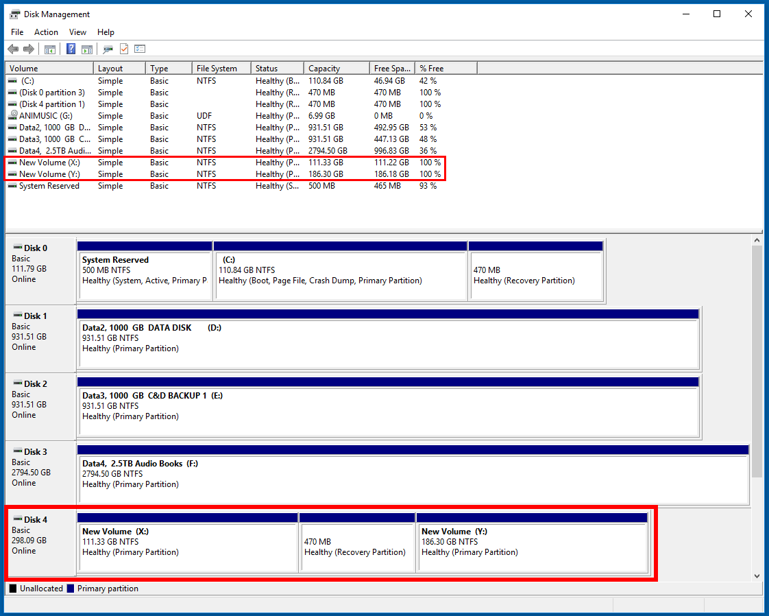

Below is a screenshot of Windows 10 Disk Management, showing all the partitions in the computer. Disk 4 is the clone destination, with the two partitions and the Recovery partition.
1) What is the 470 MB Recovery Partition partition on the system drive (Disk 0)? I notice the same thing on Disk 4.
2) What is the System Reserved partition on the system drive?
3) If I decide to get red of the "Y" partition and extend the "X" partition to use the former "Y" space... how would I do that?
To the bet of my knowledge, I have no partition management tools other than what is provided in Windows 10.

The recovery partition would have been created by a windows installer.
Possibly you installed windows onto the 111.33GB X: partition once. Usually it puts the recovery partition after the install partition like on Disk 0 which is has your boot partition.
If Disk 4 was just (re)added then that recovery partiion is fair game to delete.
To consolidate X: Y: and the Disk 4 recovery, just right click on each one and select "Delete Volume". That would be the easiest way. You technically could delete Y: and Recovery and then extend X: (with extra tools) but the easiest way if it's empty is to just delete them all and create one new big one. If X: or Y: has files on it you need to keep, just move them off to one of your other devices temporarily. Once they're all deleted, just right click on the empty space to create a new volume.
The system reserved partiion is something to do with Windows and/or may be a factory install partition on a name brand computer like a Dell or somilar.

Christian, I had already tried that. When I delete either of those partitions, they turn into "Unallocated Space", and if I then right-click that, there is no option to delete. If I try to extend the X partition, it won't let me extend past the original 111 GB and the other two partitions just sit there.
But I've changed my mind, I want to keep both X and Y partitions as they are. Because...

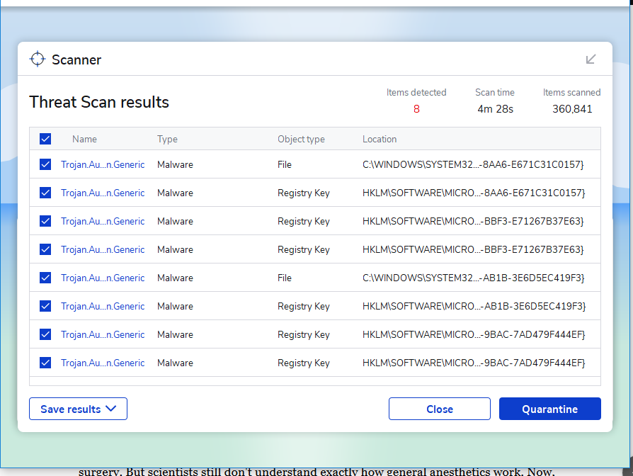

MalwareBytes finds and quarantines four items each time I run it -- and they immediately reappear and get quarantined again even if I run the MalwareBytes program back to back. (see the picture below, the results of three scans run today)
It has been suggested that the malware is using my computer to mine for bitcoins. This would fit the symptoms. Gmail and YouTube are hardest hit. I can stream a video, but it might take 30-40 seconds to load and begin playing. Gmail is virtually unusable. Even the empeg bbs is difficult, sometimes the screen will freeze but continue to store keystrokes in some buffer and then catch up with the typing 10 seconds later. Similar things happen with MS-Word and Excel.

The Unallocated space is what you want. You delete all 3 partitions and they will join in to one big contiguous space. Then right click and create new volume.
Most "decent" malware will resurrect itself and have multiple copies hence the 4 copies of the same file you found. If you delete one, it just gets restored from one of the others.

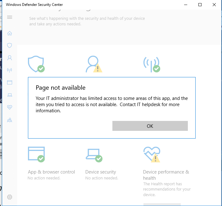

Whatever this is, it is absolutely hard-wired to prevent my Gmail from uploading an attachment. I was a little bit surprised that it let me attach this:

It's somewhat unlikely it's directly/intentionally preventing you sending an attachment via Gmail (i.e. uploading a file through a web browser).
It's quite possible it's set some registry entries/group policies to prevent you running the offline scan.
Try safe mode if you can.

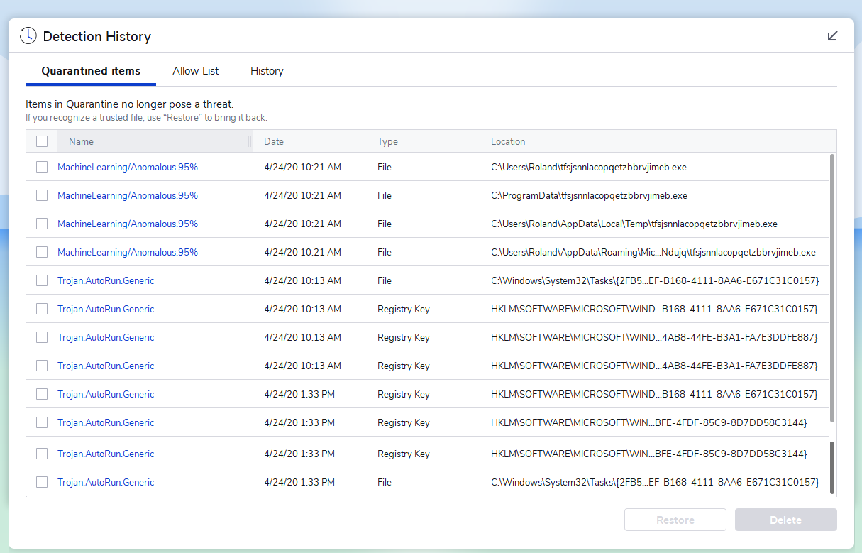

The first picture is a screenshot at 9:30 this morning, showing the results of the two previous scans. The same four files and registry keys as usual, one from the scheduled 2:20am scan, and the other from the 9:30am manual scan.

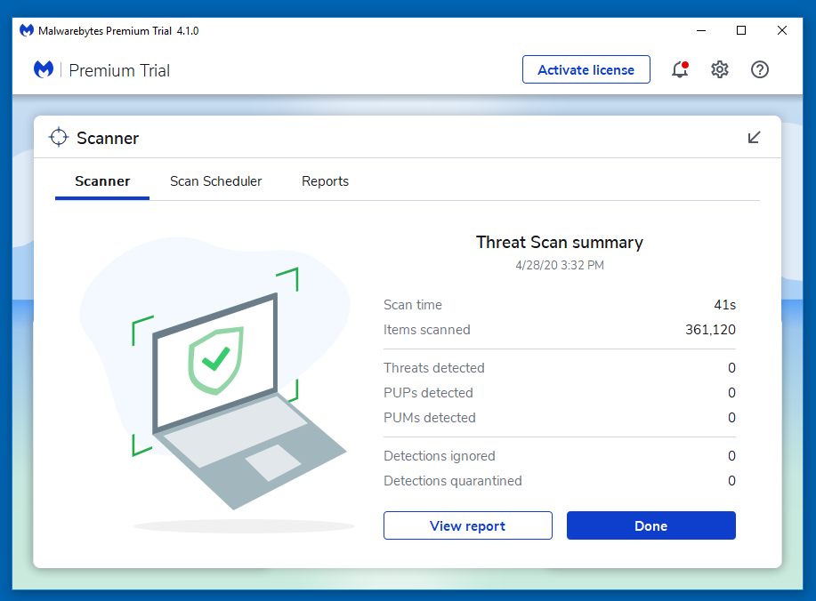

The second picture is for a scan I just made because I was suspicious, the computer suddenly seemed to be running better than it had been. I had done nothing but look at my favorite porn uhh, information sites on YouTube and I was impressed at how much worse the situation had become than even my Henny Penny the Sky Is Falling rants had predicted.
What could account for this turnaround? Will it be permanent? Do I need to do anything other than give myself a dope slap for being so careless in the first place?
First thing I am doing is cloning my (hopefully clean) system drive!

I'd do a full scan in Windows Defender again. Maybe something you've done has killed it enough and prevented it from reinstalling itself. If you're still getting the registry keys in particular then it's still installing itself again and therefore not completely gone.
Have you looked at the actual file it's installed in "C:\windows\system32...". It appears it's creating new folders with a new GUID each time (GUID is the globally unique identifier - basically a big random hex number) with the file in them. The file name probably changes each time too.

In your case I would believe the positive hits before I believed the negative hits like your second screenshot.
