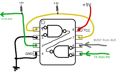

#373926 - 30/10/2022 21:43 Re: What is it? (chip) [Re: mlord]
Posts: 14505
So, wired like this. The input signals are 3.3V logic, and the chip outputs 5V logic.
#373927 - 30/10/2022 22:00 Re: What is it? (chip) [Re: mlord]
Posts: 14505
I'm guessing at something like a Dual 2-input NAND gate, with open-drain outputs: https://assets.nexperia.com/documents/data-sheet/74LVC2G38.pdf
Just need to identify the exact part.

#373930 - 03/11/2022 13:12 Re: What is it? (chip) [Re: mlord]
Posts: 14505
The HD74LV2GT125AUS doesn't match the pin-out unfortunately, but a 74LVC2G38 does match and is probably the part.
As it turns out, the failure was in another chip just upstream of of it. A teensy tiny 8-pin + GND chip about the size of a grain of sand. Turned out to be a 4ch ESD protection device, which makes sense -- it failed and protected the rest!
Thanks all!
