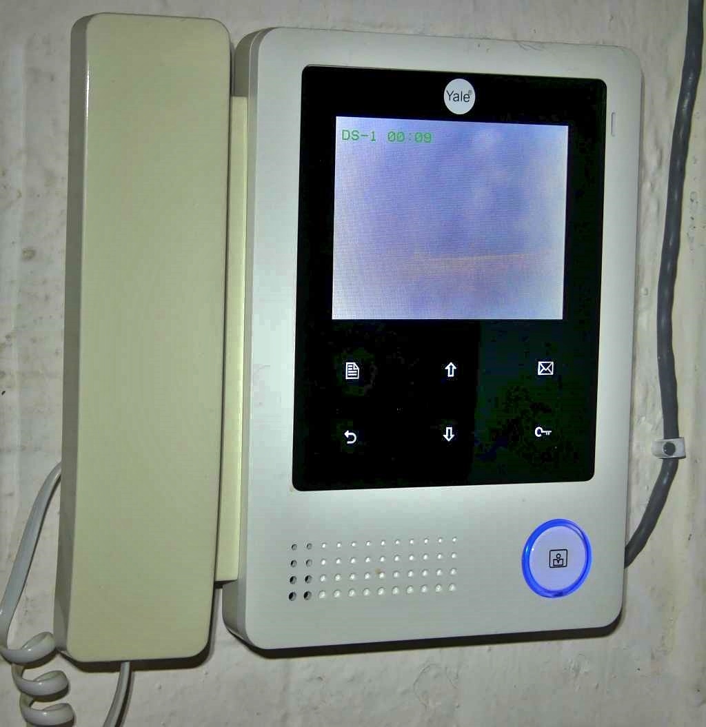

The doorbell just completes a circuit that delivers power to a solenoid that then hits a metal bar to make the chime.
I think the "chimes" are not mechanical, but electronically produced. The box on the wall contains a small video screen, a button that initiates the camera, a button that trips a solenoid to unlatch the door, a telephone handset that enables two-way audio, and what looks like a small speaker grill.
Power and communications all enter the box through the cable on the right. The other end of the cable disappears into the masonry wall, and ends up at the camera/speaker/ring button, and splits off to the door unlatch solenoid.
Somewhere along the way it gets house current, but I don't know where. There are several possibilities, including a motion sensing light that is independent of the doorbell system and the security cameras, power to the garage door opener, garage lighting, whatever.
I have watched the doorbell delay through the security camera (not the doorbell camera, this is a separate eight-camera system) and the delay is not a fixed duration. I have seen it as short as two seconds, as long as eight seconds. The dogs hear it the instant it is pressed. In fact, tonight I discovered that my pressing the button on the wall unit that activates the camera sets them off.
These days, when the dogs go off, I just look at the security camera to see whether I want to bother with the door at all. By that time, the dogs have already told me that the doorbell is going to ring.

I think this might be the manual for this system:
https://www.manualslib.com/manual/628858/2easy-Dt24.html
It appears to be a generic item that gets rebranded with a bunch of different company names. This might be a picture of its innards.
#374376 - 20/05/2024 18:32 Re: Doorbell Question [Re: tfabris]
Posts: 31628
They might be triggering off the fact that you personally are interacting with the system. But if that's not the case, if they are triggering off of some sound that the system makes, then here is my guess:
If these photos are indeed a picture of the innards of the same system, then, the circuit board prominently features a JRC-27F 012-S(555) relay on the board (spec sheet here). The dogs are hearing that relay click. Perhaps they even hear a high frequency whine associated with the power circuit, something that is outside of your hearing frequency range. (Edit: Perhaps it is the high frequency coil whine of that relay!)
Why the system doesn't play the chime for 2-8 seconds after the button is pressed? Don't know. One idea is that maybe the relay is associated with that timing, and the relay is being old and sticky.

Ok. If this manual is the correct one, then, page 3 shows the connection pinouts on the back. If you lift it off the wall you should get access to the connections.
My guess is, what you want to try, is unplugging the SW+ SW- "door bell call button connection" plug first. Then try shorting those two pins yourself locally there. Does shorting those pins ring the chime immediately, or does it have a delay?
If it's immediate, then the "delay" issue is in the doorbell button itself or the wiring somehow. If it's delayed, then the issue is in the electronics box of the DT24 unit itself.
This doesn't SOLVE the problem but it certainly narrows it down.
While you're there, you can test for sure whether the chime rings when the pins are first shorted, or when the pins get unshorted (i.e, whether the chime is buttondown or buttonup). If the chime rings on buttonup, then your delay problem could be that the doorbell button itself is sticky (or its contacts are sticky, or there's a weak short somewhere in the wire run, perhaps the wire is submerged or rat-chewed somewhere, causing a capacitive buildup somewhere along the wire run).
