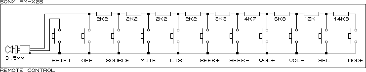

Alrighty.
So I'm using the Autoleads PC99-X46 Lead in my Mazda with the PC99-SON Sony adapter. Thats hooked up to my PCATS tuner and Empeg running firmware v2.0 and Hijack v479. The steering wheel on my car has buttons Up, Down, Menu, Mute, Vol+ and Vol-
As standard, the buttons do absolutely nothing.
I added stalk_debug=1 to my hijack config and looked for serial output while pressing buttons. BOTH Up and Down buttons give
Stalk: in=02 00 ff ff == no button
and all the other buttons do nothing. Not ideal.
So I broke out a multimeter and tried measuring the resistance on the plug of the Autoleads part when pressing buttons. I've established that all the buttons do 'work' in that they do change restistance values. Its hard to measure the Up, Down, Menu, Mute button values because I have a digital multimeter which doesn't react fast enough when you press the button. The Autoleads adapter only seems to send a pulse on those. Holding down Vol+ and Vol- works great and I can get an accurate reading on them. I end up with something like this:
  • Up: ~12.00 (maybe?) kΩ
  • Down: ~14.30 kΩ
  • Menu: ~11.00 kΩ
  • Mute: ~34.00 kΩ
  • Vol+: 17.66 kΩ
  • Vol-: 21.98 kΩ
Okay, I'm not sure what to do now. By the looks of things, the stalk interface on the tuner should be able to look out for those values, they seem to be in range of what the Sony stalk uses (2.2-48.4kΩ), just off here and there.
Anyone got any ideas?

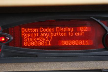

Originally Posted By: sein
Mark, is it possible to have the stalk debug output to the screen? Either on the 'view button codes' or a new 'view stalk codes' section of Hijack.
"View button codes" should already show the stalk controller resistances on the screen. If it doesn't, they're probably out of range of the comparison resistor.
#305760 - 05/01/2008 12:27 Re: Troubleshooting Autoleads Stalk Adapter [Re: Roger]
Oh right... My Up and Down buttons give me that FF message on the console, but not on the 'View button codes' screen (IIRC, will double check in a minute, just going to the car). Something is not right.
#305761 - 05/01/2008 13:24 Re: Troubleshooting Autoleads Stalk Adapter [Re: sein]
Definitely don't get any output at all from View button codes in Hijack right now.

#305766 - 05/01/2008 15:19 Re: Troubleshooting Autoleads Stalk Adapter [Re: sein]
Posts: 14483
Well, the saga continues. I was in the car late last night taking things apart (again) and found some important facts. The Up and Down arrows on the wheel gave me "Stalk: in=02 00 ff ff == no button" on the serial port and with my multimeter I found that these are actually shifted buttons (i.e. they show continuity between the middle ring (B) and the ring closest to the plug (A) as well as a resistance value between the tip (C) and A.
The connector has three conductors, which I will call tip, ring, and collar, in order from the pointy end of the plug back towards the plastic housing and wire leads.
The tip is for the buttons, ring is for the "shift" function, and the collar is common to all.
Edited by mlord (05/01/2008 15:22)

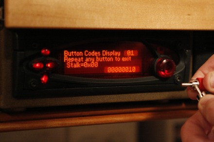

Perhaps you've simply been trying with the microphone input, rather than the stalk input? The connectors appear rather similar.
EDIT: I just now hunted down the dock here with a PCATS tuner inside, and tried the same tip-to-collar test there. FAILED. Then I tried what I thought was the MIC input, and.. behold.. it lives!
That thin grey coax of the stalk input *really* suggests a MIC input to me!
Edited by mlord (05/01/2008 21:35)

#305796 - 06/01/2008 12:10 Re: Troubleshooting Autoleads Stalk Adapter [Re: mlord]
Okay, I'm not going crazy smile
Right, well I've been out in the car again just to try that test once more to be sure. Shorting out the collar and tip of the stalk remote connector does not give me any output at all on the Button Codes Display or serial console with the debug options enabled. I've checked the wiring of the stalk remote line, and its okay. The cable is not broken either, all the traces are fine and its all connected the right way with no crossed wires as per the tuner assembly guide PDF.
With trace_tuner and stalk_debug both enabled on my player, shorting the cables for the ring and the collar (Shift) gives me the following on the console:
tuner: in=02
tuner: in=01
tuner: in=ff
tuner: in=00
stalk: in=0201ff00
tuner: in=02
tuner: in=00
tuner: in=ff
tuner: in=ff
stalk: in=0200ffff
It gives me nothing on the Hijack Button Codes display.
I've attached the dmesg output from my Empeg in the car, but don't see anything broken in there really.
Yeah, 0xff is the *only* stalk report that Hijack does NOT show on the front panel, because it means "button released"
So what you got was a 0x00 "button pressed (but bad checksum)", followed by a "button released".
Mmm.. a correction on that. I misread the packets. The checksum is likely passing just fine after all. The button value isn't 0x00, but rather 0xff on both packets. So it really is invalid, and quite likely a circuit issue in the tuner.
I wonder if the in-car stalk somehow damaged the tuner's stalk input? We already know there's more in there than just a resistor array (because most buttons generate a pulse, rather than just a continuous level).
