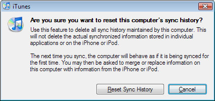

Okay, I think I might know what happened.
At some point when I was trying to clean up disk space in my user profile, I pressed the button on the iTunes which said "RESET SYNCH HISTORY" because I thought it would clean up space in the user profile.
But now that I look at that button, it also says:
#329435 - 28/01/2010 19:27 Re: iTunes trouble- it wants to erase my iPhone and I can't make it st [Re: tfabris]
Posts: 31578
Maybe that's why it's so adamant about erasing the ipod? It says something to that effect.

Posts: 5914
I have used the reset sync history before on my manually managed iPhone and it didn't insist on deleting my music on the next sync. So it can't be quite that simple.
