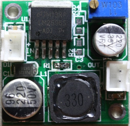

In the end I've gone with a buck regulator found on eBay for $1.70. The chip on it is rated for up to 40V input, tolerating 45V absolute maximum. I tuned the module to give 5.00V output (needed for the relay coils), and further regulate that down to 3.3V (LDO tab regulator) to run the electronics.
This all works fine, but I'm very slightly concerned about something. The DC input produced from the "24VAC" supply ends up being about 38V after the filter cap. That's under 40V, but not by much at all.
To give a little more head room, I've inserted three diodes in series with the 38VDC, dropping it to about 36.8V (gotta double check that measurement). The current flow through it is typically less than 100mA, up to 225mA peak when all five relay coils are active.
The slightly nagging worry is that there's still not much margin there at the input to the buck regulator. It does appear to be of good quality -- 50V input cap, 35V output cap, etc.
Should I be concerned (much)? I wonder if a 40V zener across the DC input might be useful?

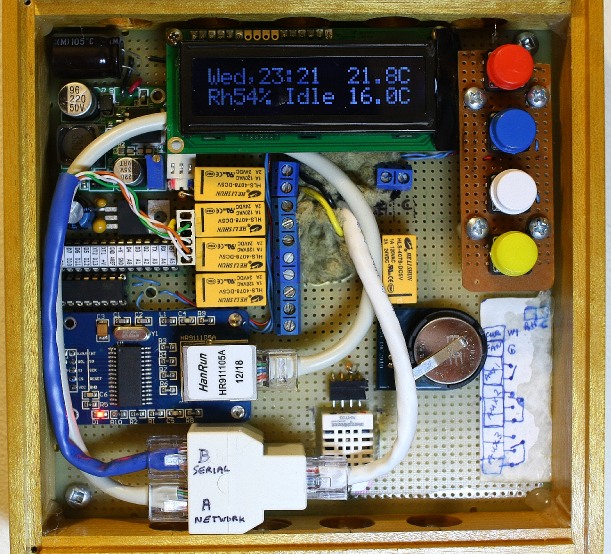

Buck regulator near top left, 3.3V PSU under it, then the Atmega328P microcontroller, and the ULN2003A relay driver chip. The ethernet board connects via SPI, and enables an embedded webserver for status and configuration. The battery-backed Real-Time Clock is on I2C off to the right. Below/between them is the white DHT22 Temperature/Humidity sensor, which uses a proprietary 1-Wire 40-bit protocol. There are five yellow coloured relays, two of which are dedicated for the furnace and fan, the other three are for future expansion. The 3.3V serial port and ethernet share a single run of Cat5e via the special 4w/4w splitter block. The 3.3V LCD display connects via a single wire (tx) serial interface, and the four coloured push-button switches all share a single GPIO using a resistor ladder. Dagnabbit! Forgot to wire in a reset switch. Which means I'll probably need one.
Description: Buck regulator at top left.
