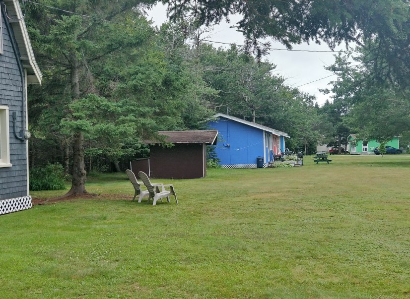

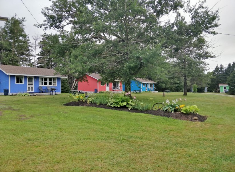

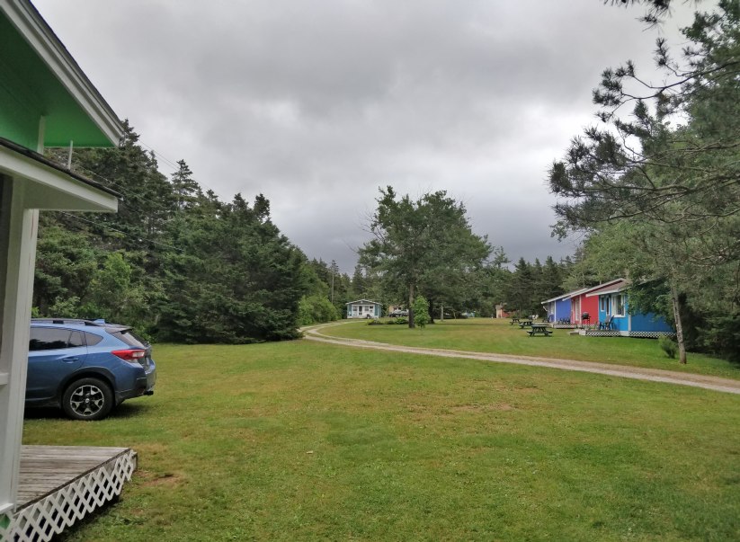

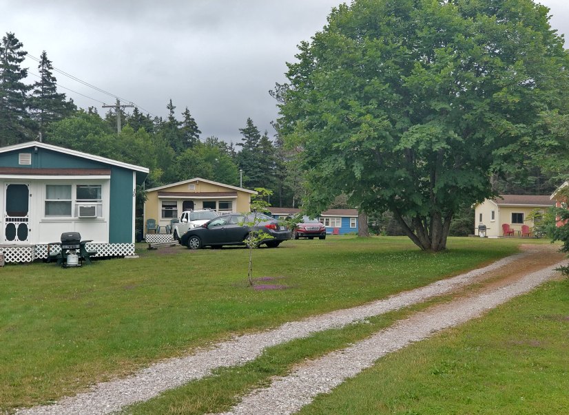

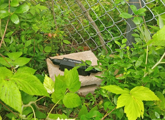

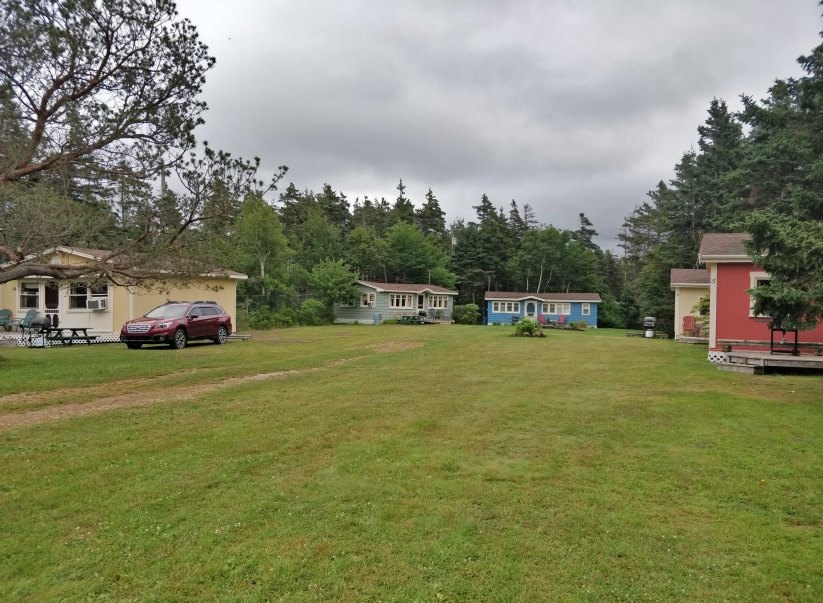

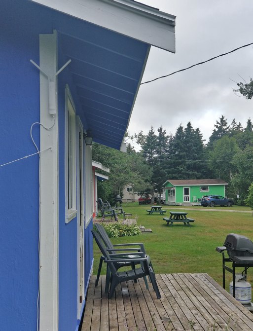

It all went well. The PoE extender got installed near the midpoint of the 220m run from the main router out to the far end of the property, and the Access Point (AP) out there is perfectly happy, serving five of the 12 cottages, and covering most of the property.
We moved the second ethernet run just a bit further, about 120m from the router, and the second AP is happily providing very fast speeds across the middle of the property, and covering most of it.
There were a couple of slow zones though, due to the placement of cottages (walls) and trees, so those got boosted with a third AP at the entrance end of the field. For various reasons it was decided not to run ethernet to the third AP, so instead it is simply meshing with the second (midway) AP, with an 866mbit/sec airlink from it!
Every room in every cottage has at least 30mbit/sec results on SpeedTest, and most of them are between 50mbit and 800mbit/sec. The internet source is 1gbit (both ways) Fibre at the office/entrance.
Everything working and happy. Rain in the forecast for later in the week, so we'll reassess and make antenna tweaks should the need arise. Uploading some photos here for general amusement!
Description: View down to the far end from my cottage.
Description: Ethernet Extender along the left edge of the field/fence.
Description: A lot more cottages at the far end, mostly served from the 220m run to the yellow cottage.
Description: The AP is on the right-hand corner of that yellow cottage.
Description: Looking back down towards the entrance area. Second AP is on the blue cottage, third mesh AP is on the distant lime green one.
Description: Another view of the middle cottages.. AP #2 at near left corner of the Blue one.
#373392 - 20/07/2021 14:05 Re: Ethernet extender? [Re: mlord]
Posts: 14482
More Pix.
Description: The middle AP #2, showing view down to the fully wireless/mesh AP #3 at left edge of the (my) lime green cottage.
Description: Enough tech for now.. beach time!

I didn't measure the longest one exactly, but from the cable markings plus a guesstimate for the final patch cable, it is about 210m. Extender is at the 94m mark (according to the PoE switch), so perhaps 116m after that.
The other run is actually 143m long, and we only noticed this morning that it is connecting at 100mbit instead of 1000mbit. Otherwise working fine and error free. Will be inserting an extender onto that one when it arrives on Saturday, to give it the full gbit connection.
Even with the 100mbit "limitation", here in my cottage we connect via the wireless repeater, up field about 200' to the 100mbit node, and from there back to the PoE switch, a second switch, the router/firewall, and then the fibre-ethernet bridge. speedtest.net is showing pings at 7ms, jitter 3ms. Very Good, in other words. Downlink is 60-75mbit/sec, uplink is closer to 100mbit.

It rained. A LOT. smile
And.. the long 220m run stopped working. Completely.
Today we pulled the cable segments out of the bushes for inspection. Racoons had chewed the cabling in two places, exposing conductors, and probably surprising the heck out of the racoons (24/48V on the tongue?).
Cut away the damaged bits, added inline couplers, and taped it all up again. A-OK for now. My buddy is thinking about how to protect it better (burying is not an option for various excuses).
Edited by mlord (23/07/2021 20:13)
#373403 - 23/07/2021 17:24 Re: Ethernet extender? [Re: mlord]
Posts: 31571
They supposedly make cable sheaths infused with stuff that mammals don't like to chew. Dunno if they work or not.
