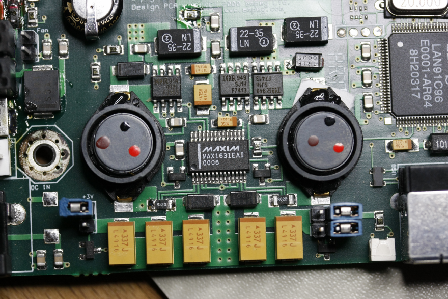

Well, being the sort of person that I am, I decided not to wait for the Digikey and Maxim shipments later this week. I actually have another not-completely-dead player around -- a Mk2a -- and so I pinched one of the IRF7413s from that, to use along with the likely-good one (infinite resistance) from the dead Mk2.
The player now powers up and works perfectly!
So I guess the Maxim chip is more robust than I thought.
Once the Digikey shipment arrives tomorrow, I'll put one of it's new IRF7413s back onto the Mk2a board, to restore its former not-quite-dead status. It's useful for debugging and tracing circuitry.

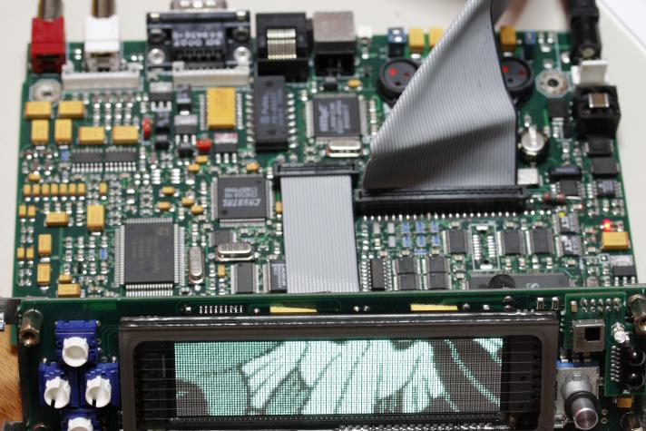

The photo below shows the working Mk2.
And the a.png link shows the relevant PSU components, for reference.

Just updating one of my external diaries here now. The Mk2 unit pictured/repaired above ("ruppy"), now sports a new rotary encoder, and a full button/knob LED illumination job. Looks rather smart!
