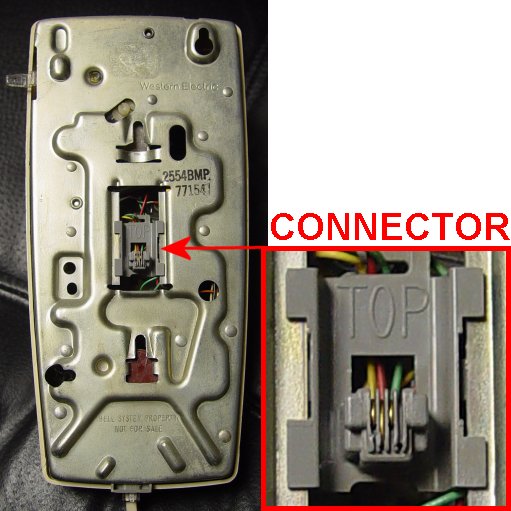

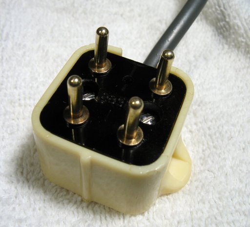

FWIW, there's no such standard, de facto or otherwise, in the UK that I know of. I thought there wasn't and that that was the source of Trevor's (apparent) confusion, which is why I gave that diatribe. Also, I was wrong about it being the Trimline. It was the 2554. This might actually have been the beginning of the RJ-style connectors for telephones. Before this in the US, we had large square four-prong connectors, assuming they weren't hard-wired. Found some good pictures:
Description: Wall plate/jack Description: Phone backplate showing sliding connector Description: 4-prong plug. About an inch square.
Edited by wfaulk (19/11/2008 17:37)

And you can see an additional jack on the side of that plate. They were actually in existence before then for multi-line circuits, although no terribly common.
Also, the sliding plug thing that you see on that phone is basically never seen anymore. It's almost always connected via a several-inch cable now.
